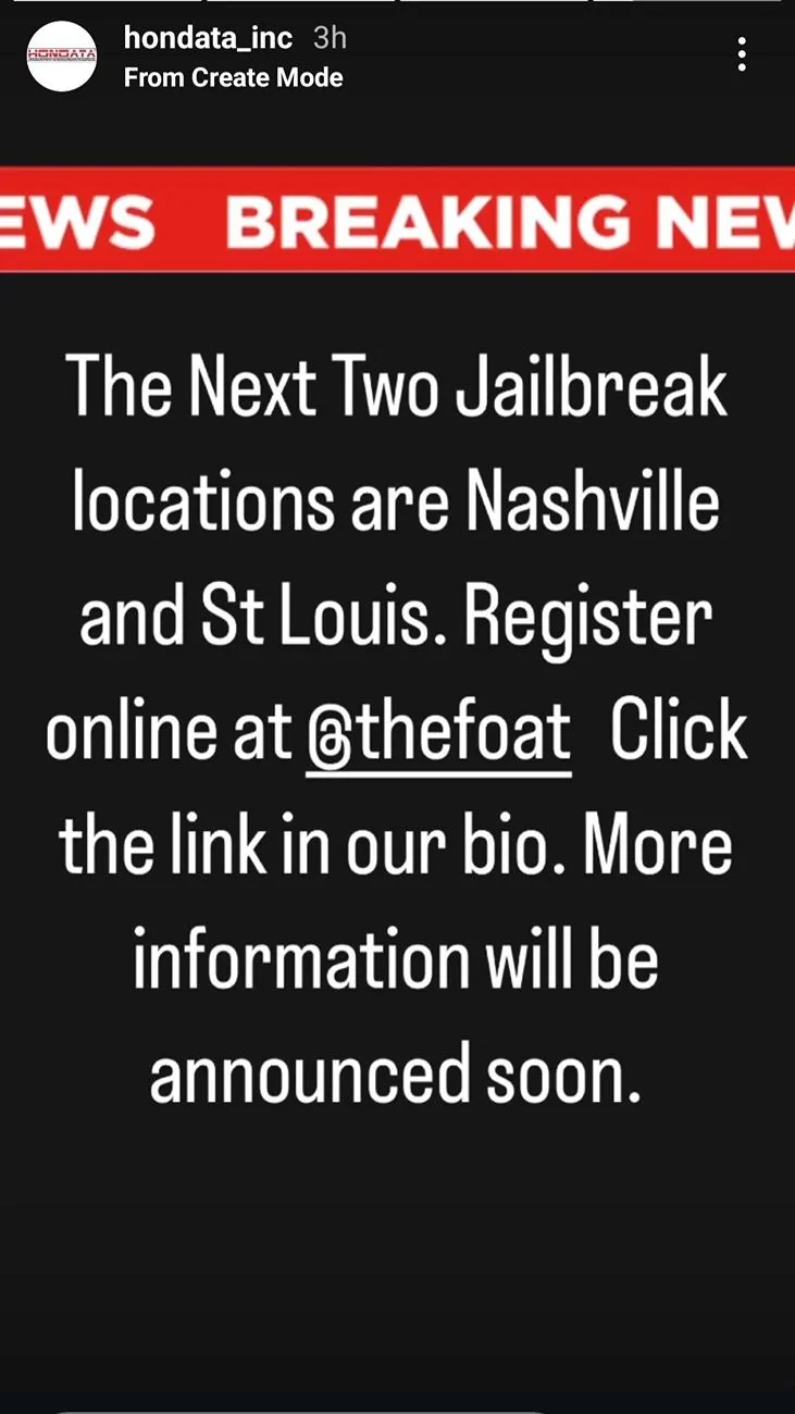

  • The inability to unlock the ECU without removing it from your vehicle is one drawback. Unless you attend a Hondata Jailbreak Tour event you will either need to ship your ECU to Hondata to have it unlocked on a bench and they return it to you, or drive to a tuner who has this capability like IMW.
If any of these considerations are of concern, it's best to pass. I've used Hondata in the past (not on this platform), and had a positive experience. I also shipped the ECU out, no issues. Doug has been at this for over 20 years and Hondata has a good name. This is not a fly by night or pop up operation. I've also had tunes on other platforms and same, no issues. Don't be the guy who hops on the forums butthurt when Honda won't warranty the snapped connecting rod of your Stage II tuned car. Just know what you're in for and align your expectations with reality and you shouldn't have an issue. This is probably more than you bargained for in a response. Anyhow, good luck!
