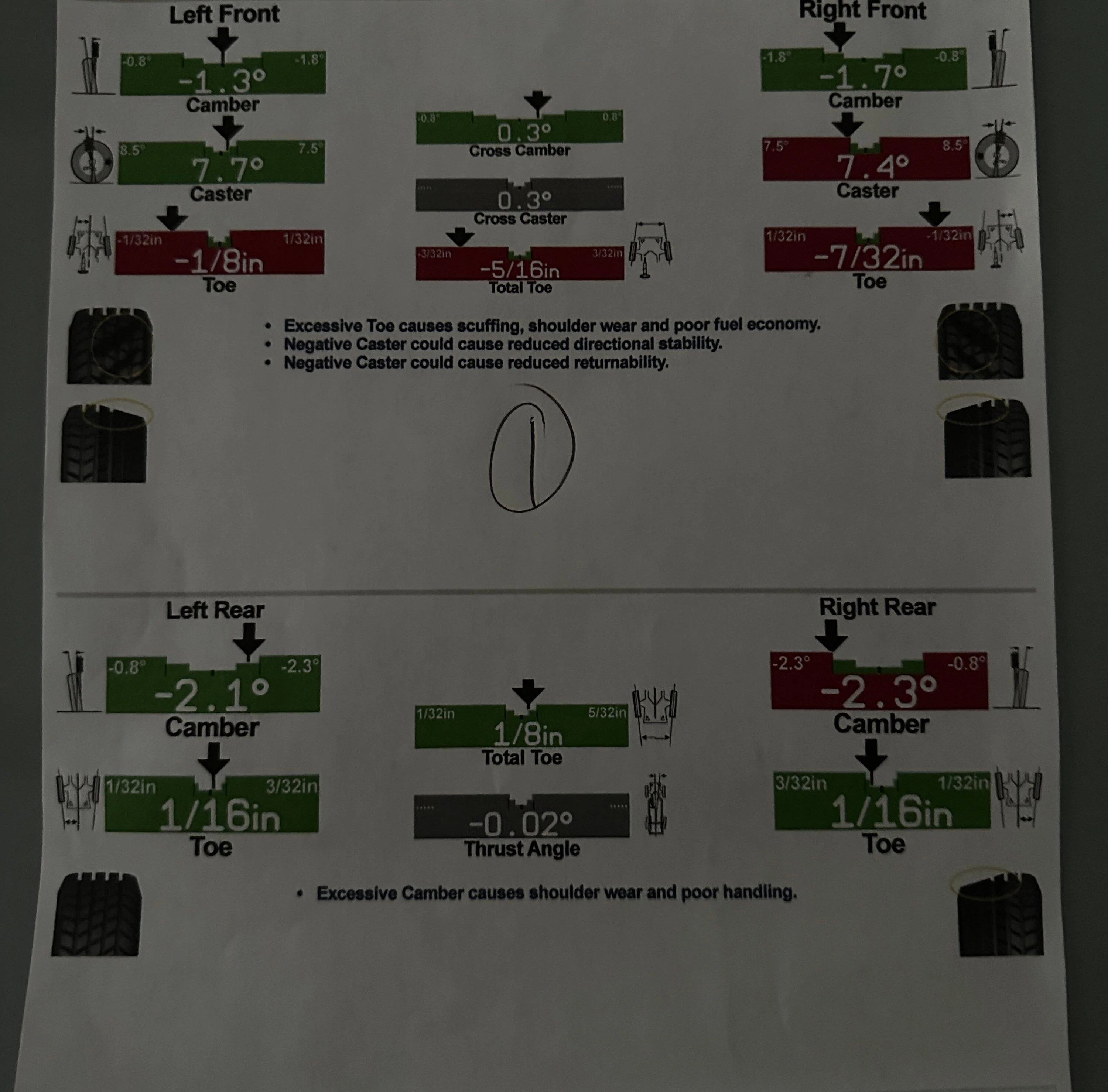

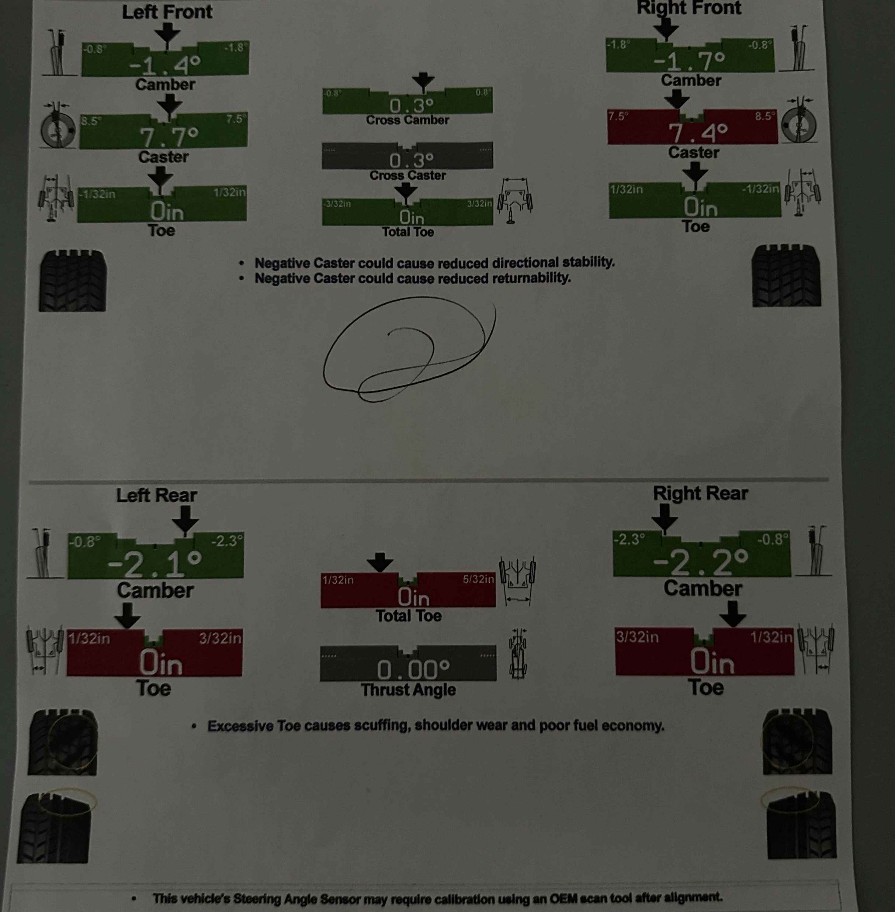

Took the car for a alignment after a month of having the springs installed. Will need some camber plates or ball joint camber adjustment to correct some of the discrepancies. But the car feels a lot better with quicker initial turn in and adjusted for better rotation around corners.
Before
11th Gen Honda Civic Jester’s FL5 build journal. IMG_2649
After
11th Gen Honda Civic Jester’s FL5 build journal. IMG_2650

The ball joints won't really solve the 0.3° discrepancy on the front end as they are a stepped design (ie. the shims only allow you to go from 0, -1°, and -2° and nothing in between).
Removing the strut pins however will enable to you move the struts 0.3° either way. But an even better solution is shifting the front subframe over to the left a touch, or installing rigid collars should get you even front camber. I suspect the front subframe is little biased over to the right in your case.

I have been researching this and will likely do the rigid collars and do the adjustable top hats for the stock shocks so I have all the adjustability I could possibly need. Also need a bigger sway bar for the rear. But all of that will have to wait.?
Need to save back up such a shame lol.
