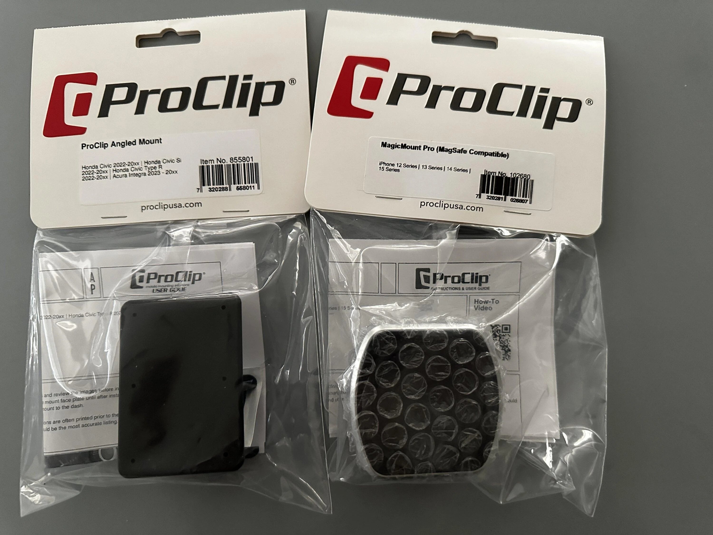

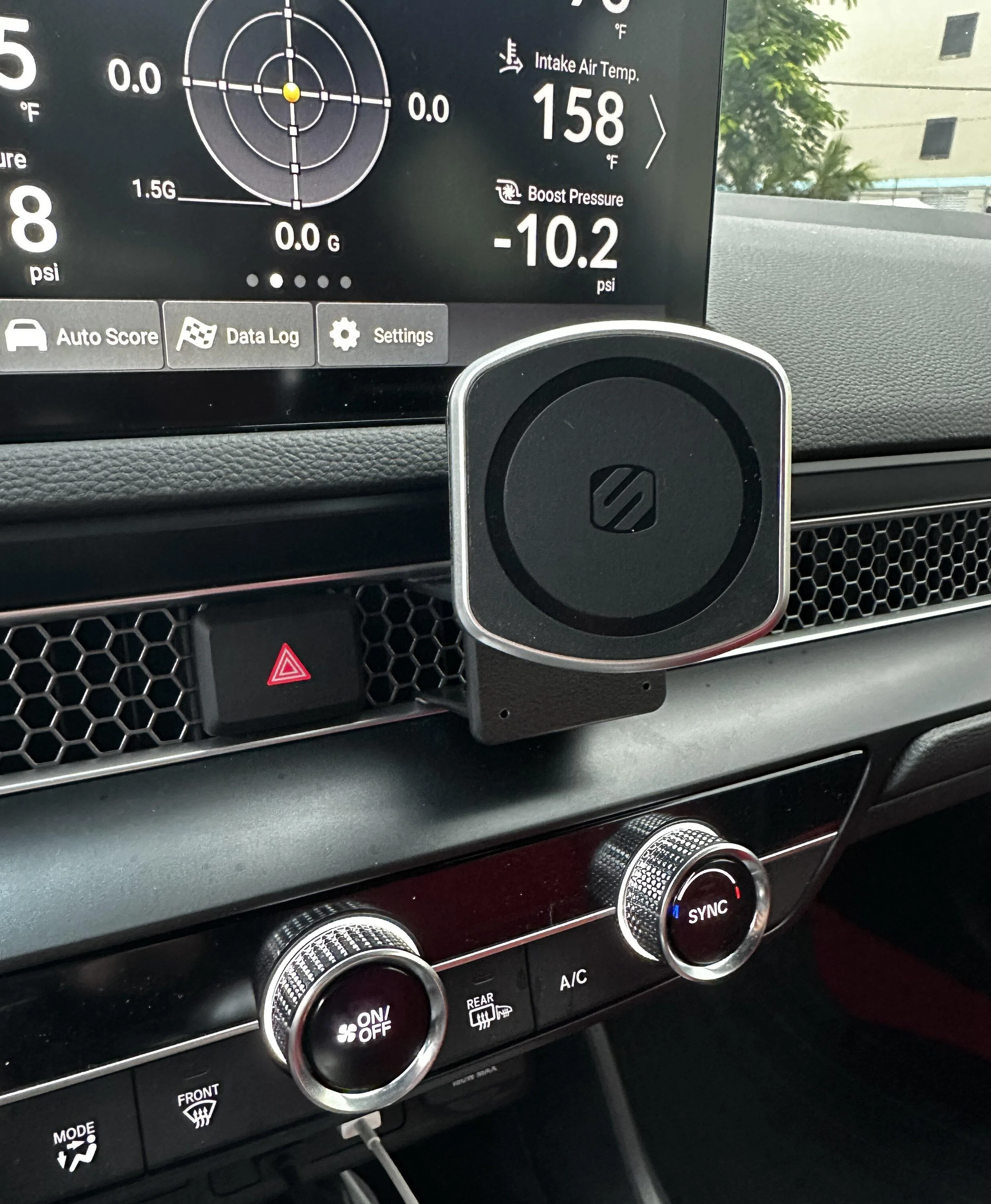

So was trying to figure out a way to log the car without having my laptop with me. So I downloaded the Hondata app and got a mounting solution for the phone. Now I can monitor everything on the fly everytime I’m on the car to make sure its all perfect.

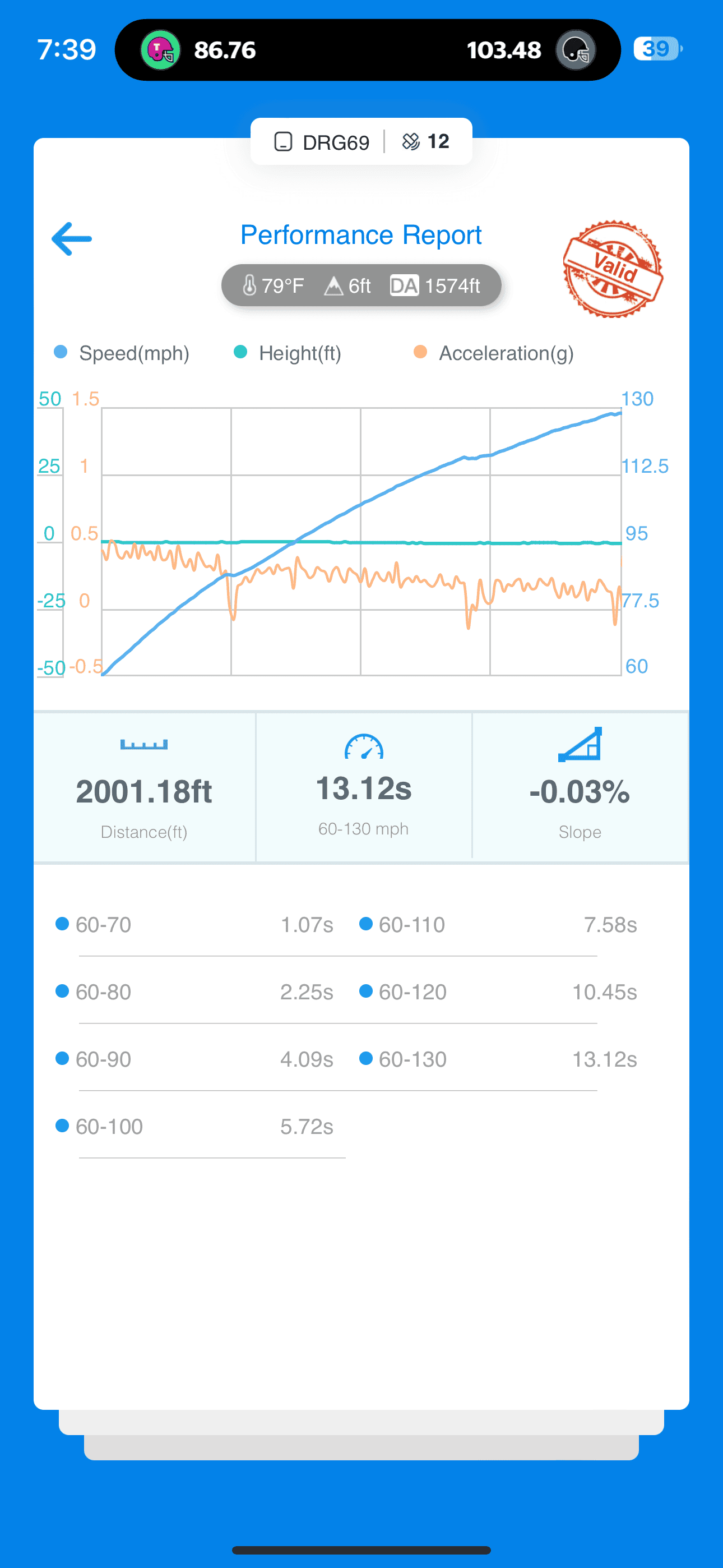

this is a bolt on car in florida, I am 270 and I had parts in the trunk coming back from the install. car mite be a little quicker now as I was just driving home from the installl when I did the pull and it was .2 quicker
vs the pull prior to this one

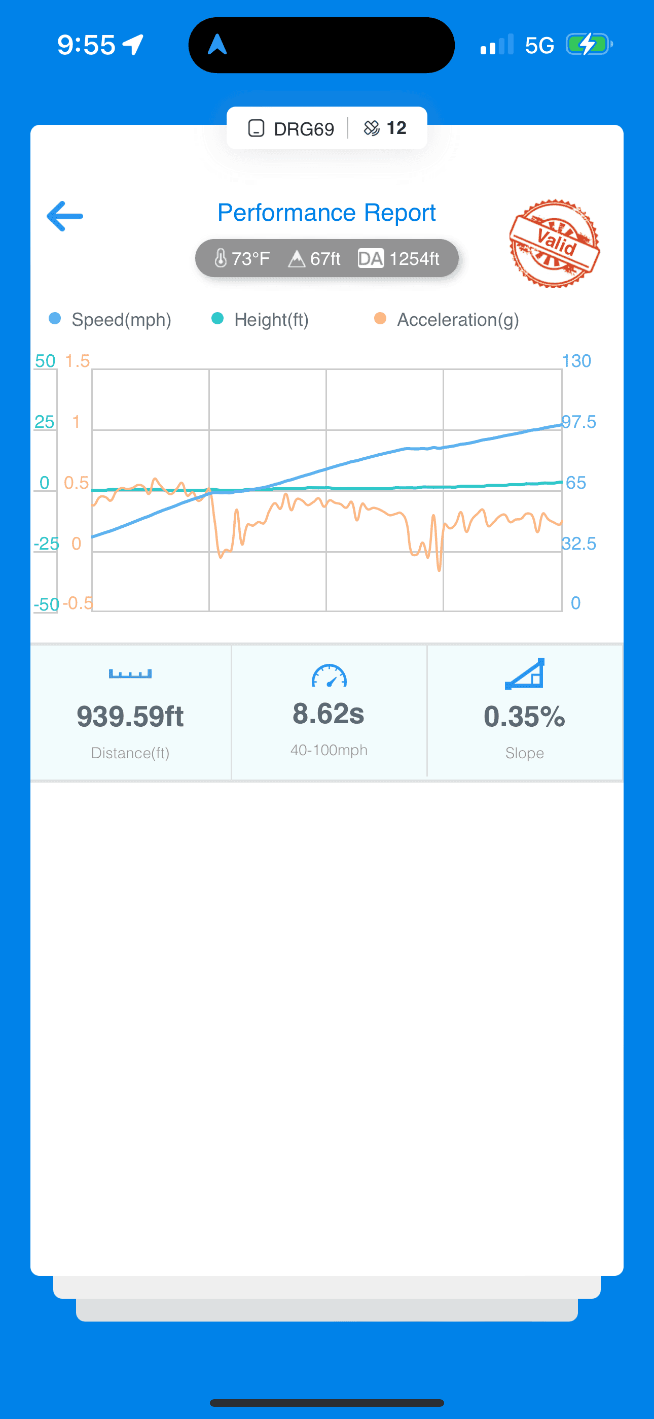

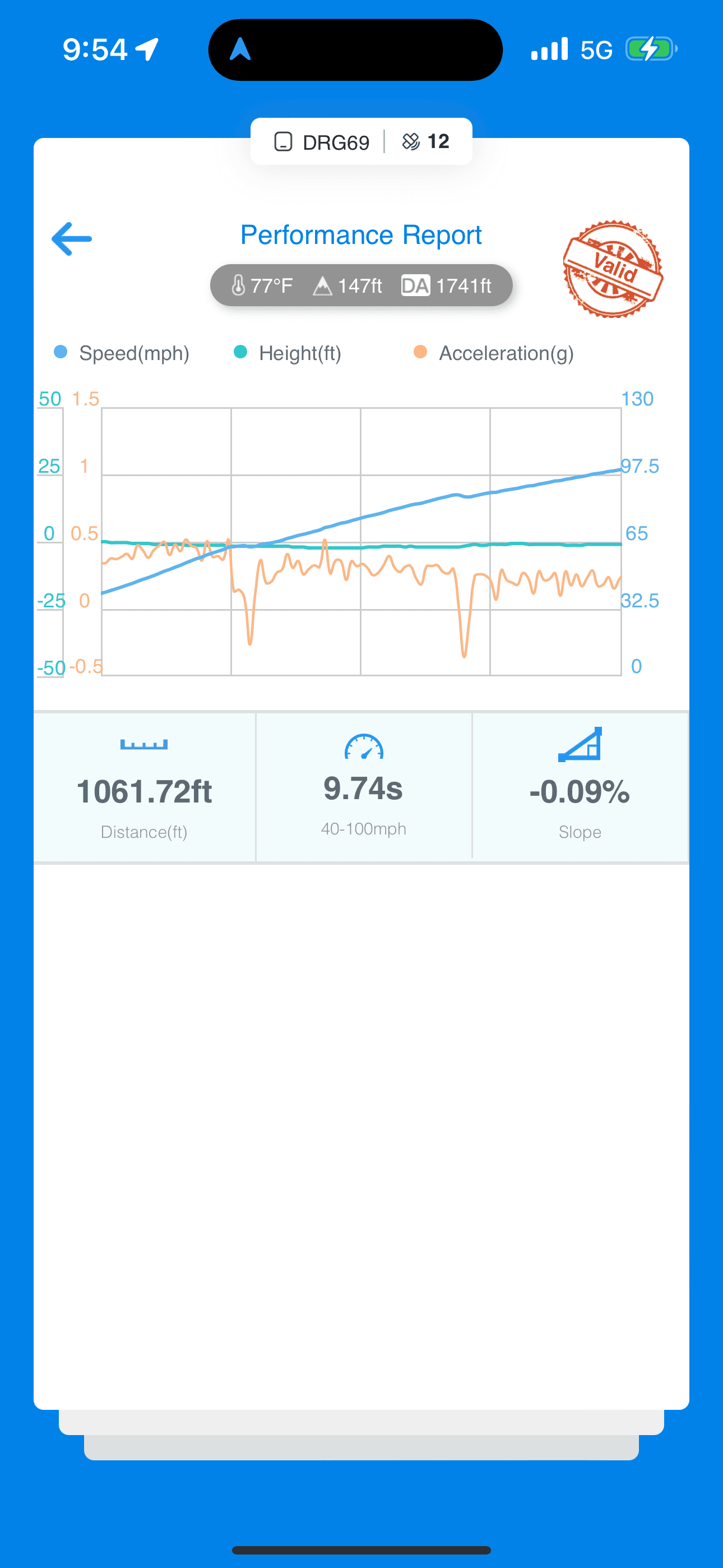

So aim for the tune was more power in the higher rpms while keeping timing reasonable for cooling egt’s and with a slightly richer air fuel for cylinder temps. This is being done for track use where you could use more power but at the same time keeping things in check without going for all out power. The car is on stock wheels and tires but as you can see its a controlled spin in second gear that is at the limit of grip without just roasting the tires.
Another goal of the tune is to decrease the spike from the hondata tune so early and move it up slightly higher in the rev range for decreased cylinder pressures at lower rpms. With a more progressive boost curve to help the HPFP not crash down low.
