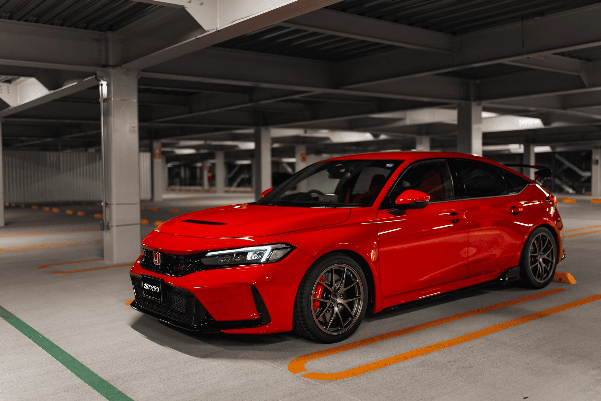

BBS RI-A-055 18x9.5 +50 5x120 for FL5 Civic Type R, shown here in Matte Graphite!

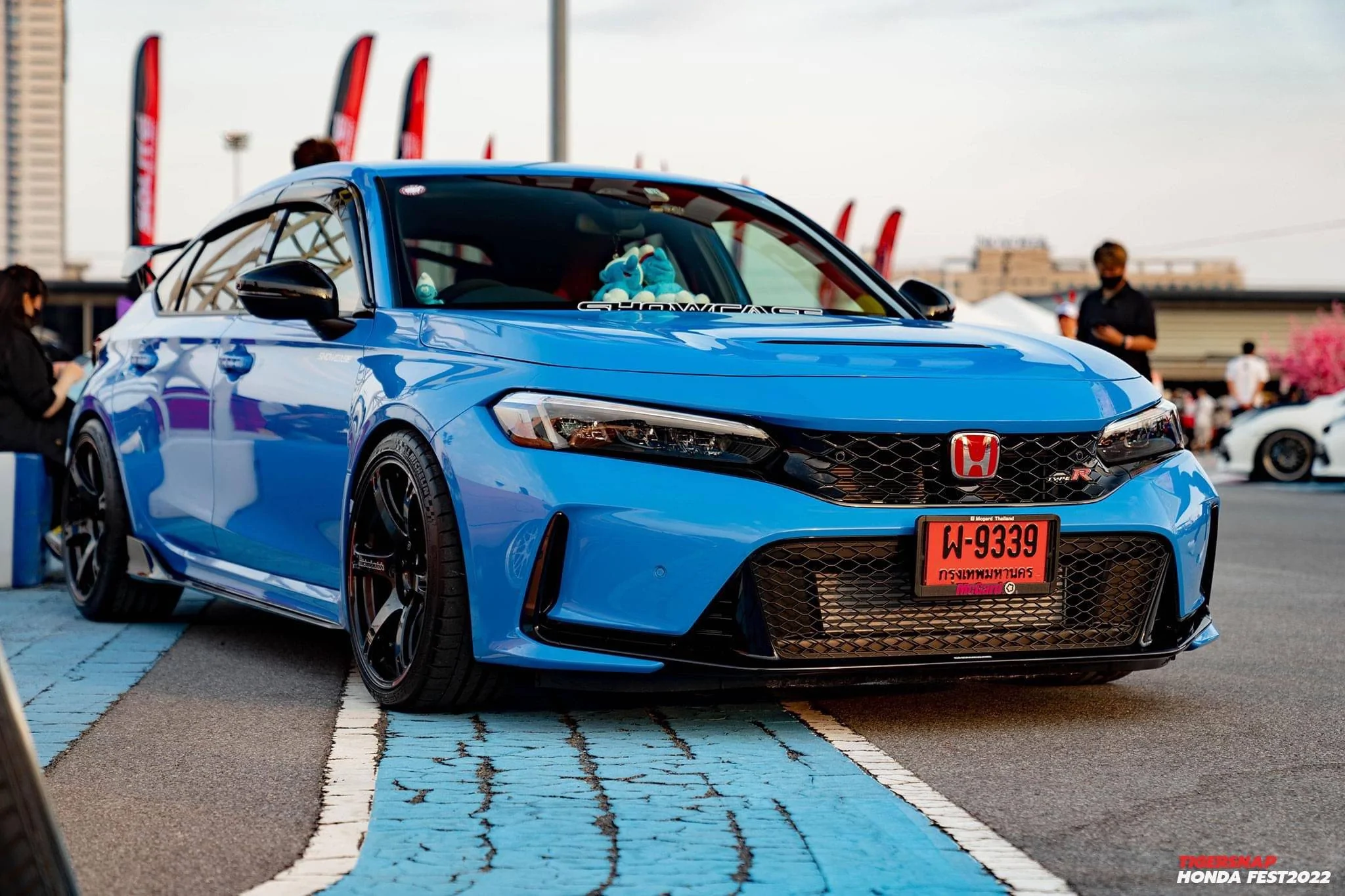

Lastly (for now), Boost Blue FL5 Civic Type R equipped with 19" Rays Volk TE037 6061 in Gloss Black. Configuration appears to be a 19x10 setup, and is a bit on the aggressive side and protrudes from the fenders, requiring fender work.
Mmm.
19x9.5
What offset to achieve a flush look. Maybe +48

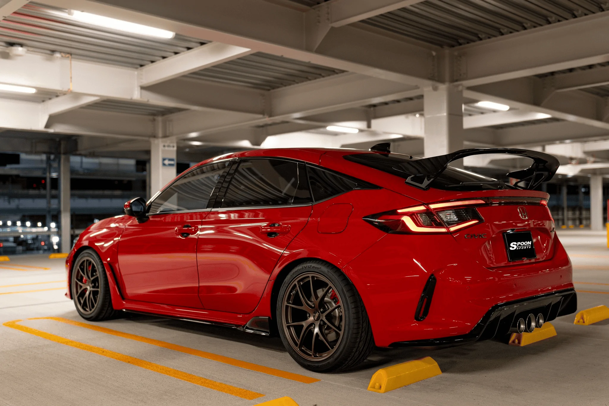

BBS RIA 055 18x9.5 +50 Matte Bronze + Spoon Springs!

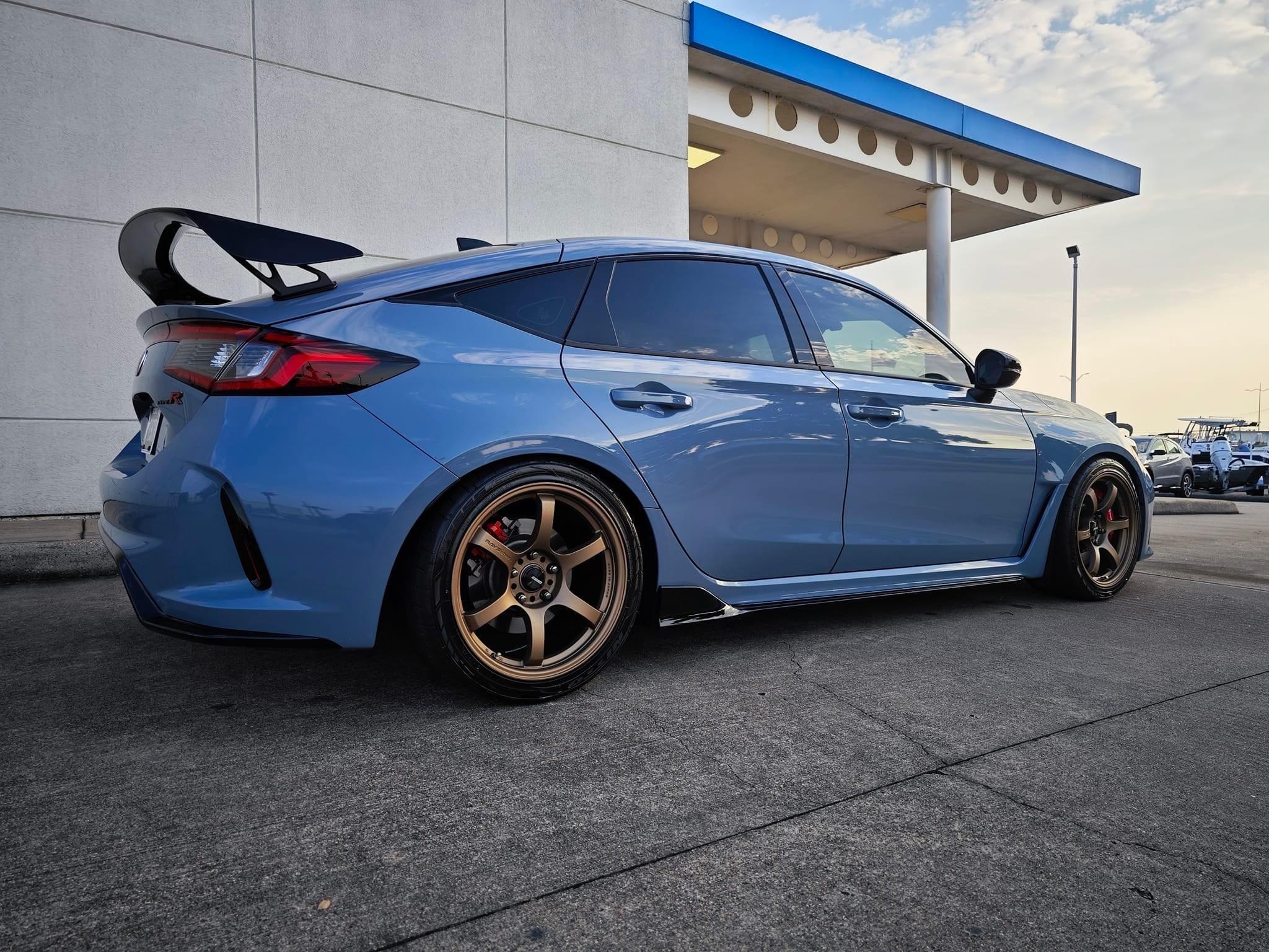

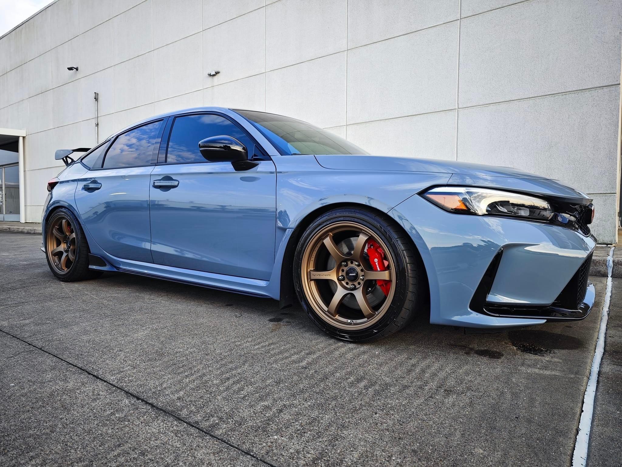

Sonic Grey Pearl FL5 11th Gen Civic Type R x Rays Gramlights 57DR 18x9.5 +38 5x120 in Bronze!
