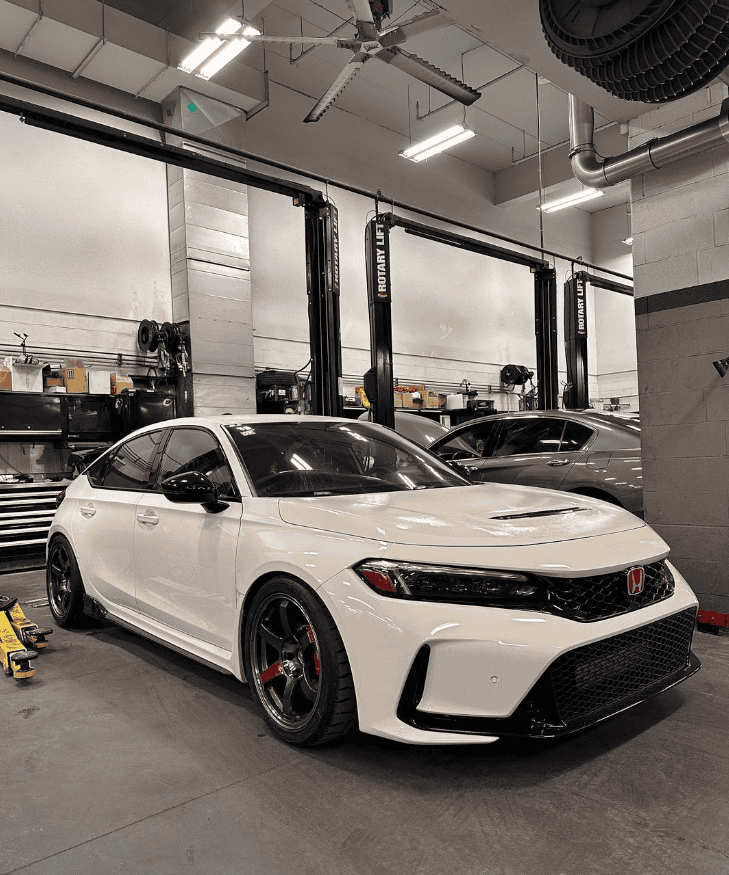

Ryan's FL5 Civic Type R w/ #systemspec Volk TE37SL 18x9.5 +45 5x120, Bronze w/ OG stickers + 275 tires! No rubbing.

FL5 11th Gen Civic Type R with Rays Engineering Volk TE37 18x9.5 +45 5x120 with a 265/35/18 tire. It looks like our TE37SL in 18x9.5 +45 5x120 will be a perfect fit and will boast concave face while maintaining adequate brake clearance on the new Type R.
