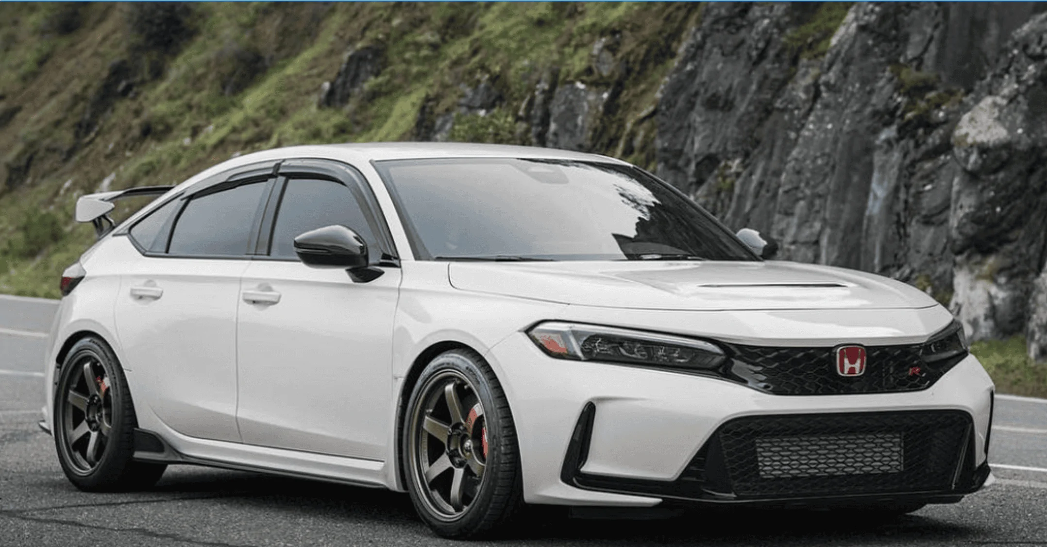

System Motorsports hooked me up with these Volk TE-37SL’s. 18x9.5 +45 offset, color - double pressed graphite. Tires are for daily use so went with an all season with more side wall, 255/40 R18. Lug nuts are from McGard
Looks nice. Did you notice a big difference is driving comfort compared to stock?

Thanks. I didn’t spend much time on the factory tires/rims so keep that in mind regarding my response. Main benefit I was going for was more sidewall in case I hit a pothole as this is my daily driver. In comfort mode the ride is compliant considering the type of car this is yet the handling is still crisp and sharp with the all season tires. I don’t feel I gave anything up in handling on public roads. So overall I don’t believe they changed the character of the driving experience. My previous daily was an Alfa Giulia Sport and the ride in that was much more of an entry luxury car that possessed wonderful handling dynamics but felt soft compared to the Honda. The Honda feels more ’special’ as a daily driver and keeps me entertained where the Alfa was more relaxing.

Rays Volk TE37SL 18x9.5 +38 5x120 Blast Bronze #systemspec concave on @FreshFL5 Champ White Civic Type R!
Now in-stock in a variety of colors.

Looks great! What's the advantage of the +38 vs +45? It seems like they both have the same face design but the 7mm is just a tad more aggressive and may have fitment issues when lowered on anything wider than 265 tires.
Or is this the spec that is being discontinued?

All TE37SL is discontinued, our clients have the ability to choose between the two offsets. We typically recommend the +45 for no issues even when lowered up to a 275/285 tire. However, a +38 sits a bit more outward (7mm to be exact) and will work with 255 and select 265 tires at OEM height or a conservative drop. Any lower and rubbing issues may be present. You cannot go wrong with either spec.
Most will go with the +45 for peace of mind and less complications down the road (ie if the car is tracked and they do not want to rub at full compression).
