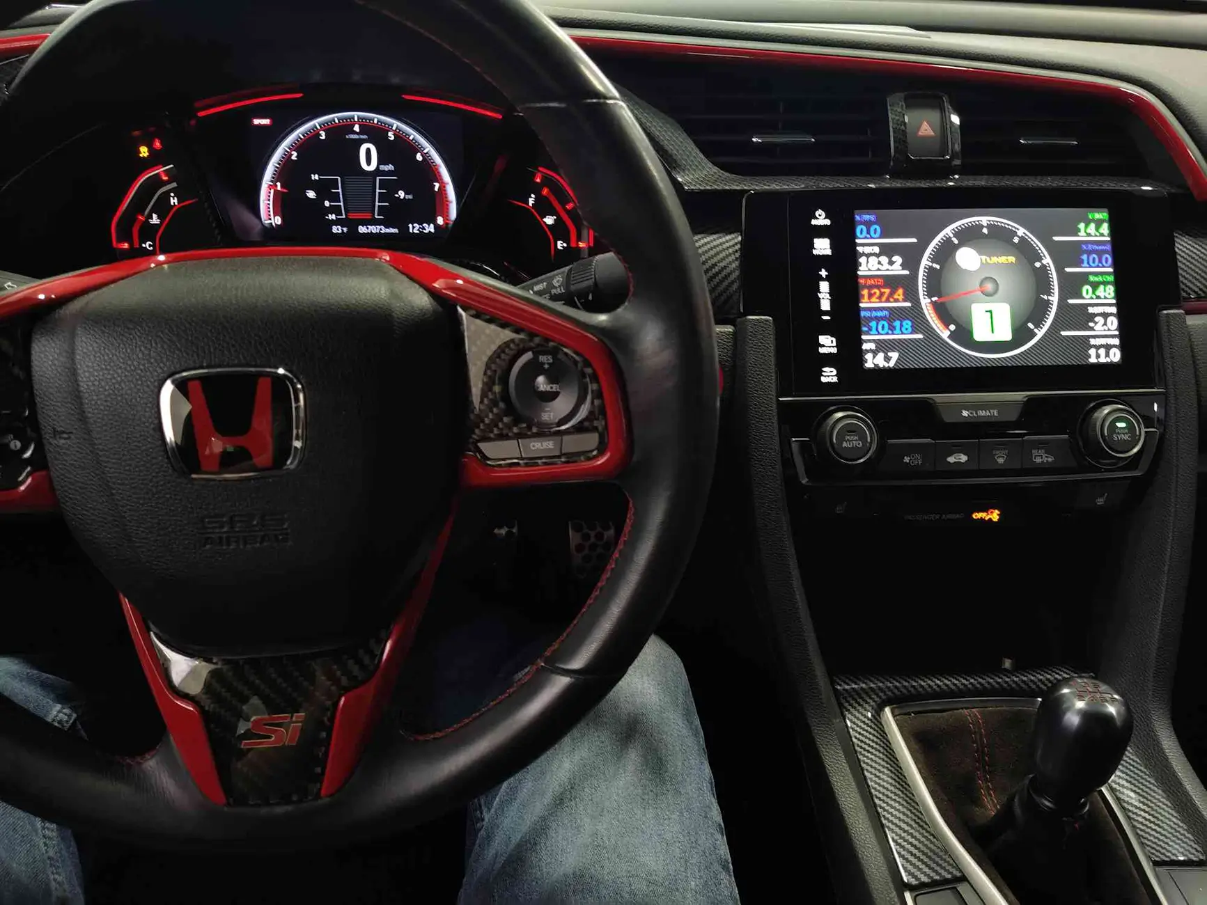

Curious, what do folks monitor on their V2 displays or in the Tunerview app?
Not 11th gen, nor KTuner v2, but here was my Hondahack Tunerview setup:
RPM and current gear
TPS (not CMD)
ECT2 (post-radiator)
IAT2 (post-intercooler)
PSI (MAP, intake manifold sensor)
AFR
Battery voltage
Ethanol content
K.Con
LTFT
STFT
I also set them to be color-coded based on values. Blue = undervalue, grey = normal value, green = good value, and red = high/bad value.
TPS: 0% (idle) = blue, 1-99% = grey, ≥100% (WOT) = red
ECT2: <160°F = blue, 160°F-194°F (up to temp) = grey, ≥195°F (when rad fan kicks on) = red
IAT2: <60°F ("boost weather") = blue, 60°F-94°F = grey, ≥95°F (K.Con multiplier increases) = red
PSI: <0 PSI = blue, 0-17 PSI = grey, ≥18 PSI (factory "peak" boost) = red
AFR: <14.0 (rich) = blue, 14.0-14.9 = grey, ≥15.0 (lean) = red
Battery voltage: <12.0V = red, ≥12.0V = green
Ethanol content: ≤11% E = blue, 12-29% E = grey, ≥30% E = red
K.Con: ≤0.55 = green, >0.55 = red
LTFT: <-4 (rich) = blue, -4 to 4 = grey, >4 (lean) = red
STFT: <-15 (rich) = blue, -15 to 15 = grey, >15 (lean) = red

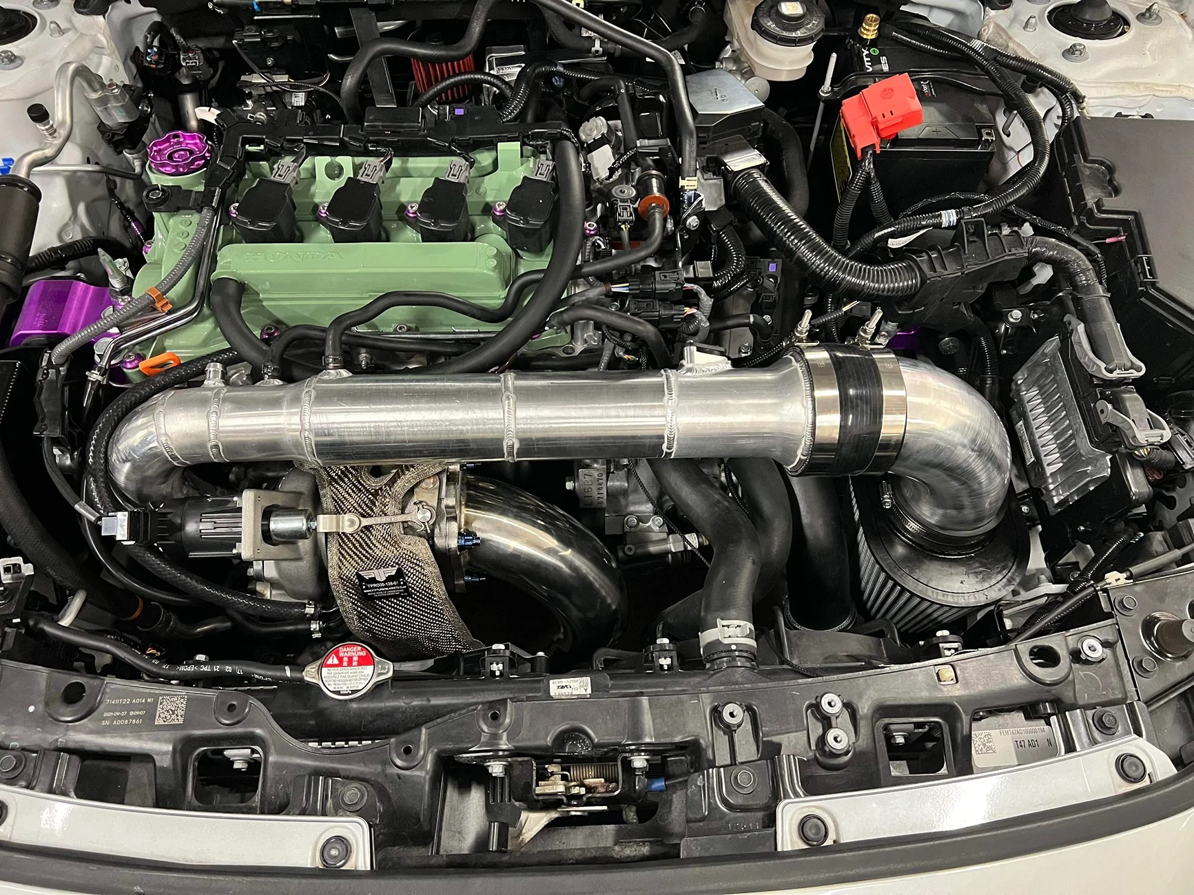

Our 11th gen civic sport touring made 314whp and 290tq on E30
Huge list of mods on our car, really everything was done and installed back in early 2022 to get info for the 11th gen community
Our Axion fuel system
Axion 2n1 downpipe
Axion 2n1 race inlet
Ktuner
PRL Flex fuel
PRL frontpipe
Hasport full mounts
PTP turbo blanket
RV6 turbo
Si intake cam
PPG built trans with 2020 final drive and Si LSD
RV6 type R retro flywheel and stage 0 clutch
7000 miles on this setup with zero issues just tire spin and then the K20c4 swap happened
