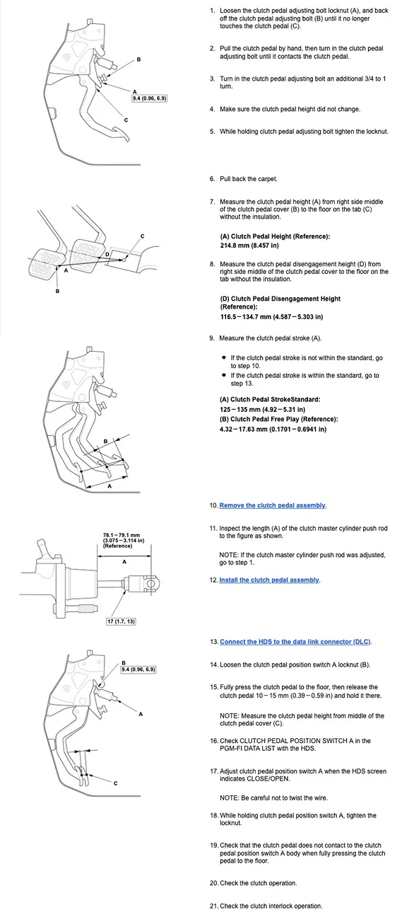

Feel free to ignore my delusions, but I wanted to put this out there to see if anyone has experienced something similar. I've had the RV6 FK8 retrofit kit on my car for about 1900 miles now. To keep it tuning related, I've got about 5,000 miles tuned with Phearable 1.5R with no engine problems whatsoever.
I have a fairly long commute (37 miles each way, of which 34 of that is highway) and occasionally, it feels like the clutch feels heavier with a slightly higher bite point after getting off the highway. It gives me no issues with shifting, no odd smells or sounds, etc. but it's like I have to recalibrate my brain for starting and shifting towards the end of my drive home. I'm not sure what would cause this, or if it's just in my head, but after slipping my factory clutch and paying a bunch to have the RV6 kit installed, I'm just hoping it's not installed wrong or slipping or anything. Holds 4th gear WOT no problem, but I did this kit to give me peace of mind, and I ain't getting it! Anyone ever have a similar problem, or am I just being neurotic?

... it feels like the clutch feels heavier with a slightly higher bite point after getting off the highway... Anyone ever have a similar problem, or am I just being neurotic?
I do remember having a higher bite point at times. I recommend adjusting your clutch pedal position and bleeding your CSC. This has fixed my high bite point issues in the past.
You'll want to follow the manual's procedure but you'll want one more full turn of clutch master cylinder push rod extension. I'm down to stop by next weekend after I pick up the ITS to assist.
Each offer to help me with my POS buys you an additional set of hands for the next ITS job. I'm gonna check this clutch pedal adjustment screw tonight cause now that I think of it, there's really no free play at the top of the pedal travel, and I know there should be!
