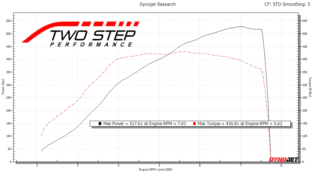

This is a great point but I will share something here... keep in mind this is an unmodified FL5 vs where it is today.
If you modify the car with the stock turbo, such as using our TSP Stage 1 Tune for the FL5, there is a large spike of low end / mid range torque available. However, we much prefer the extra horsepower up top.
This chart shows a basic bolt on car (downpipe, exhaust, drop in air filter) with the factory tune vs our TSP Stage 1 Tune.
Can you share the boost curve for these charts? It will be helpful to see that data plotted against the power charts you provided.

I'm guessing that the power tapers off up top because you've run out fuel capacity?

Thanks for doing what you guys do and sharing it with the rest of us. Its very valuable data and very significant gains.
How do you guys find the vehicle's heat management at this power level? I imagine the ethanol blend helps some. Are you guys ever running straight 91/93 non-ethanol to test?
Additionally, it appears the rpm limit has been raised by around 600rpm however you've got no mods on the valvetrain. It seems to be well known that the K20C1 valves start to float at around 7300 (and made worse when running higher boost) which it seems you're exceeding there on the dyno sheet. I would say there may be gains to be had and not to mention greater safety with upgraded valve springs/retainers (perhaps with some frictional losses lower in the rpm range).

Is that on a stock valvetrain? No headwork?
Impressive numbers and great powerband, how is the transient response on this turbo?
We tried a P700 on a not so modded FL5 and I felt like throwing the turbo out the window.

Very impressive thanks for sharing .
Is it the turbo that runs out past 6500 , or the valvetrain?
Also random but, what kinda oil are you running with this setup? Assume not 0w20 ;)
The R660 turbo responds very well in consideration of what it gives you up top.
We did experiment with 4Piston TR2 camshafts and found no measurable increase of performance after lot of effort optimizing the tune for them. My best theory is that with a larger turbo if you want to see gains with cams you need to also port the head. We have not tested porting the head on this car.
I think we are at a point now where the head is choking us a bit up top. A ported head should help but that isn't anything we plan on getting into anytime soon.

Lastly, here is the latest power output:
11th Gen Honda Civic TSP FL5 - 502whp and counting [2023 Honda Civic Type R Tuned & Modified] 1696000295478
The biggest help getting here from where we were has been the XDI high pressure fuel pump.
