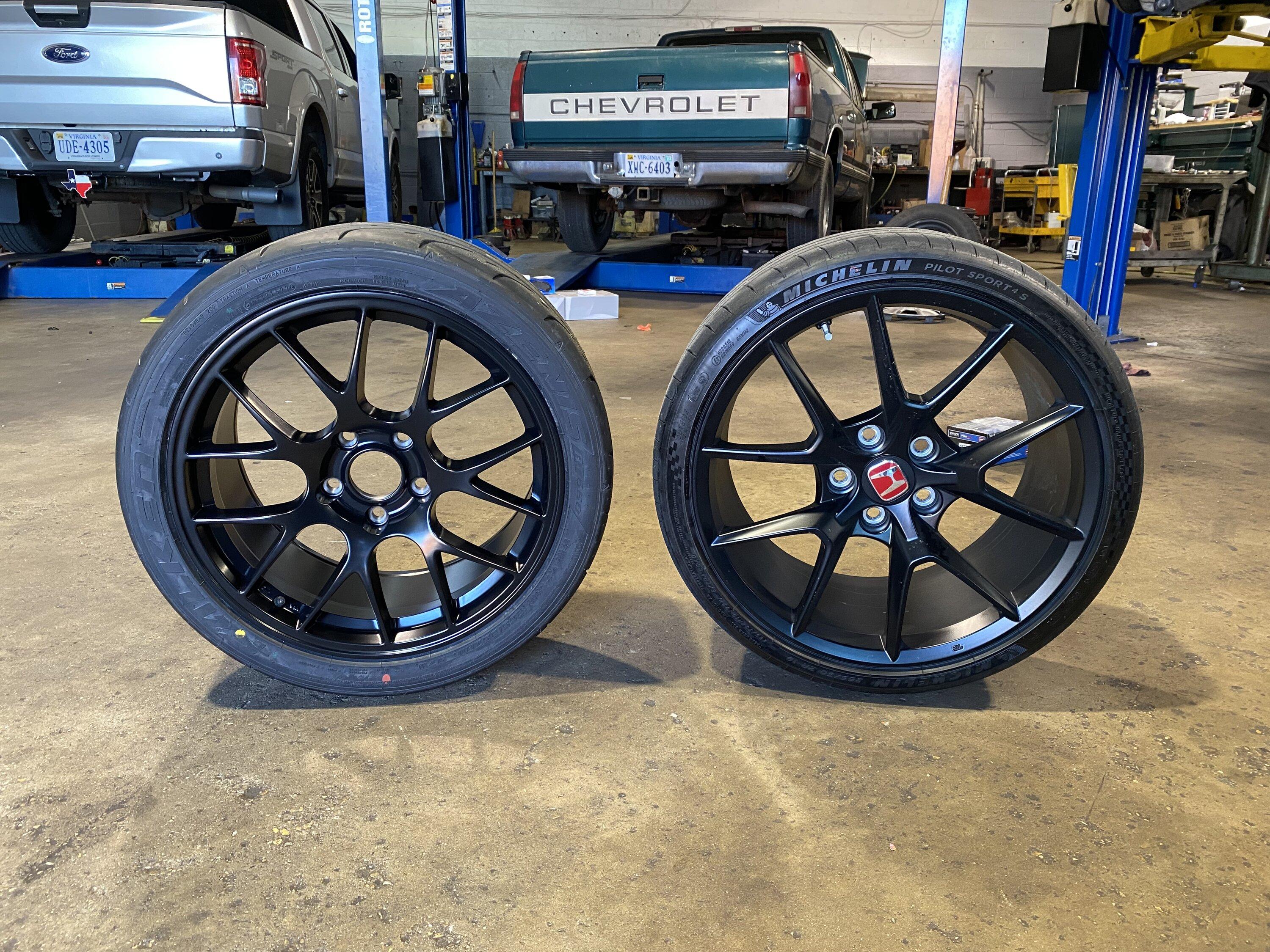

Those wheels look nice. Are they 18”? How do they feel compared to stock?
Yes they’re 18”x9.5” with 265/35R18 Falken RT660s. I haven’t driven enough to feel any differences yet. Should be putting a couple hundred miles on them this weekend and will let you know how it feels. Here is a pic of the new wheel/tire beside the OEM. Easy to see the extra sidewall.

Got the track/autocross wheels and tires on this week and washed all the damn pollen off tonight. I really like how similar these wheels are to the OEM ones. She’s all ready for my first autocross in over a decade this weekend. Test and tune format with light rain all morning should give me plenty of time to figure out where I’m going and then have the afternoon to see what the car can do.
They look great; at a glance, they look OEM.

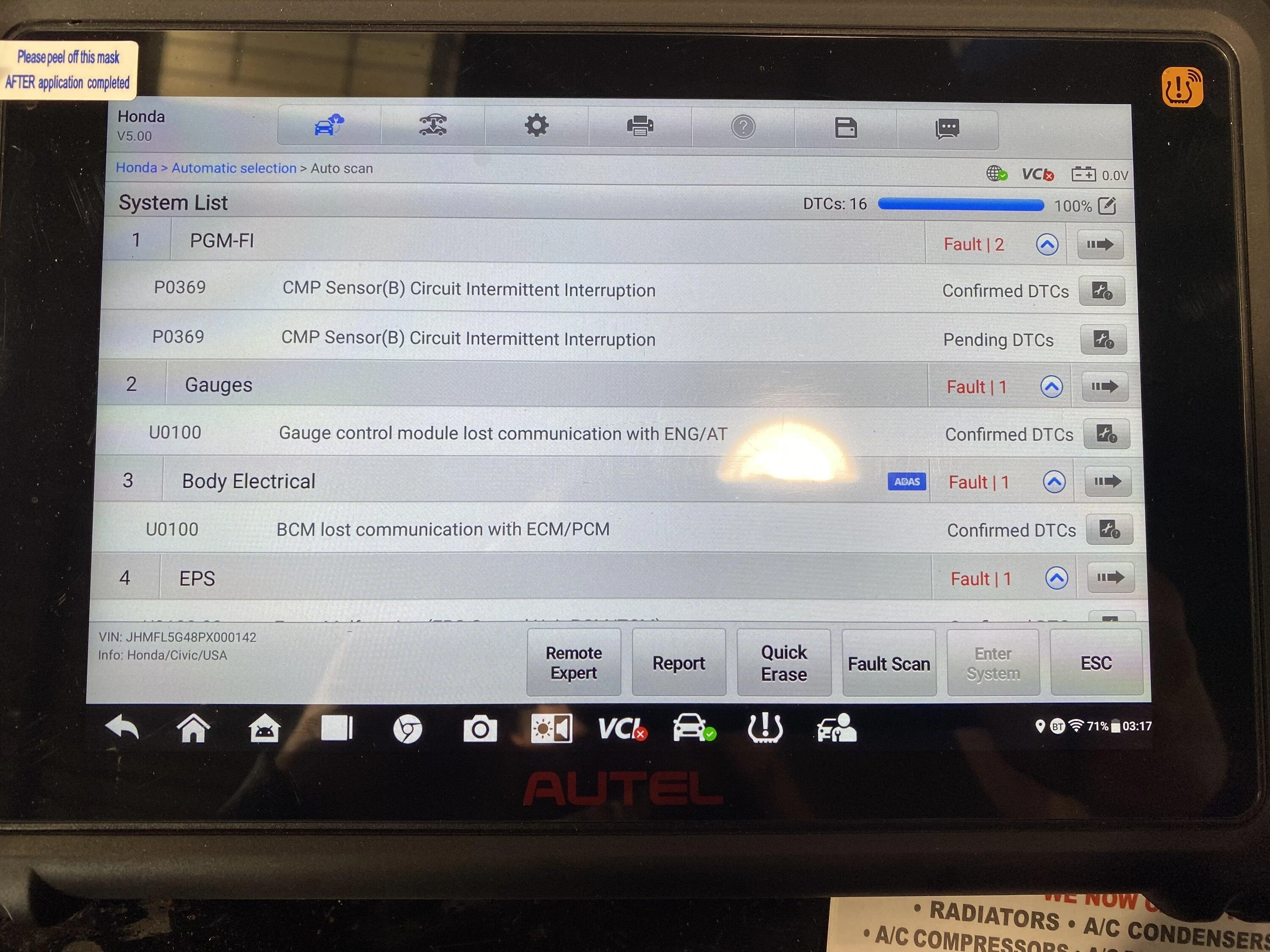

Womp Womp. Went to back the car out of the shop this morning and got an extended crank followed by the check engine light. Code is a P0369. I just messaged the dealer yesterday about getting the seat recall fixed. I need the car the next couple of weekends so I doubt the dealer will be able to do anything with the check engine light by the time I’m able to get it in there. Google found some hits of FK8 owners with the same issue but it seemed like every one that got the code just cleared it and it never returned. I couldn’t find a post where somebody had it checked out and fixed.

same extended crank for me, twice. i depressed the start button each time, tried again, and had a good start.
no fault lights and no obd codes, temporary or stored. i will call my dealer to see if there's a TSB.

I just checked TSBs on the program we use at work. Nothing there but it might take a while for them to get it from Honda if there is a new one. My light went away on its own after two more starts so I'm not gonna do anything about it this time. If it happens again I'll take it to the dealer. The car had been at work for a week or so and I was only starting it to move it in and out each day. Possible that the battery got a little low from that and caused the issue during cranking.

my dealer had nothing in their system either. no trend or pattern yet, but in both cases the car had not been sitting more than a day between drives

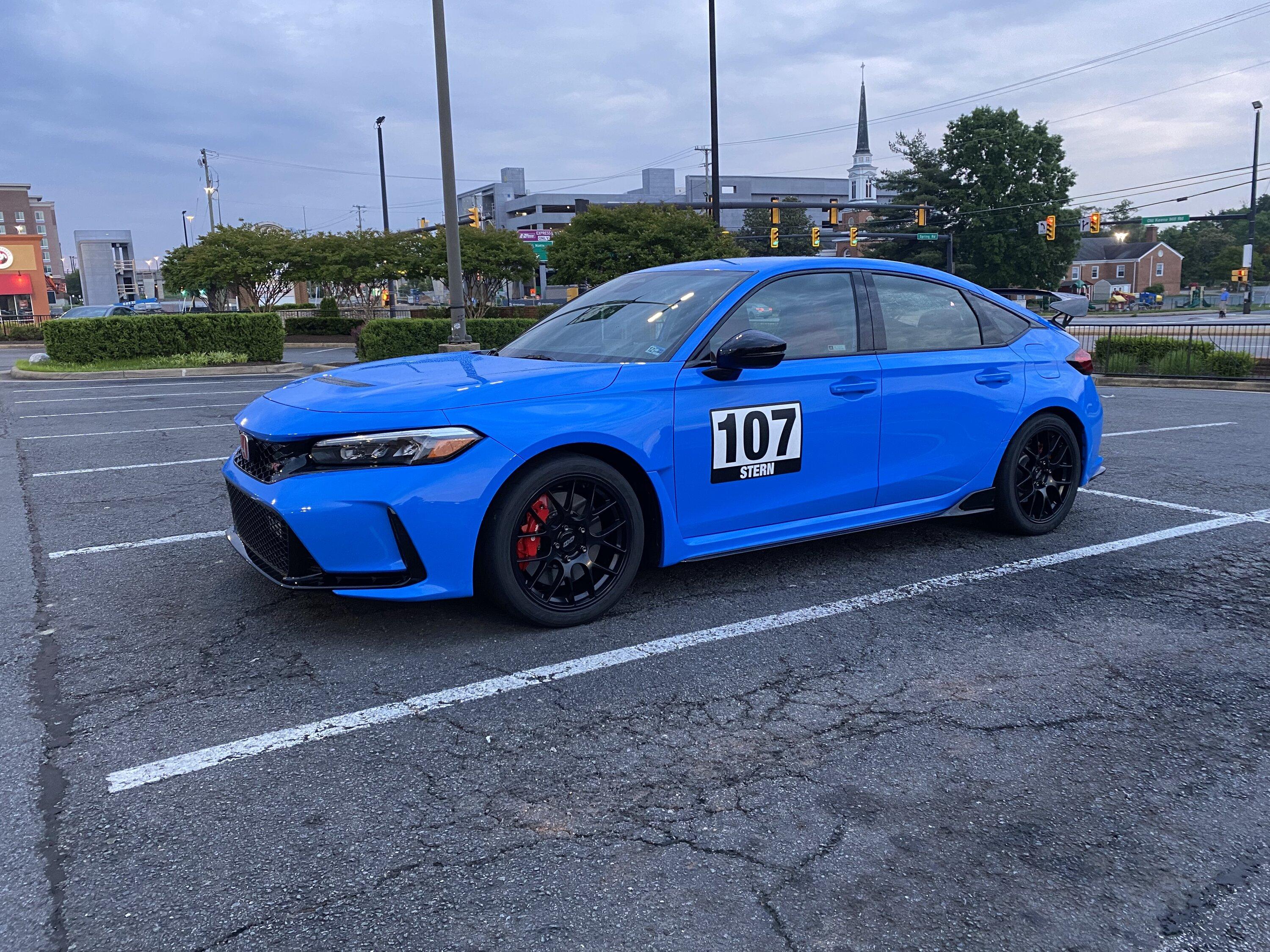

Took the car to the first points event for the DC Region SCCA Solo series. Walked the course 4 times and still missed a gate on my first run. It got better from there though. After the third run I was leading the B Street class but a Corvette was getting faster. After run 4 I still had the lead but our best runs were only a few hundredths of a second different. For the final run I focused on being smooth and carrying momentum and cut .4 seconds off my time and was able to stay ahead of the Corvette to get the win in BS. Finished 30th in PAX though so obviously still have a lot to learn about this form of competition.
One guy driving a Si with the same Falken tires mentioned that he runs tire pressures pretty low. 28F and 32R. I had mine at 38 all around. Wondering if the lower pressure would help? For next time I might lower the front but keep the rear high to help get some more rotation going.

nice vid and congrats on the win... good stuff!
