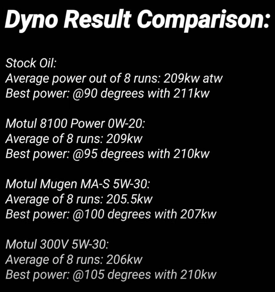

Here is someone else that methodically does engine oil analysis and he went down from a thicker oil and slightly above the manufacturer requirements. OEM spec was a 0W-20 he tried all the way up to a 5w40, but realized he's not improving performance or protection and he tracks and modifies his car. Your engine will run hotter with thicker oil, take longer to get to operating temperature, and you're loosing ~5-6 hp with a 5w30 ( proven by Motul dealer - you're adding friction is my understanding ) and up to ~9-10hp with a 5w-40 on the FL5 Type R -- This gentleman's data pointed him to a perfect balance with a 0w-30 from his lab findings. You want instant protection cold or hot, and you also want to get to optimal operating temperature as fast as possible. He dispels a lot of the conspiracy non scientific theories regarding, just blindly run a thicker oil.
Worth watching the whole thing. From his data looks inline with some other data we've received, and engineering explained -- I'm leaning towards a 0W-30 engine oil maybe also. Engineering explained, that's important not to change the first number 0W but it's safer to go up on the second number due to the same reasons. Get the oil flowing fast, as cold engine starts are where most of the wear can occur.
These new engines have very tight tolerances, and it seems you want to get that oil circulating instantly and you want to get it up to temperature very fast.
The Pennzoil Ultra Platinum 0w-20 are thicker ( 8.8CST at 100c ) than my Honda oil ( 7.99 CST at 100c ) as a base line and the Valvoline Ultra Max life 0W-20 is also thicker at ( 8.7cst at 100c ) based on the virgin oil samples. From that data above that Valvoline seemed to really do extremely well over long extended drain intervals. There are also two people in the community here that have run 2 Motul API SP oils and they seem to do incredibly well with shear resistance.
So far the best we've seen in sheer strength were from the Motul 8100 line. One was Motul Eco Clean and the other was the Power 8100 5w30, and Eric who tracks his car very hard at Laguna Seca with twin oil coolers.
It seems Motul's 8100 line API SP engine oils seem to be the most shear resistant so far from the data I'm seeing.

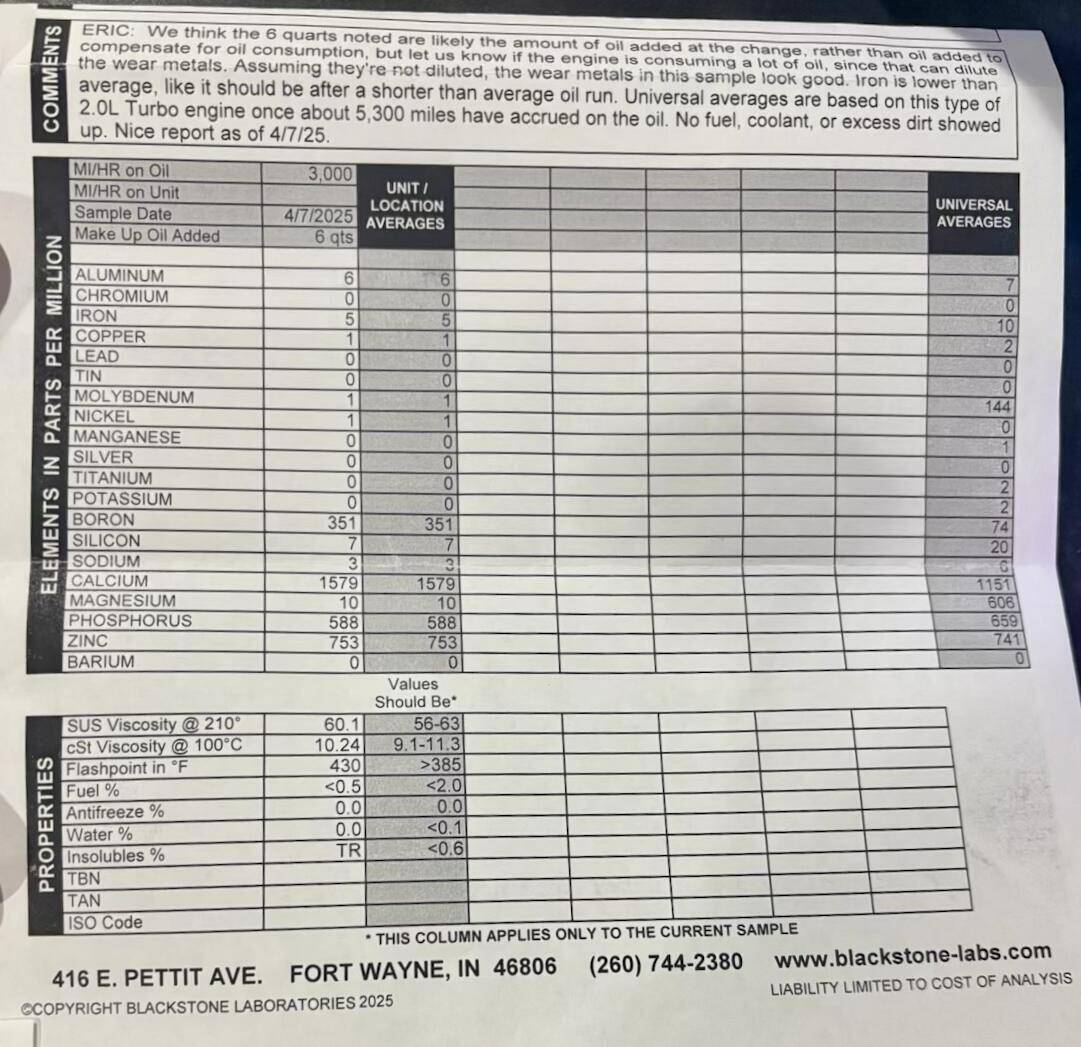

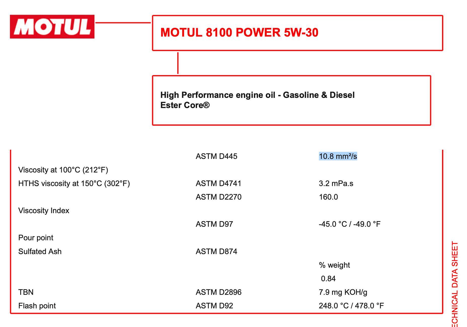

After 5000 miles and many track day's, Eric's oil only sheared down to 10.24 CST at 100c from a 10.8 new !
11th Gen Honda Civic 🔴💊 Engine Oil Red Pill Thread: Only Post If You Have UOA - Official Honda Civic Type R K20C1 Engine Oil Analysis 1748695423352-nz
This also matches the findings of the other gentleman -- he found through his engine oil testing of Motul 8100 Eco-Clean 0W20.
So far the Motul 8100 line seems to have the best ability to stay within its Viscosity index for the longest period of time. My understanding is the Motul Power 8100 is the second highest grade motor oil they make which has an Ester Blend. Motul 300V is their highest grade oil, which is a double ester blend, but it seems to shear down fast from some oil samples we saw, as it's designed for single track day use.
Seems like Both Pennzoil Ultra Platinum and Valvoline - are safe off the shelf excellent low cost oils, and seem better initially from the data than the Honda Oil, as you are starting at a thicker viscosity, but at the same time, we were able to prove racing on track on the OEM oil with frequent changes was safe for 3 track days and ~2500 miles. Blackstone said, I could even go 4000 miles, but I would not push that after loosing ~1.5cst.

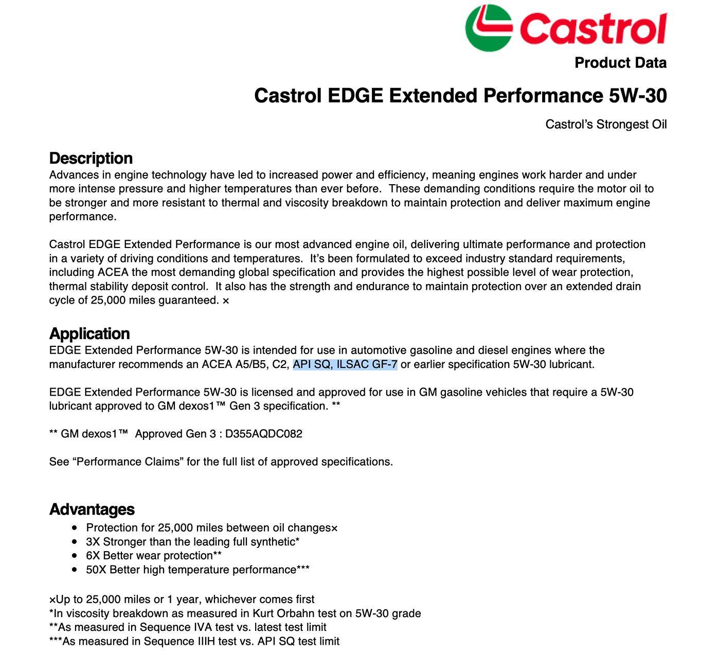

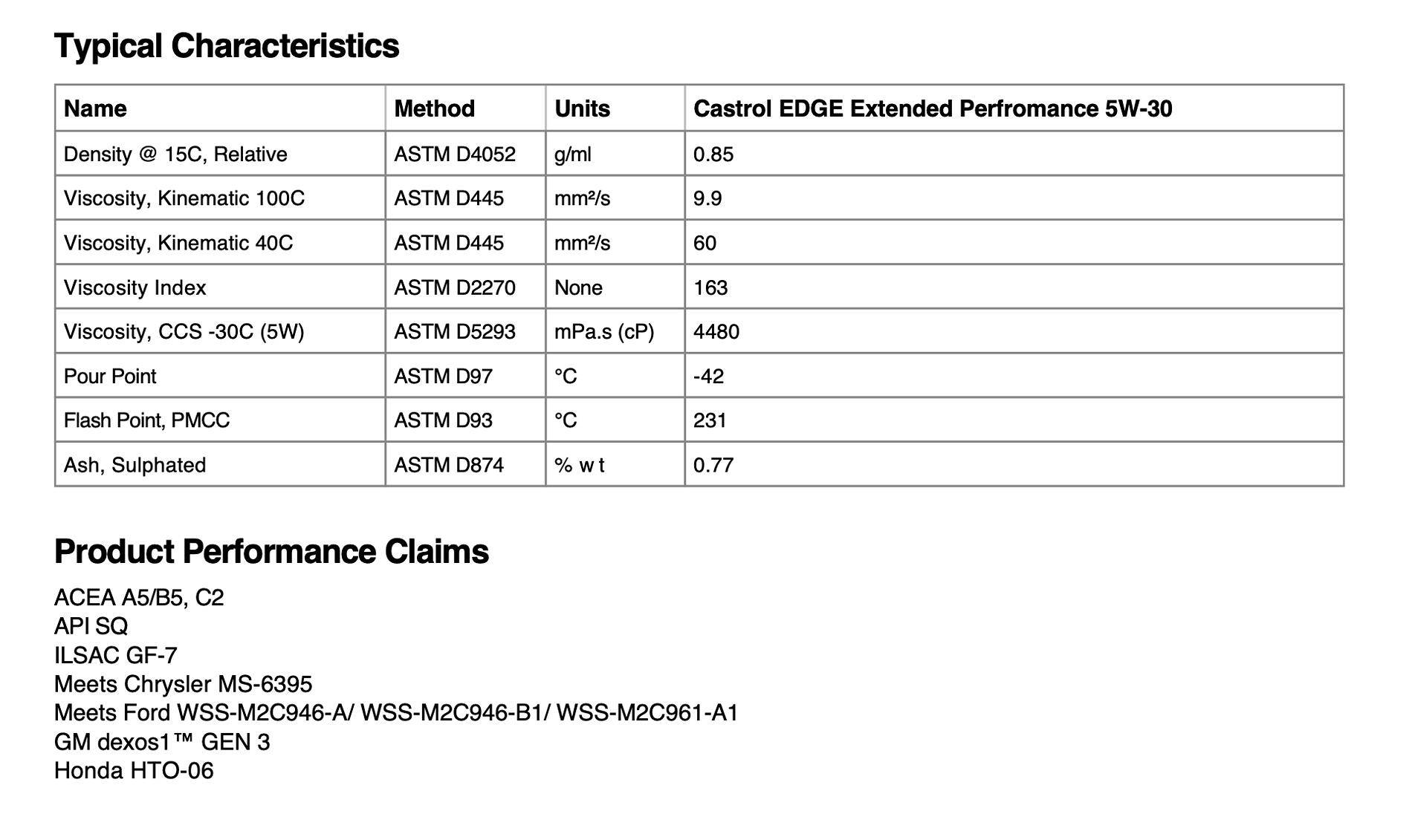

10W-30 — that’s really interesting. I didn’t realize it’s actually listed in the Honda manual for Australia. I assume ambient temps are much hotter there, and once again it seems Honda is drawing the line at 30-weight oil as the upper limit they'd like to see. That also lines up with what Spoon runs in their 25-hour endurance race cars — Ravenol REP Racing oil PAO 5W-30 12.2 CST at 100c upper range.
@Rhorn also makes a great point — it really depends on the oil’s range. With brands like Mobil 1 and Castrol, their 40-weights tend to sit on the thinner side and can shear down to a 30 pretty easily. On the other hand, oils like Motul and Red Line are usually blended toward the thicker end of the 40-weight spectrum — close to the max — and hold their viscosity much better under stress.
I'm especially curious now about the new 2025 API SQ standard that just got released.
I think I might try the new Castrol EDGE Extended Performance 5W-30 with the API SQ rating, just to gather fresh data — unless someone already has some. We’ve already got good data on Pennzoil Ultra Platinum, Motul 300V, the 8100 series, and Valvoline.
From what I understand, API SQ has tightened the standards — especially around staying in-grade for longer durations. This Castrol formulation meets all of Honda’s requirements, supports direct injection, and sits on the thinner side for a 5W-30.

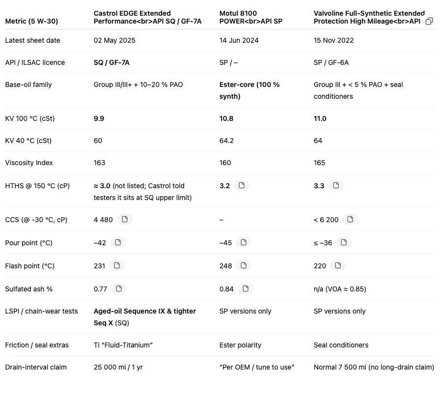

Here’s what I want to test:
  1. Engine noise levels (dB) — comparing 0W-20 vs 5W-30. Does it run quieter, and if so, by how much?
  2. Oil pressure — both at idle and at redline in neutral.
  3. Max engine temps on track — do we see any increase in coolant temps?
  4. Used oil analysis.
We’re about to nerd out on this — fair warning. This definitely won’t be for everyone. Most folks will be totally fine just changing their oil regularly.
Threw the data sheets into AI and this was the comparison - (ai errors possible )

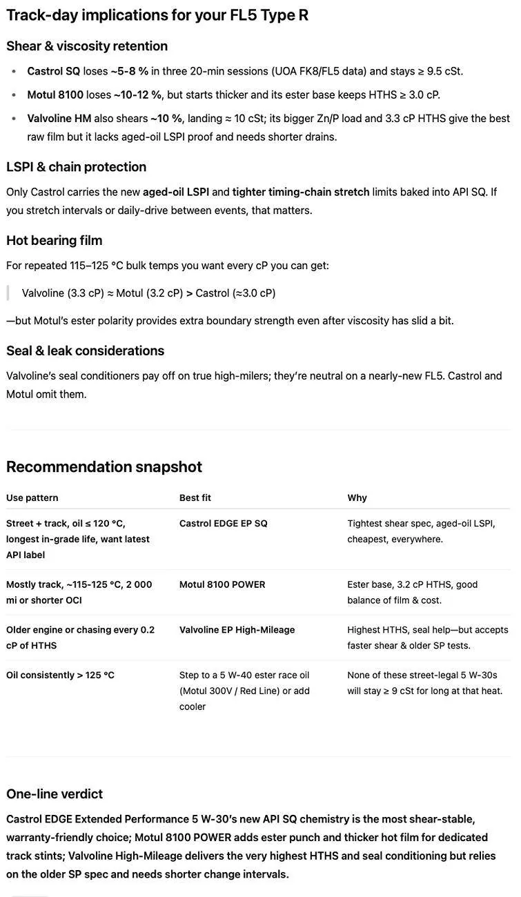

Damn didn't even know SQ oils were out already

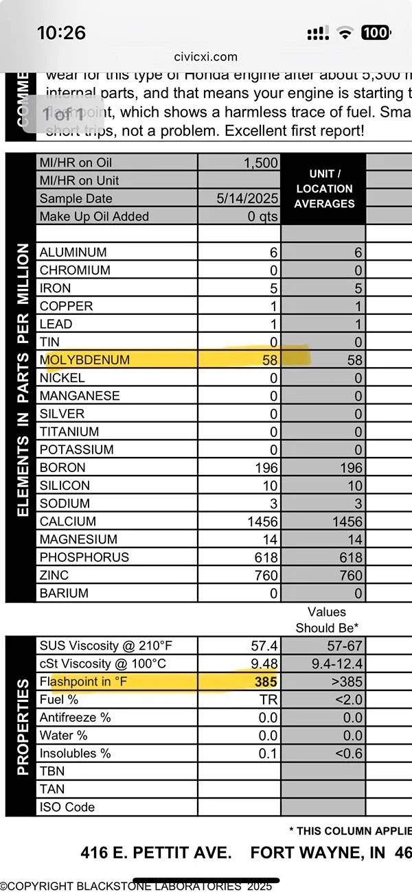

0w30 mobil 1 ESP. Lightweight 30w sheared down a little.
Just based on the numbers the wear metals look good, on par with the baseline Honda Ultimate OW20. Flashpoint was much lower and Moly was lower, but the reality is the wear metals was the same.
It seems so far the Valvoline and Honda oil performed much better with maintaining flashpoint. What I’m curious about is - is it because they’re better oils than the Mobile oil? Or is it the 0W-20 vs 0w-30 grade difference. Is it due to as the scientist explains in one of the videos as you go to a thicker oil for a engine that has strict tolerances design for 0W 20 the engine has a more difficult time scraping off the oil from cylinder walls, and you get more fuel dilution.
I think what an interesting test would be for me to try next is Honda ultimate 5W-30 synthetic as I recently saw it somewhere and that way we would be comparing apples to apples and just moving up in viscosity with Hondas formulation. If fuel dilution increases then we know the scientist is correct.
If we can get aluminum and iron down to 2-3 ppm we’re doing excellent. One person on this thread was able to do that with the liquid moly additive but if we can get there with an oil that’s out of the can ready to go - that would be ideal.
