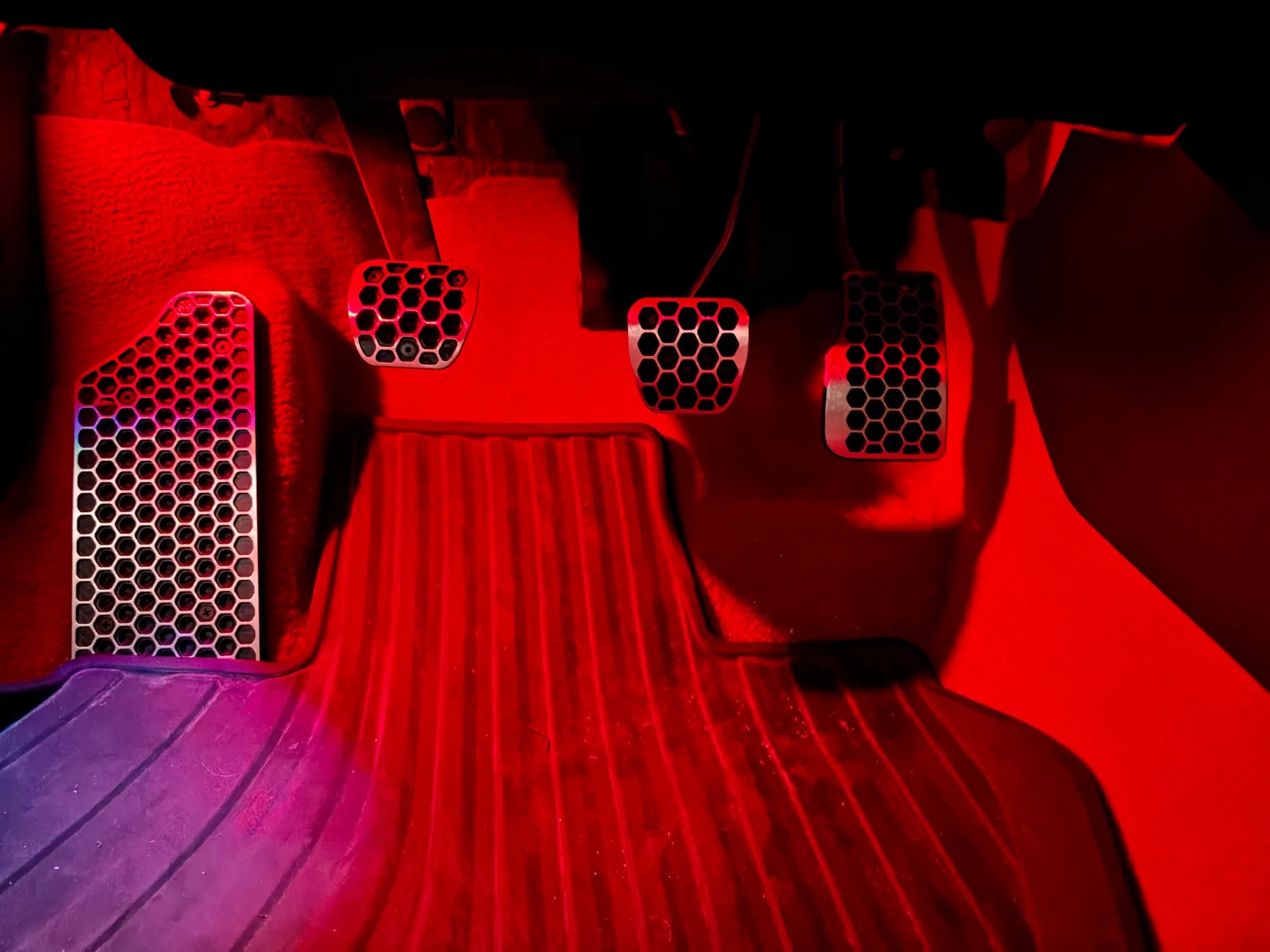

07/11/26 Update:
I installed SRP Racing Pedals today. I’ve had them for about an month and hadn’t gotten around to installing due to lack of time and very hot weather leading to a very hot garage.
Installation is straightforward.
Dead pedal - drill four 7/64 holes and then install the SRP cover with provided four sheet metal pointed screws. They are self tapping and you’re basically screwing into a soft bit of foam and carpet.
Clutch pedal - The clutch pedal is plastic. Remove the existing metal/rubber cover. It slides off with no modifications. The plastic pedal has three pre-drilled holes. Install the SRP cover with provided three machine screws and nuts.
Brake pedal- The brake pedal is metal. Remove the existing metal/rubber cover. It slides off with no modifications. The metal pedal has three pre-drilled holes. I had to use a 11/64 drill bit to increase the size of the holes to use the provided machine screws and nuts.
Gas pedal - This is the most time consuming pedal to install. The OEM metal cover sits over a plastic base and is held on by four metal tabs that are bent around the inside of the plastic pedal. I used needle-nose pliers to bend two of the tabs to remove the OEM metal cover. Once this is done you’re left with a plastic pedal that has several grooves. The SRP cover has a series of holes that don’t perfectly align with the raised areas of the plastic pedal so you have to choose where you’re going to drill new holes. I used a 1/16 drill bit to start two holes. The plastic is fairly tough. I then drilled the two holes to 7/64. I used two provided sheet metal pointed screws to install the SRP cover. I then repeated the 1/16 and 7/64 on two more holes and used two more provided sheet metal pointed screws to secure the SRP cover.
The SRP pedals seem to be well built. I’ll update after my 7/12/26 track day on their effectiveness compared to the OEM pedals.
One area of improvement would be to have the holes in the metal SRP gas pedal align with the plastic OEM pedal surface. As designed they’re slightly off so you can’t align your screws with each of the OEM plastic raised surfaces.
Total install time was about an hour. It would have been quicker if It weren’t so hot in my garage and if I had the notes I provided here.

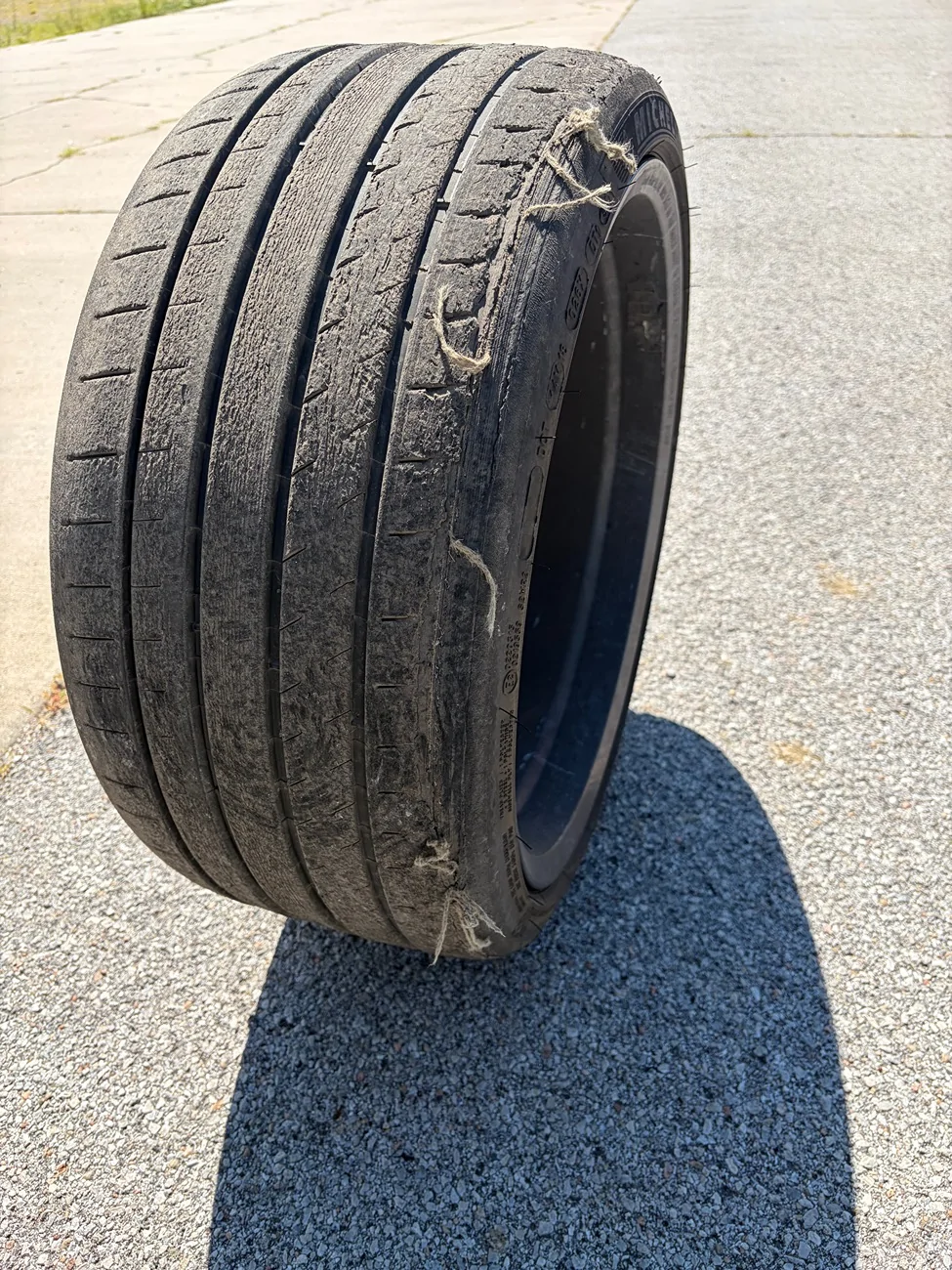

07/13/26 Update:
I completed another track day at I29 Speedway on 07/12/26.
It was a very hot and humid day with temps peaking in the upper 80s and humidity at 60-75%. In the morning, when it was 75-80F, I was on 91 octane and fuel map and was able to reach top speed of around 122MPH. In the afternoon, when temperatures reached up to 88F I was running 93 octane and fuel map and was able to reach 124MPH.
The SRP pedals worked perfectly. They are more grippy than the OEM pedals and stayed firmly connected. They are set up better for heel and toe shifting than the OEM pedals and I had to be mindful of my foot position when on the brakes to avoid inadvertently pressing the gas. My Lotus pedals were much closer together so it’s a muscle memory thing I was able to correct after a few laps.
My tires were not in the best shape with some tread delamination starting on the rears, from my last track day when they were on the front. My goal was to get through six sessions without losing a tire. Traffic in the advanced group prevented many clean laps so this assisted in not overheating the tires. I was surprised how well they held up through the day, given their starting condition and my previous experience with them. I completed 36 hot laps.
The advanced group had several drivers/cars present that had no business being in that group so it was pretty frustrating to have them consistently ruining laps and failing to point by. Every time I saw a particular BRZ and Boxster, I knew the lap would be ruined. Frustrating stuff and not usually the case in the advanced group.
By the last session of the day, most had given up due to the heat so I went out with only one other car on track. With the track wide open I decided to push the car hard to see if I could approach a PB. I quickly set a lap about 0.5 seconds off so I took a cool-down lap and tried again. At this point I was sliding quite a bit and fighting understeer but was on pace for a new PB. I struggled to find any front grip in the last two high-G corners and missed a PB by about 0.25 seconds. I completed a cool-down lap and called it a day.
Sure enough, the fronts were done. Heat + sliding + rough track surface is a bad recipe for PS4S. They end their life with 135 hot laps over four track days and 20+ sessions.

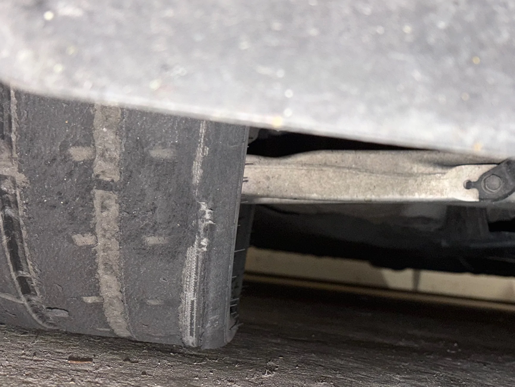

08/30/26 Update:
I ended up with no track days since 07/13. I went to I29 today with the Nankang CR-S tires installed along with the Verus canards. I am still waiting on Racebred splitter so didn’t yet install the HRC wing.
It was another hot and humid day. From the first lap with the Nankangs, the difference in turn in and feel when compared to the PS4S tires was clear.
The car rotates better, grip is communicated more effectively and therefore easier to judge, and the tires are quiet and confidence inspiring. All day I was able to run consistent laps when there was no traffic.
I was consistently able to beat my PB on the I29 full course, with my new best around 1.5 seconds better than set previously on PS4S.
I am not sure if the canards are changing much without the splitter and new wing. They are meant to work in concert. I did note my top speed on the straight was 4.2 MPH slower (122.0) compared to my previous best lap from May (126.2). Weather today was 82 degrees and 62% humidity for the fastest lap, while the previous was 64 degrees and 34% humidity.
The big disappointment:
All day I monitored pressure and inside, middle, outside tire temperatures. I ran 43 laps today over six sessions, with 6 laps being final cool-down laps that I didn’t record.
I never rotated the tires front to rear or side to side because wear looked great, temperatures were pretty even across the tires, and pressures were consistent.
After session six I pulled in and saw I had yet again, with a third brand of tire, corded the inside of the passenger front (See photo).
What a disappointment - one track day, 37 laps + 6 cool-down and another destroyed tire. I’m running around -3.5 degrees camber on the fronts and it’s only the passenger side being damaged on the inside edge. The only solution I can come up with at this point is to go to a staggered front camber setup where I keep the -3.5 on the driver side and take 1 degree less on the passenger side. I’m using ball joints so only have three settings available in 1 degree increments. Other than that, I guess it’s coil-overs at this point.
Is anyone else having these problems when really pushing an FL5 on track? My home track is bumpy, has pretty rough pavement, and mostly right hand turns, which all stress the inside of the passenger front tire.
For context, I ran 7-8 seconds per lap faster than the other two FL5s present today. One was close to stock with 18s, Toyo tires, and pads. The other was close to stock with PS4S, ITR suspension module, pads and fluids. Previously with PS4S I would see around a 6 second per lap gap with the other FL5s on the same tires. I have no doubt if I was running the slower pace my tires would survive.

I don't necessarily intend to do the every-other-weekend track rat gridlife stuff many of you do, but I'm going to start paying attention to the tire issues as I ramp up to actually get more track days in.
I'm actually utterly shocked you tried to live this long with PS4S, especially considering all the mods you've done. Brakes and camber just don't fit with the PS4S. I had them at their limits on a completely stock DE5, and I'm not the fastest driver. I'm glad you finally tried a real track tire, but it is unfortunate that they died so quickly. Although not super surprising based on my experience. I've killed numerous tires just from autocross. PS4S die faster than most to my experience.
This platform needs front camber to be fast. From what I've seen, front camber kills tires. It's just a fact of life, until proven otherwise. Maybe @tezzasaurusrex can weigh in, or @Zygrene if he still pays attention to FL5/DE5 forums. Pretty sure they both run 18s though.
You really should consider buying a set of 18s and trying RE-71RZ. I feel like 18s with more sidewall are more resilient to track use. I tried to hold out and force the issue with 19s too but caved this season and went 18s with RE-71RZ. So far so fucking good; tires have held up to 4 autocross events, feel faster, and still look new. Just FYSA.
You could also consider Falken. RT660+ are available in 275. The ones I had were good up until a cold day on a shitty surface; one of them basically started falling apart. The other 3 are good though, which leads me to surmise it may have just been a faulty tire.
Still with all the other mods you have going on, I don't see why a move to 18" wheels should be a prohibitive expense.
Also jury's still out for me if aftermarket cooling mods are necessary on this car, or may in fact contribute to overheating. I think the bar-and-plate intercoolers have pretty much provided enough empirical evidence to suggest they have zero business being used on track. Until more documented examples of OEM cooling systems actually suffering defeat in track settings, I'm still of the opinion they're a complete waste of money, up to and including having the potential to ruin a trackday or two all by themselves.

Camber can be a double edged sword. It will help you gain grip on the outside/heavily loaded wheel, however the inside wheel ends up in a sub optimal alignment as the negative camber becomes even greater negative camber as the vehicle rolls.
The wear you're seeing on the inside on one tyre only is synonymous with drivers who tend to carry reduced corner speed and accelerate hard out. Spinning the inside and destroying it in the process. So for left hand circuits you'll see this very prominent wear on the left inside tyre. Judging by your photo, I assume this track you're on is a right hand/clockwise track.
If you're seeing this wear on both tyres, then it's a toe issue.
Upgrading the LSD to a mechanical/clutch type does help, along with increasing caster angle if you can (quite difficult on this platform)
However this is mostly a driving style issue. Carrying more speed in, and being more gentle on the throttle as you exit is the best solution. I also understand that this driving style is not for everyone as it does carry a little more danger factor.
Thanks for the feedback. Yes this track is a clockwise configuration and they never run the other direction.
I’ve never had this issue with any other cars, but this is my first FWD track car so I think that is contributing. I can definitely focus on relying more on corner speed and less on power.
I had considered the HRC (Cusco) LSD so maybe I’ll go that route. That’s one more maintenance item but I expect it would be much more effective. Thanks for the tip.
