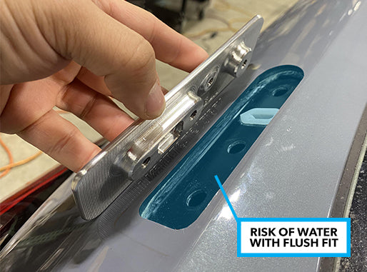

1. The Factory Hole Is Not Precise
Figure 1 shows the hole in the hatch that accepts the wing risers. This slotted opening is cut into the plastic by a router after molding, and the result is:
  • a rough, uneven cut
  • burrs and sharp edges
  • non-precision placement
11th Gen Honda Civic PRL FL5 Wing Delete: Clean Looks, Smart Engineering Wing-Delete-1
The sheet metal opening underneath is smaller, and the wing riser base is designed to cover the variability in size and location. The slack is taken up by a foam seal and the footprint of the riser.
If we made a flush delete plate, it would have to be undersized to avoid contacting the rough plastic edges. That would create a noticeable gap around the outside of the plate while also exposing the ugly cut underneath. There is no clean way to make a flush design that accounts for this inconsistent geometry.
2. A Flush Plate Would Create Water-Ingress and Corrosion Risks

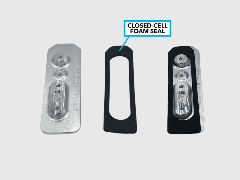

Both the OEM risers and our wing delete use a closed-cell foam seal that compresses between the hatch and the base of the riser. This is a proven sealing method that works with the thickness and variability of the factory plastic.
A flush-fitting plate would require a completely different sealing method, and any alternative would need to seal against the sheet metal, not the plastic, due to the thin outer skin and variability of the hole size.
While sealing directly to the metal could stop water from entering the cabin immediately, it would allow water to pool between the metal and the outer plastic skin. That trapped moisture would eventually:
  • accelerate corrosion
  • compromise the hatch structure
  • likely lead to water finding its way into the cabin over time

For these reasons, the PRL Wing Delete uses the same proven sealing approach as both the factory wing risers and our PRL risers. This method ensures proper fitment, avoids structural risks, and allows us to incorporate clean, attractive styling on the visible surface of the plate. It is the cleanest, safest, and most reliable way to run a wingless FL5. With this design, you get the look you want without compromising the integrity of your hatch or the longevity of your car.
