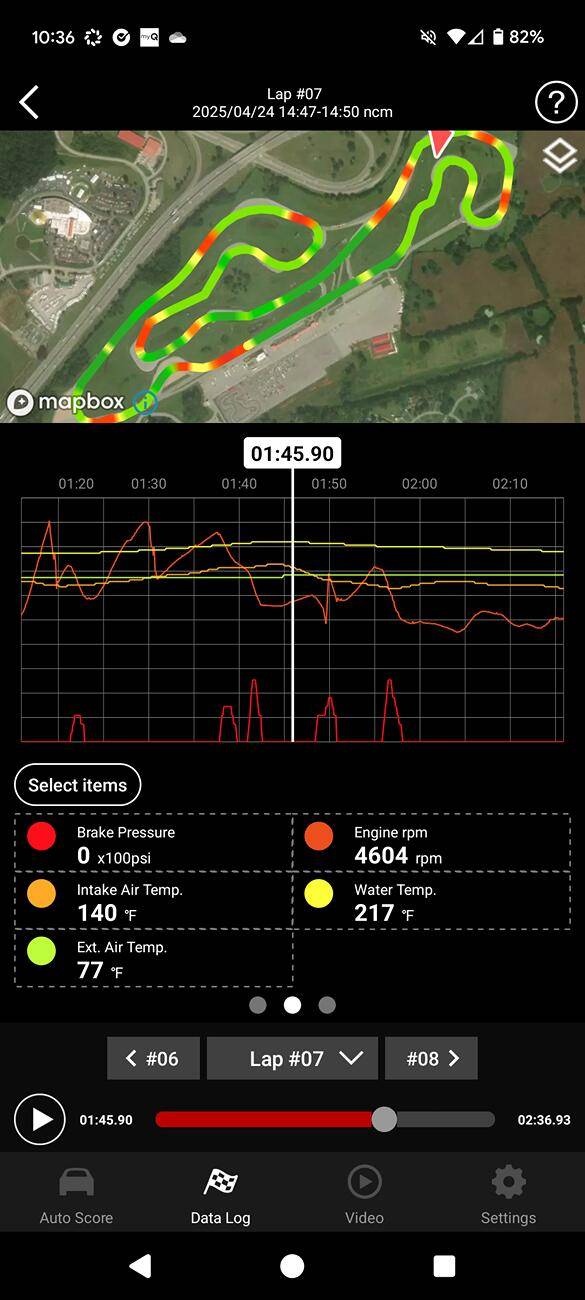

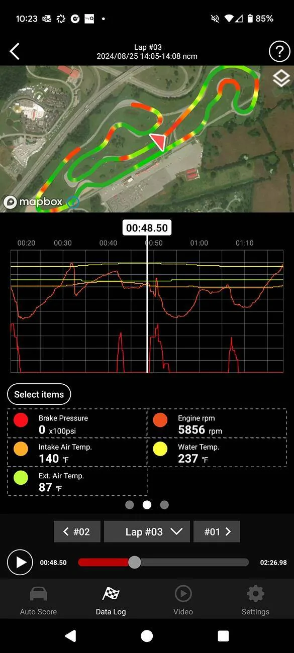

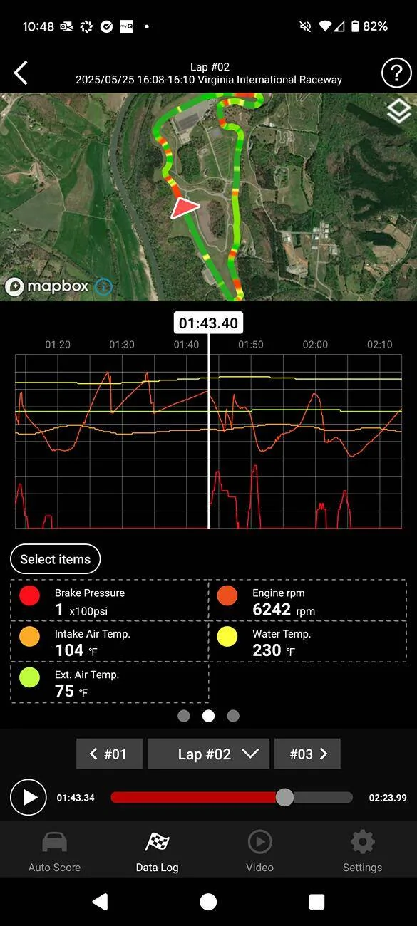

A few data points. Heat has to go somewhere. IAT are rock solid at 100-105 degrees all day.
Stock IC and Stock Radiator temps:
11th Gen Honda Civic All the Available Aftermarket FMICs are Bad NCM Stock IC Stock Rad
Stock IC and triple pass radiator and WOT cooling plate:
11th Gen Honda Civic All the Available Aftermarket FMICs are Bad NCM Stock IC and Rad
Wagner IC and triple pass radiator and WOT cooling plate
11th Gen Honda Civic All the Available Aftermarket FMICs are Bad VIR Wagner and Rad

Wow.... that Wagner while sacrificing a few degrees in water temp, really helps with IATs.
Thanks and I am curious...Were those logs recorded while also using the OEM downpipe and OEM turbo/downpipe shielding?
