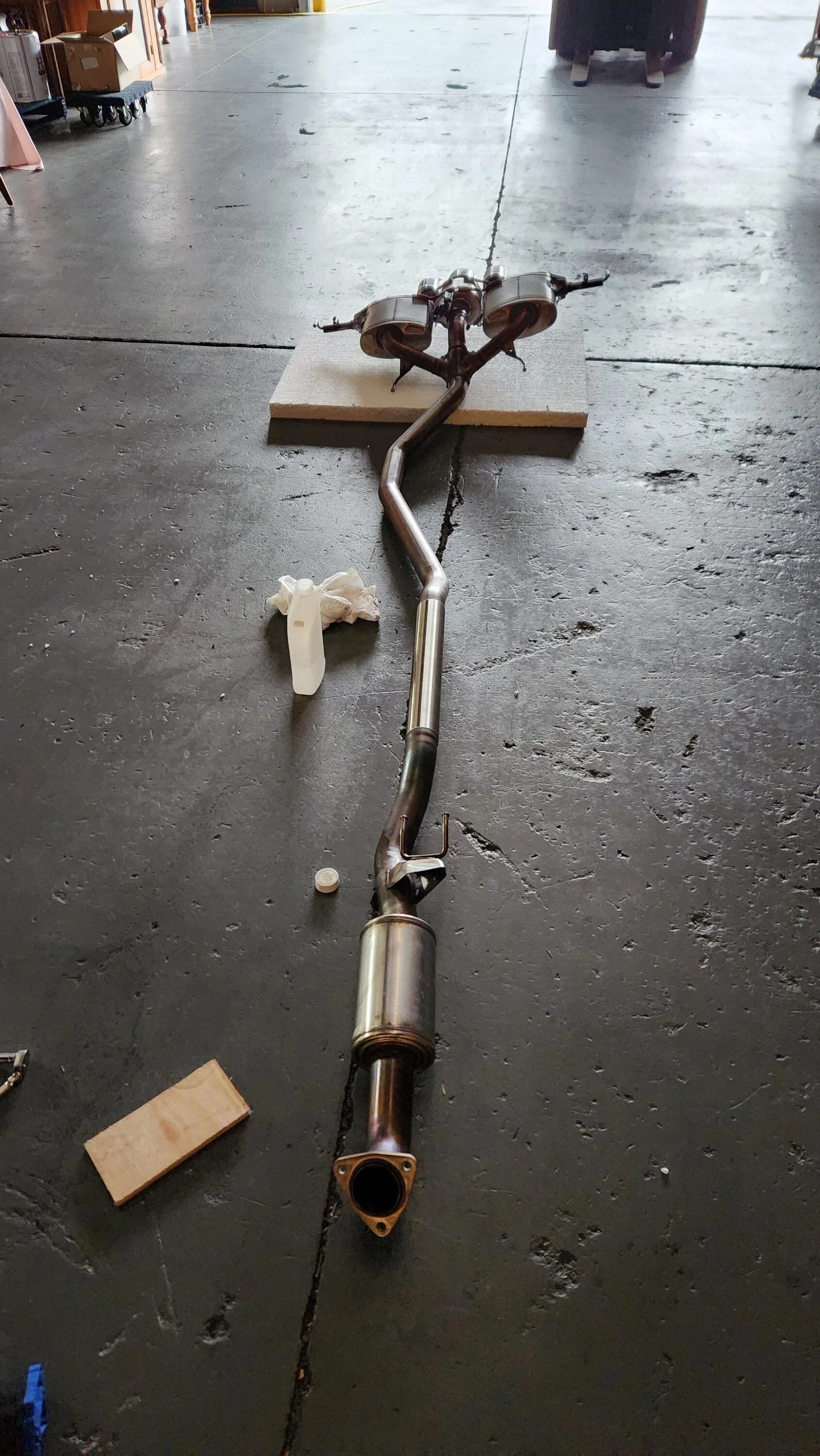

Videos of my FL5 with the large res deleted and fuse mod done (all other mufflers/resonators in situ)
This gives you the "noise" of the ITS however doesn't provide the programmed crackles in Sport Mode which is from the ECU ignition/fuel mapping.
I would imagine deleting the smaller res (closer to the front pipe) and keeping the larger res would result in a milder/quieter noise output.

What is the drone like with the large resonator delete? That would be my main concern with this mod.

It’s honestly not that bad little to no drone and I have the active valve open, so I’m sure with the active valve how it comes oem it’s even less

I deleted the same thing and have the valve open as well ever thought about deleting the front one too??
I have - however I fear it will be too noisy for daily duties/conversing with my passengers :D
Its IMO right on the limit of acceptability for me. When I'm by myself in the car its fine, I would even like it to be louder at times - however with passengers trying to conversate I do find myself finding a higher gear on the regular. But I would say the noise/drone level be no worse than any available exhaust system on the market today..
On the highway going 100-110km/h in 6th gear its no problem at all. Very quiet.
The main resonance occurs on the overrun at around 3-3.5K rpm where the noise *could* be considered irritating at times.
I should try to refit the exhaust flap fuse to see if it will eliminate that resonant reverberation.

I tried it with the fuse back on the and it quiets it a lot but I wish in R Mode it kept it open so I wouldn’t have to be pulling the fuse everytime I want it louder lol

is it kind of too loud with the fuse out and too quiet with the fuse in? maybe removing both resonators with the fuse in might be the answer

here’s a sound clip middle resonator delete open valve mod
