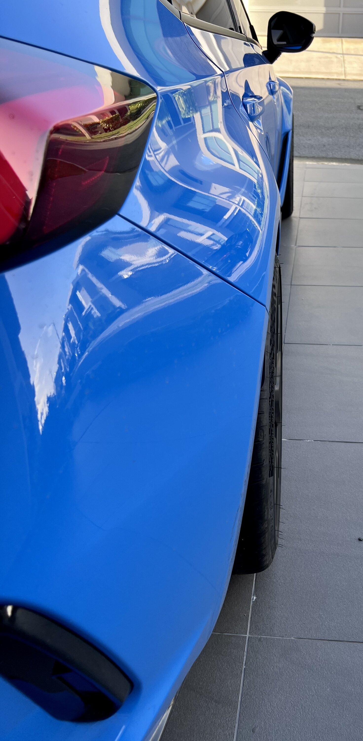

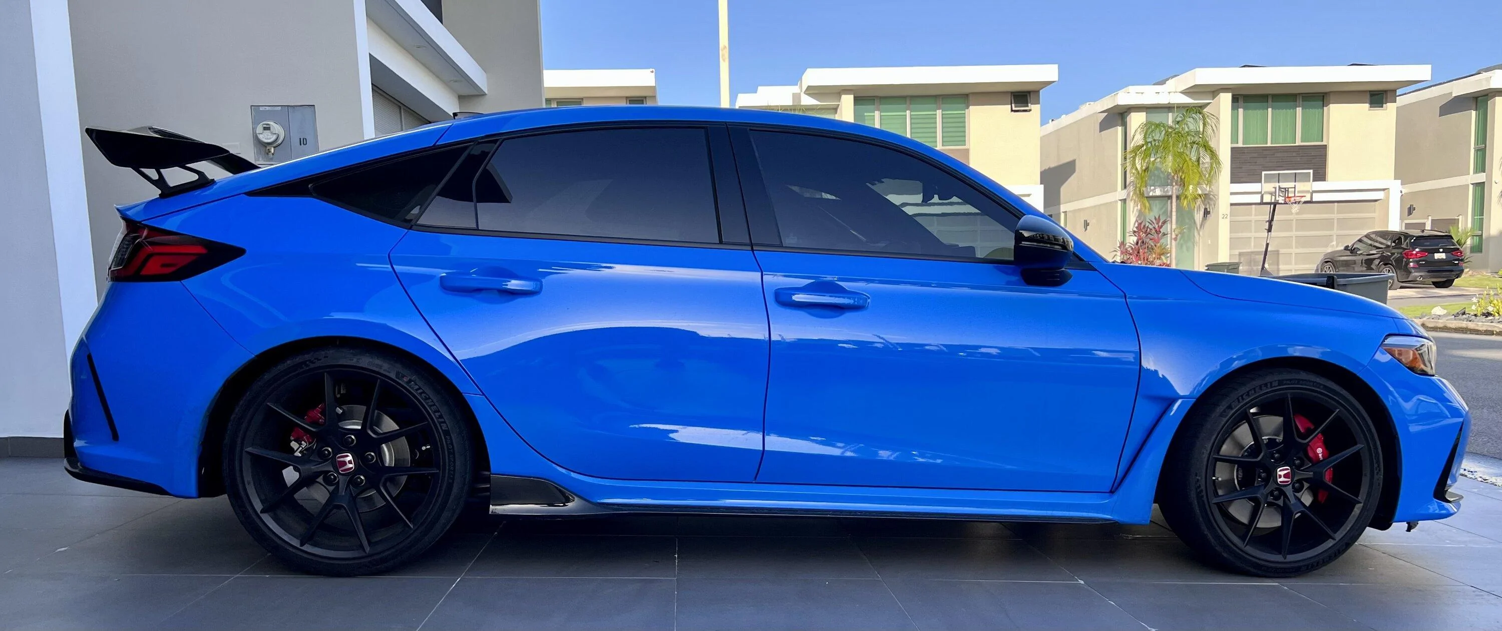

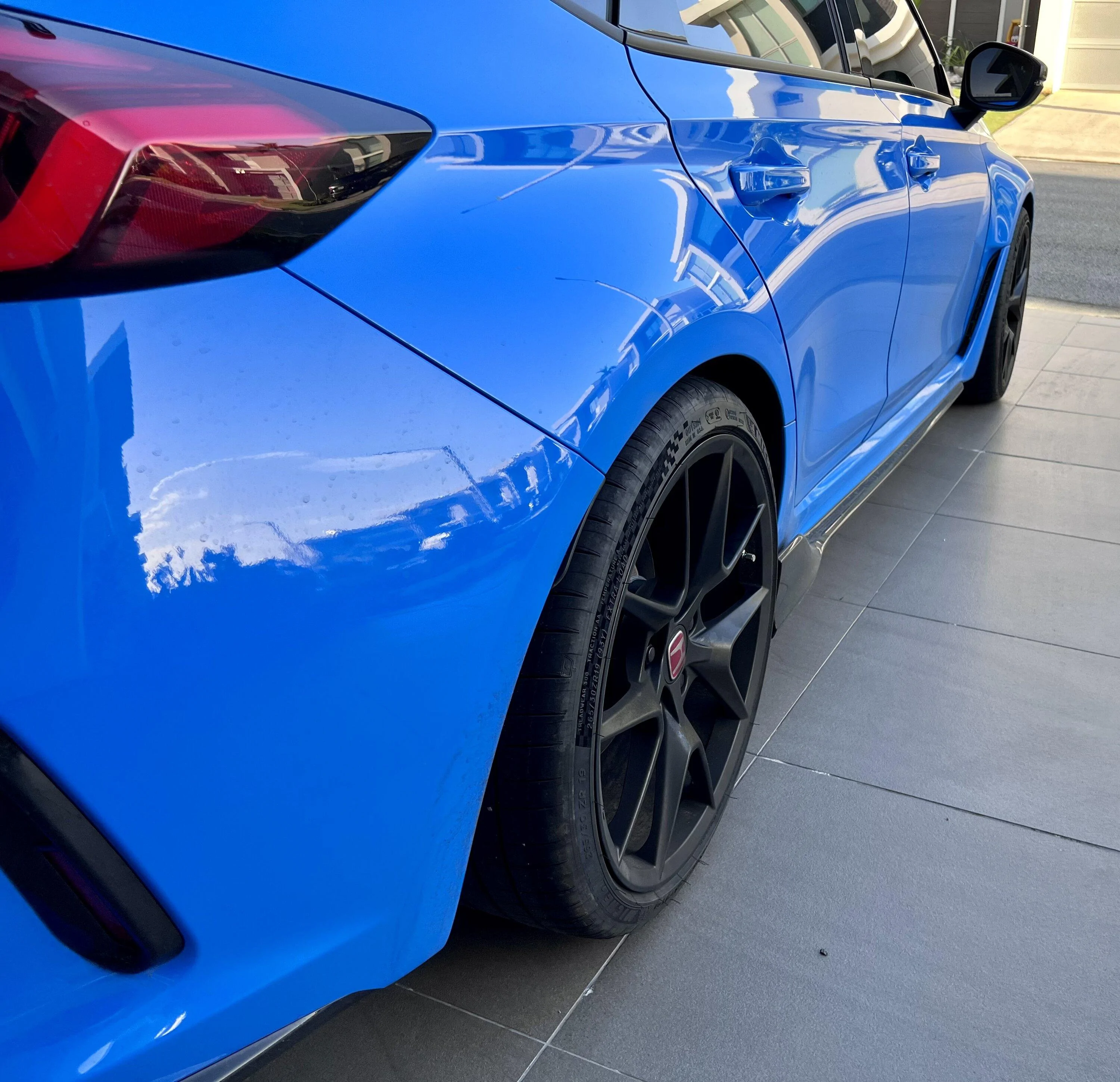

1. Year and model:
2. Wheels/offset:
Front: 19x9.5 OEM Matte-Black Alloy, ET +60
Rear: 19x9.5 OEM Matte-Black Alloy, ET +60
3. Tire size:
Front: Michelin Pilot Sport 4 S 265/30ZR-19
Rear: Michelin Pilot Sport 4 S 265/30ZR-19
4. Suspension:
Stock soon to be Spoon Sports Progressive Spring
5. Wheel Spacer Brand and Size:
Front: Bonoss 20mm
Rear: Bonoss 20mm
6. Clearance (i.e., Does it rub? If so, when?)
No rub at any angle
7. Wheel Studs
Front: Stock
Rear: Stock
No need to cut stock studs.
8. Insert photos
11th Gen Honda Civic The FL5 Civic Type R Wheel Spacer Reference Thread IMG_5058
11th Gen Honda Civic The FL5 Civic Type R Wheel Spacer Reference Thread IMG_5057
11th Gen Honda Civic The FL5 Civic Type R Wheel Spacer Reference Thread IMG_5060
