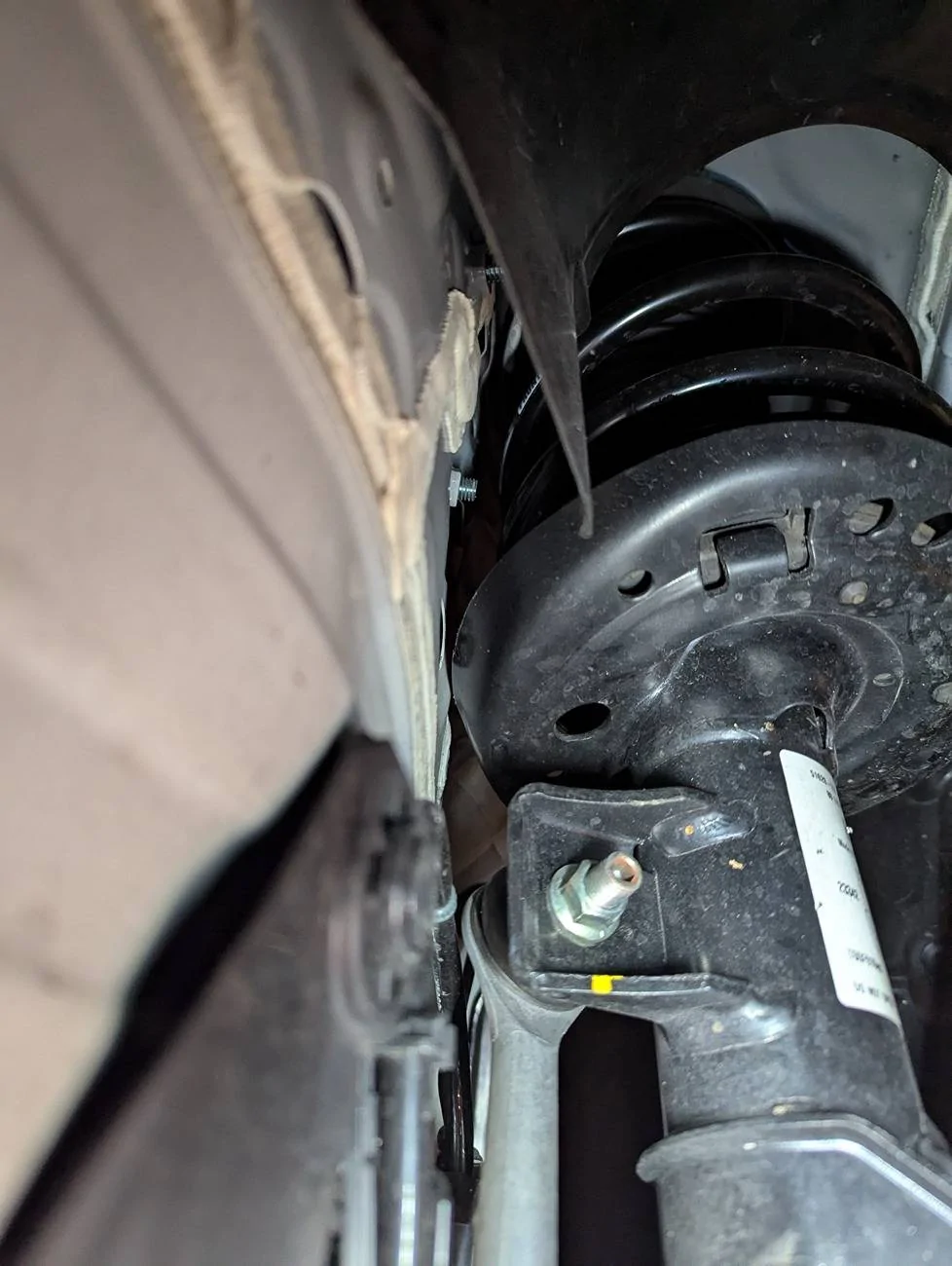

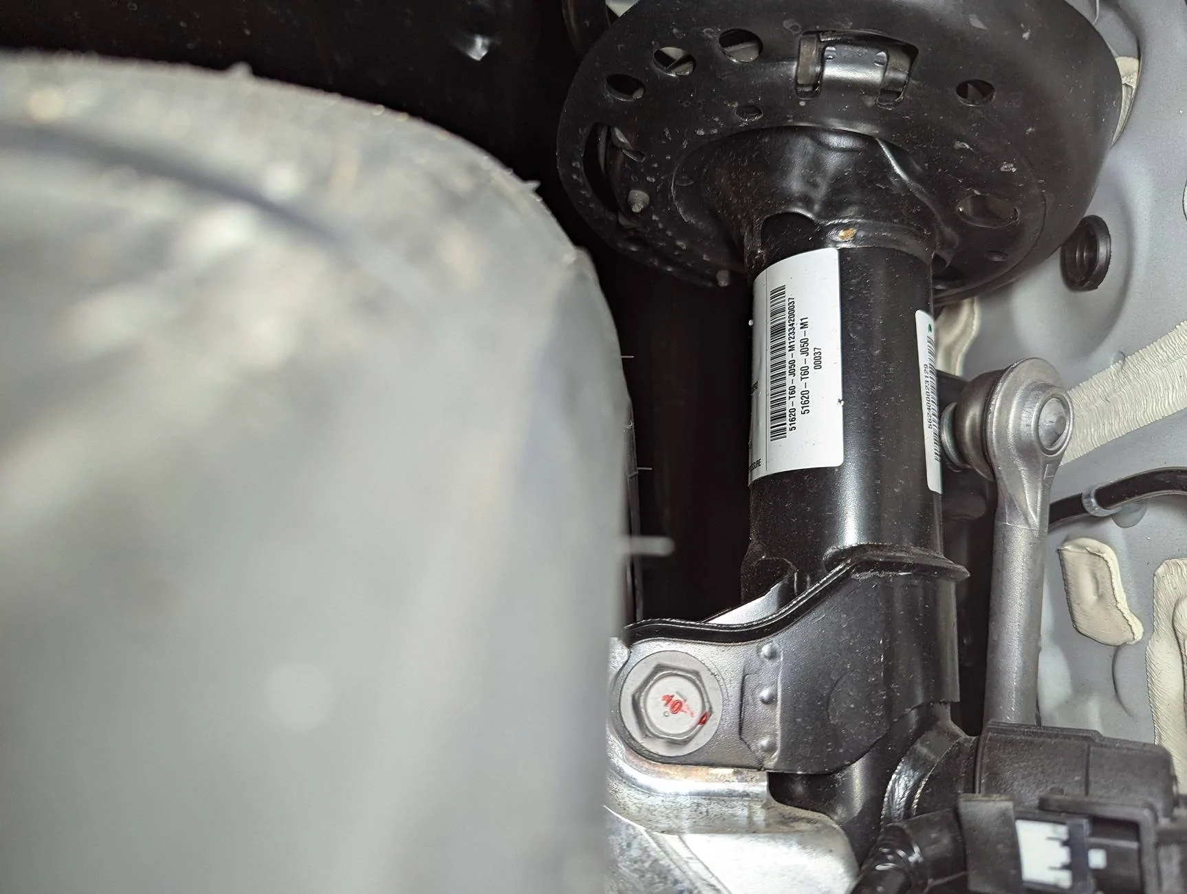

~-2.5° *, I can't get more than that or the lower spring perch on the factory strut will contact the chassis, but yes it worked on stock suspension as well (with the pins pulled, so probably ~-1.9°) likely helped by the larger wheel gap.
11th Gen Honda Civic *The FL5 Track Junkie Thread* 1000018449
Camber plates should be better for tucking the tires though as they pull the top in vs. ball joints pushing the bottom out, so keep that in mind.

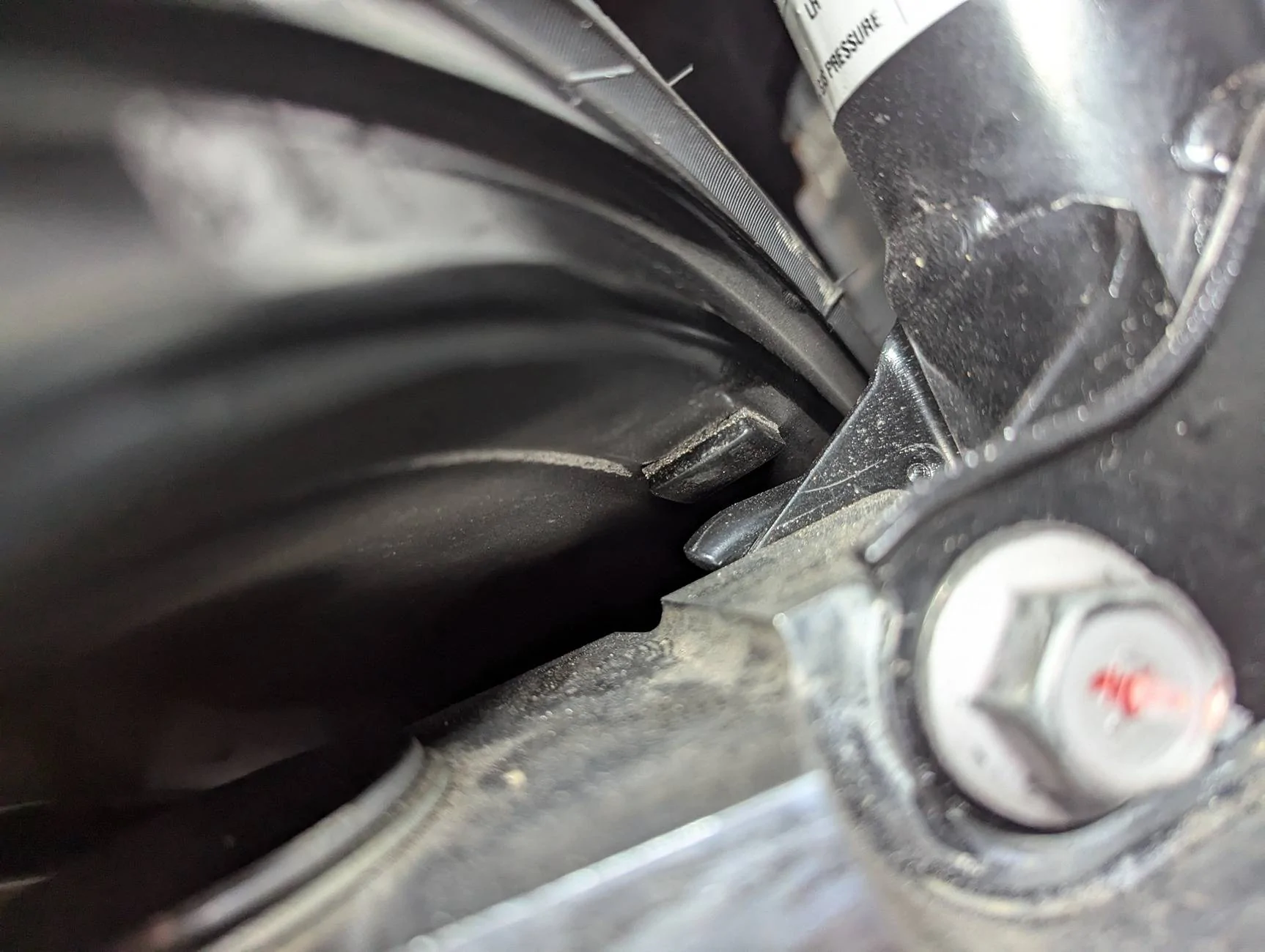

I should be able to get some decent photos from underneath if I can get the car on to the alignment rack. I guess I'll grab a Hoooooozur too to mount on the rim.
The wheel articulates closer to the strut at full lock than you would expect based on the wheel being straight ahead, which is where the strut ears come into play.

I've been told that coilovers could be problematic due to the lower spring perch height being different, but given that this wheel spec doesn't really move the wheel significantly inboard vs. the factory wheels I'm not sure if that's a real issue or not, as coils likely wouldn't work on stock wheels either if that were the case.
interesting....I don't think the ball joints move the strut that close to the chassis. I assume coilovers, being thinner, wouldn't have this issue and you can get more camber from the top
That's not surprising since the ball joints move the bottom out instead of moving the top in, so I'd expect better chassis clearance at the same camber. And yes, I would not expect this issue on coilovers as the spring and perch will be much narrower. However, camber plates are better for fitting wide tires, because you are moving the top of the tire inboard allowing for more fender clearance (without sacrificing any shock-to-tire/wheel clearance).
