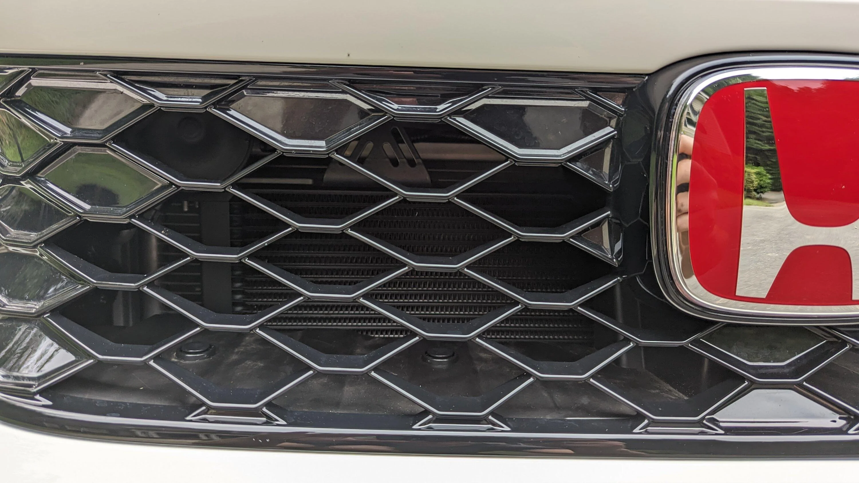

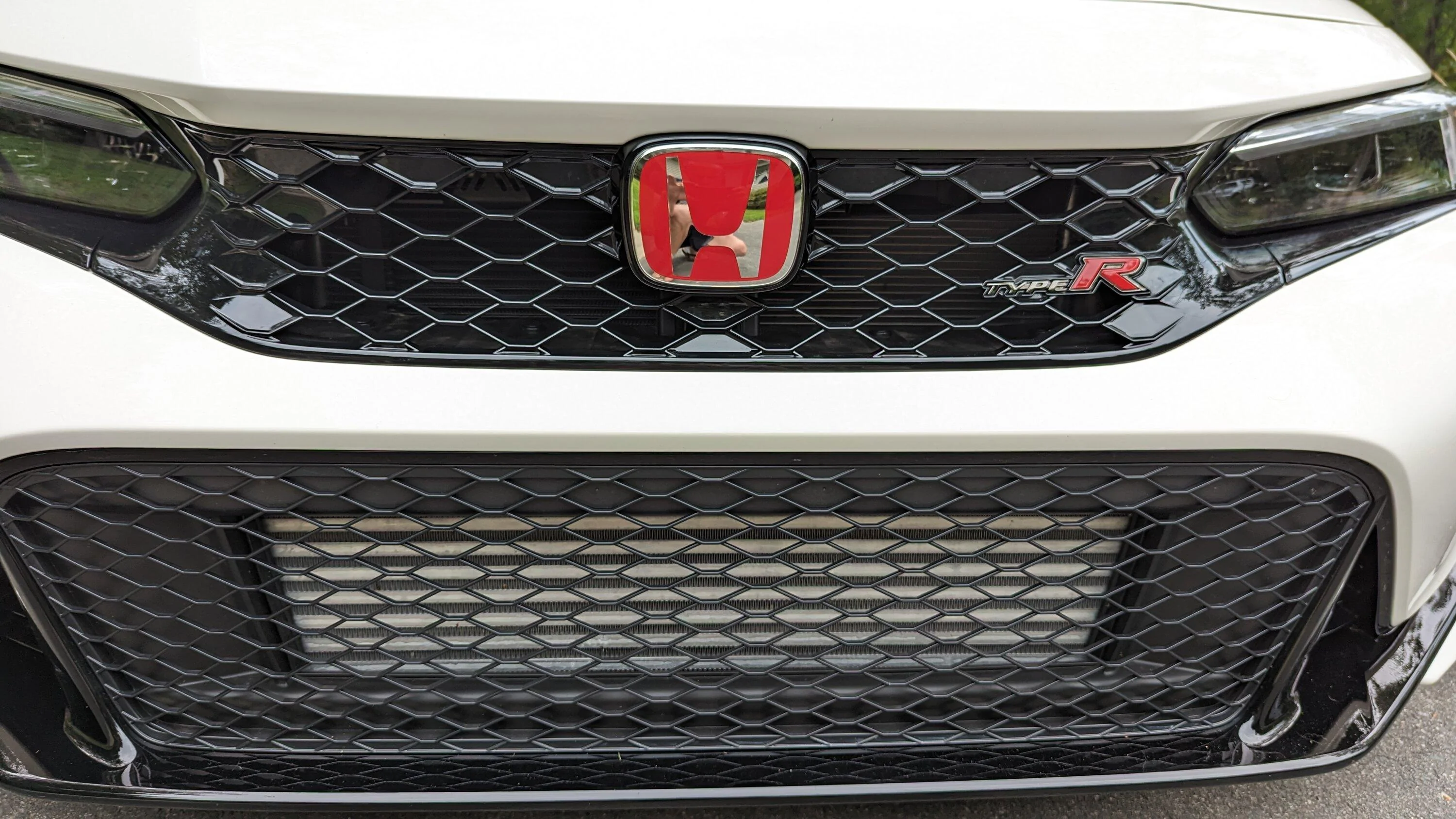

So just a quick update! I spoke with Conner over at HEL this morning, and I should be receiving a second bracket in the next few days to modify and return to them. I'll be sure to take my time with the modifications to ensure that all of us USDM folks get a quality bracket that will work with our cars. Drilling into the crash bar will be required, but at the end of the day...that's not really a big deal. I also expressed to Conner that the longer of the two -10AN hoses has the potential to rub against the frame where it cuts through into the engine bay, and he is going to send me a few different samples of weather stripping to attach to the frame, which will ultimately be included in the kit. So far I haven't had any issues with that because I've wrapped that section of hose with a thick piece of DEI heat shielding.

Good plan. I'm sure once I send everything back they'll then be able to start production on the new brackets and get them out to the affected customers.

Quick update guys! HEL have received back the bracket that I modified for them last week! I've been monitoring the hoses and found that the short hose has been chaffing against a sharp bracket on the a/c compressor. I've informed the guys over at HEL and requested the short hose 3 inches longer, which I believe will completely solve this issue!
