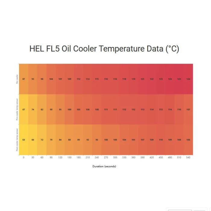

Just posted this in another thread, but the image belongs here too. This is the data sheet for HEL Performances testing with and without an oil cooler. If you'll notice, after 2 minutes (without oil cooler) the oil temperature is at the maximum that the vehicle reaches at 9 minutes (with oil cooler)

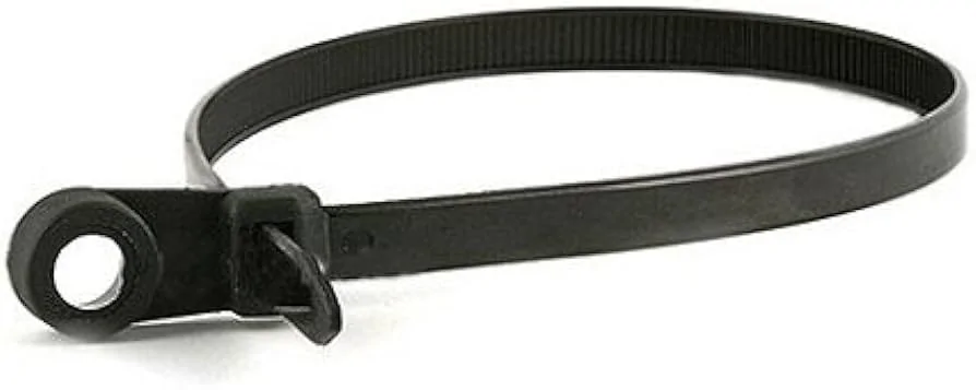

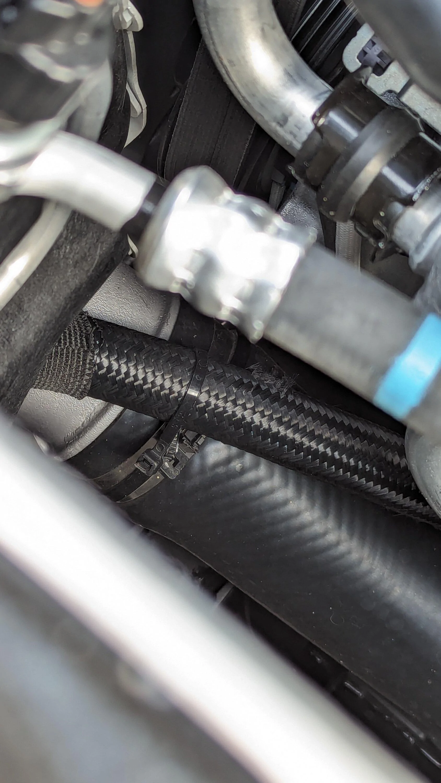

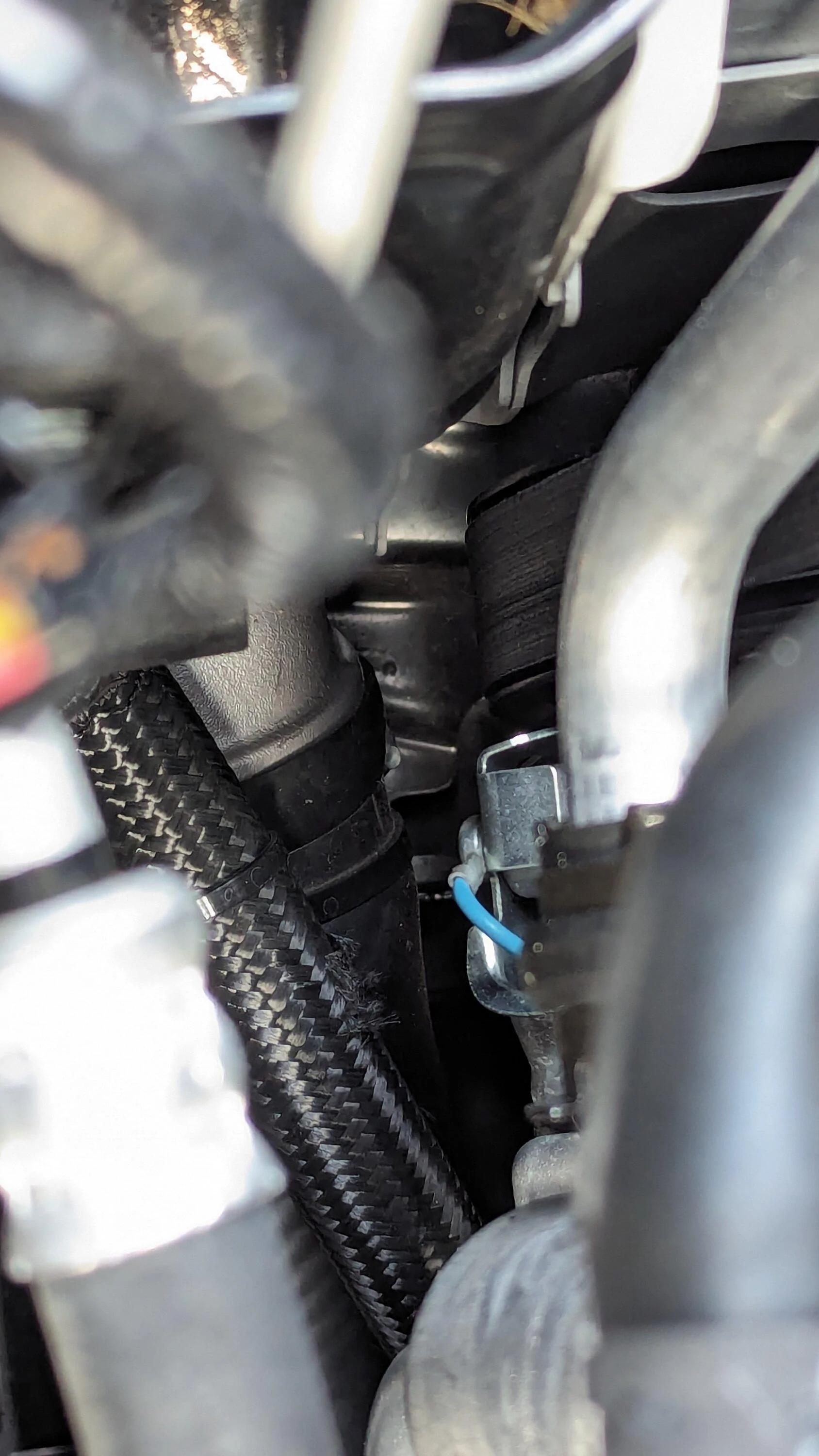

With group buy's taking place, and several other members purchasing the HEL Oil Cooler Kit, It's come to my attention that the instructions really haven't been updated, and they're still in black and white. VCD Racing recently contacted me for some pointers during their installation process. I'm available to assist should any of you run into any snags. You can obviously reach me here if need be, but I'm also on Instagram if you'd prefer to message me (I respond faster) @PointByPatrol.
The drill size that I used was 17/64th's. You can go one size smaller.
You do not use the half inch spacers. (those are for steel crash bars)
I added additional padding to the long hose where it goes through the back of the fender well. The frame through that area has a sharp edge, and I didn't want to run into problems down the road. I used DEI velcro heat wrap and zip tied it to the hose.
You will need to purchase zip ties that look like this (roughly 8-10 inches long, and you'll only need one) This is to secure the short hose away from the drive belt, by securing it around the hot side intercooler pipe. You then use a normal zip tie and zip tie the hose through the whole in the special zip tie pictured below:
I've also attached two photos of the short hose zip tied to the intercooler pipe to show how I did it.
