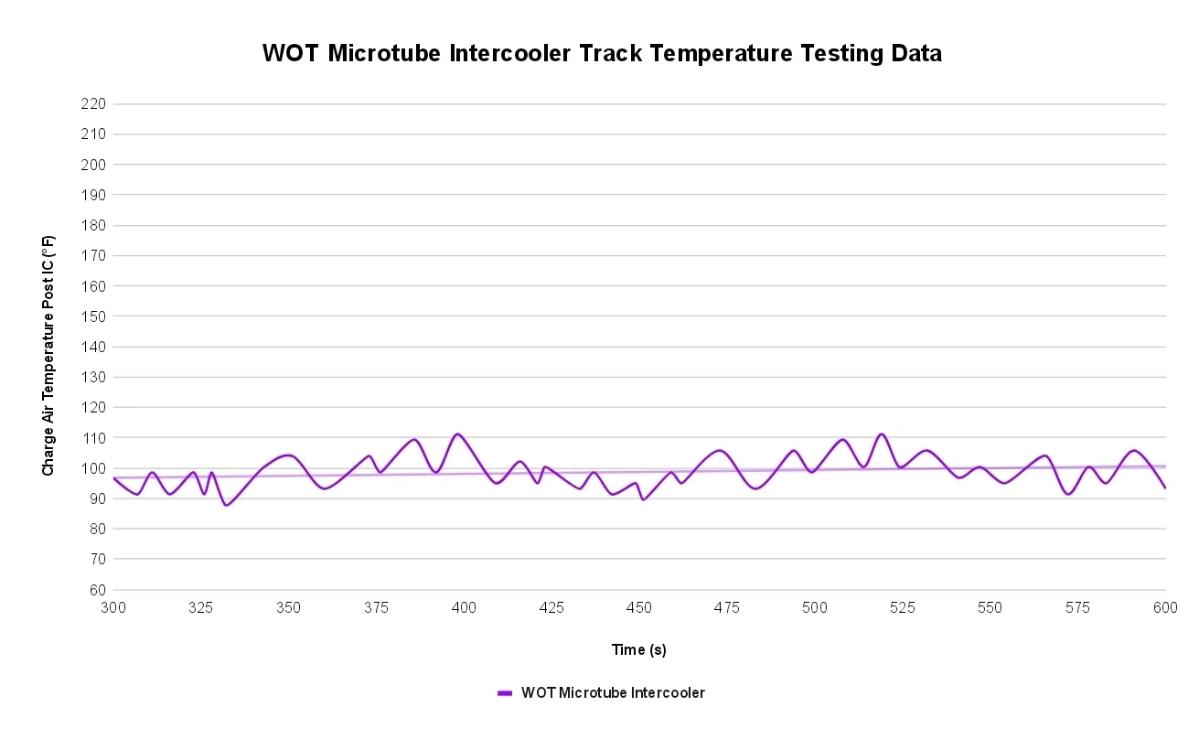

WOTs freer flowing micro tube Intercooler and PWRs (3.43”) noticeably thinner then the average aftermarket intercooler core (4.25” +) seem to help keep engine temps down according to their track data.
J’s Racing and HKS happen to be near the middle of the thinner cores and the industry average at (3.94”).
Like you said tho, does that 10%/0.3”-0.4” thinner/thicker core make that big of a difference with radiator flow vs IAT temps…

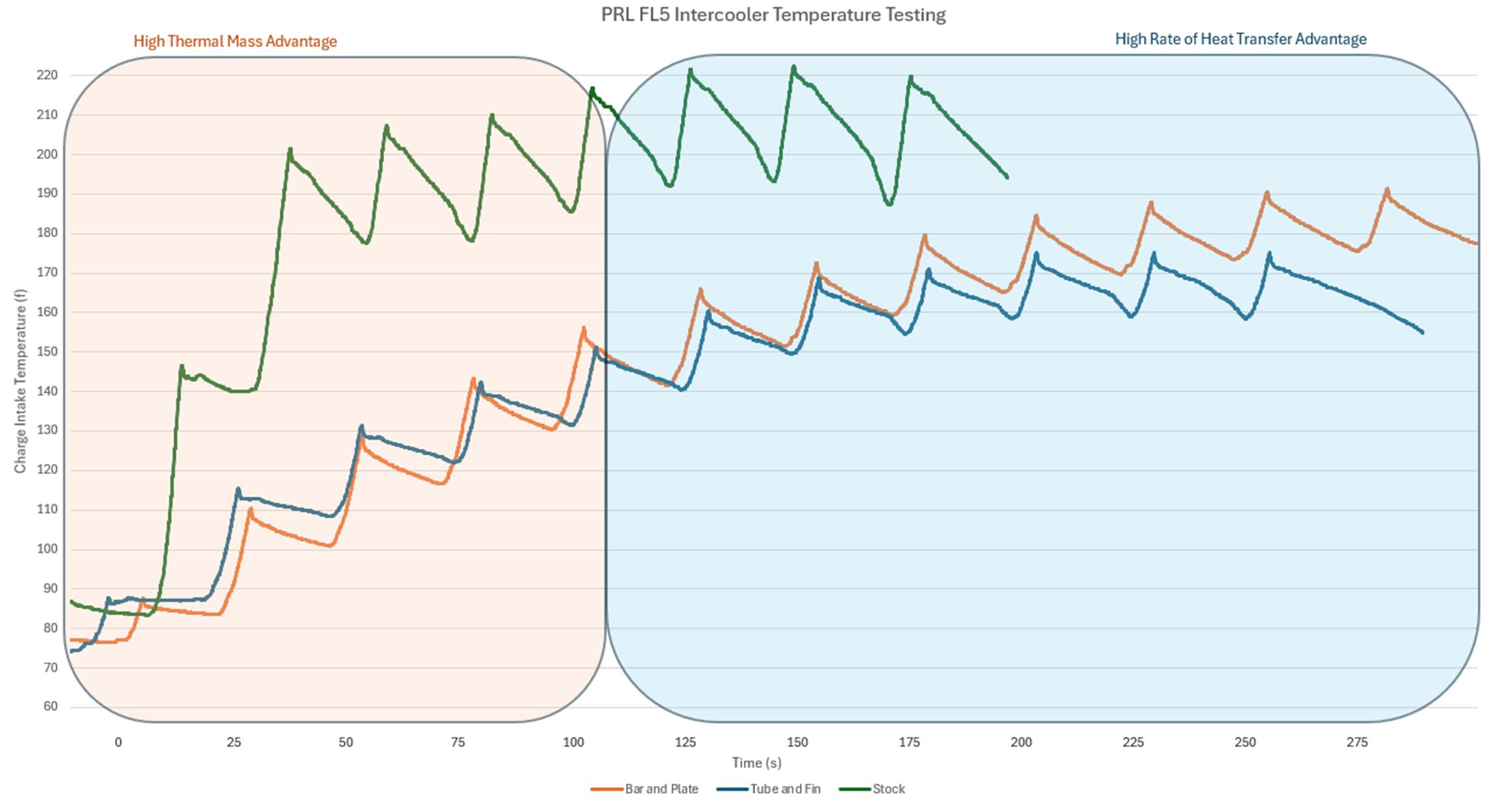

This chart shows where the bar and plate is better vs when the tube and fin is better:
- Bar and plate wins in a situation with 4 or less long back to back pulls (most street or drag applications)
- Tube and fin wins in a situation with 5 or more long back to back pulls (most circuit track applications)
11th Gen Honda Civic FL5 Intercooler Reference Thread image_4
If you have any specific questions about the core, @PRL Motorsports may can chime in and help answer them.

Note that this is not an updated intercooler, it's a separate SKU and does not replace the bar and plate unit. Both will continue to be available.
Thanks...What about heat soak (e.g., sitting at a traffic light) and thermal recovery? The updated PRL intercooler would fare much better in that situation.
