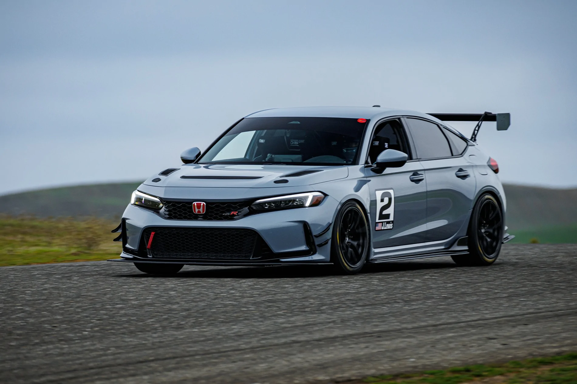

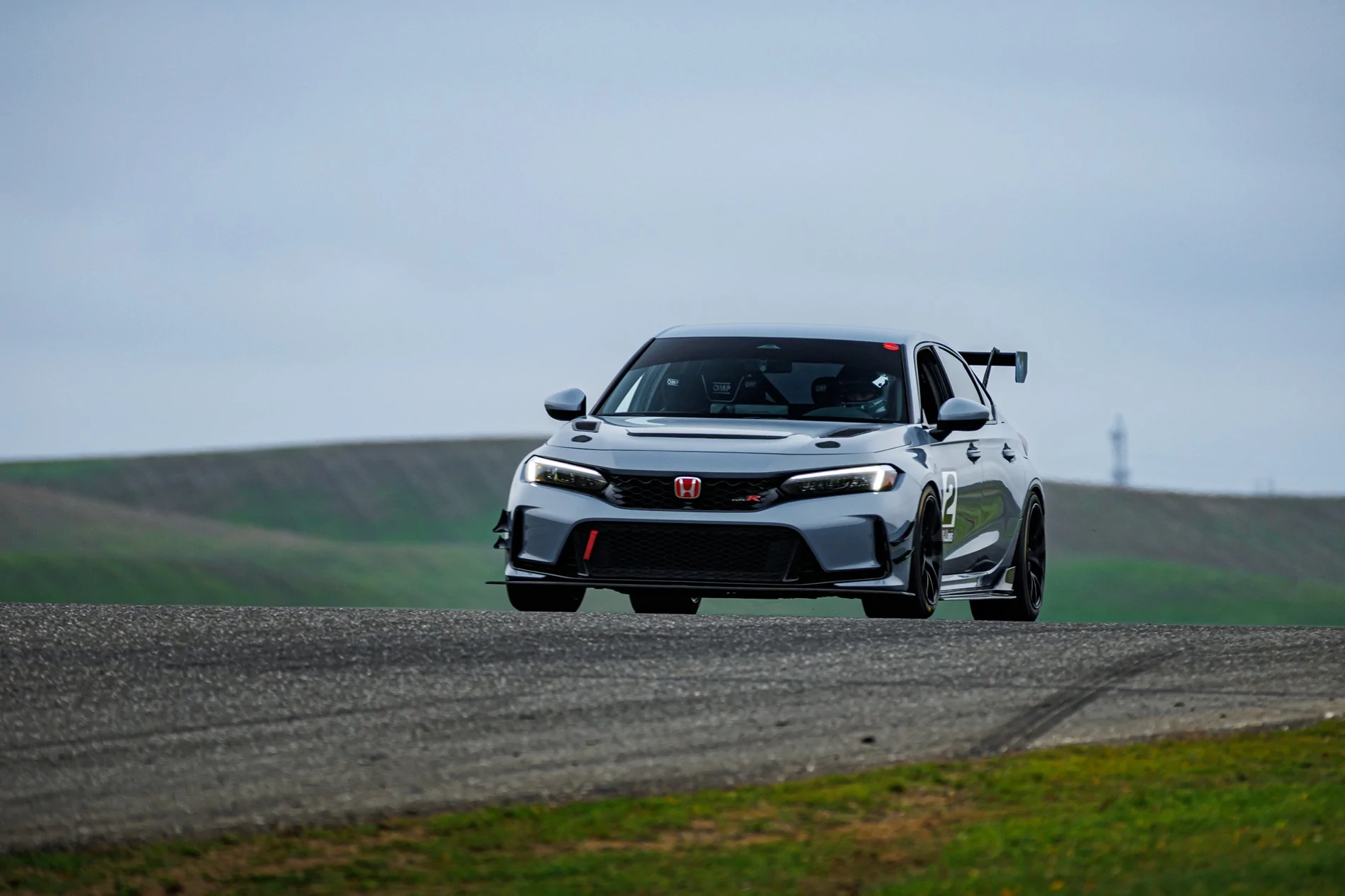

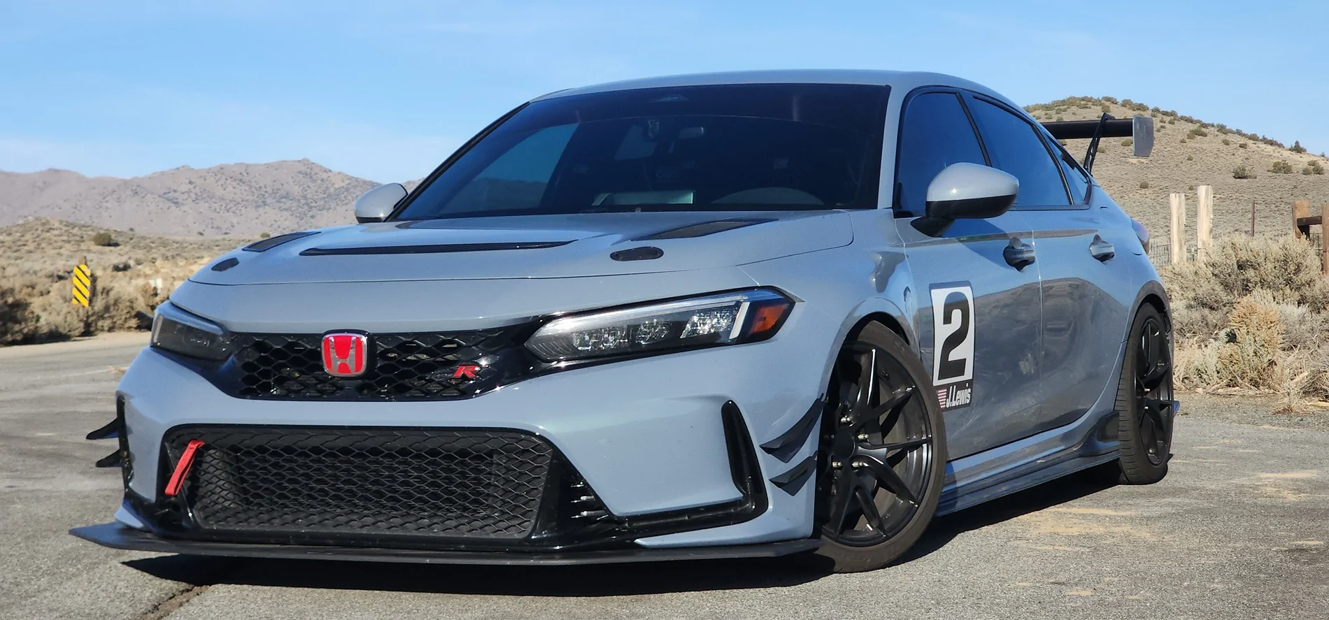

I'm obviously biased but I honestly like the look of the Microtube structure. You're no doubt fair to feel how you do however.
One option if the looks aren't to ones liking is to either powder coat or paint (Eastwood radiator paint) the intercooler. I prefer the stealth look and had mine powder coated matte black at a local shop with only a very thin coat, and applied only to the external tubes, the internal ones remain raw. Overall performance is essentially unchanged. We don't plan to offer this as an option, but rather leave it to the customer.
Here are some pictures of mine in black:

That’s fair, everyone digs different things. It just makes me lose my erection and no amount of gas station dick pills will help.

I think this should be offered as an option. My guess is more would chose an anodized black option over the natural silver option.
