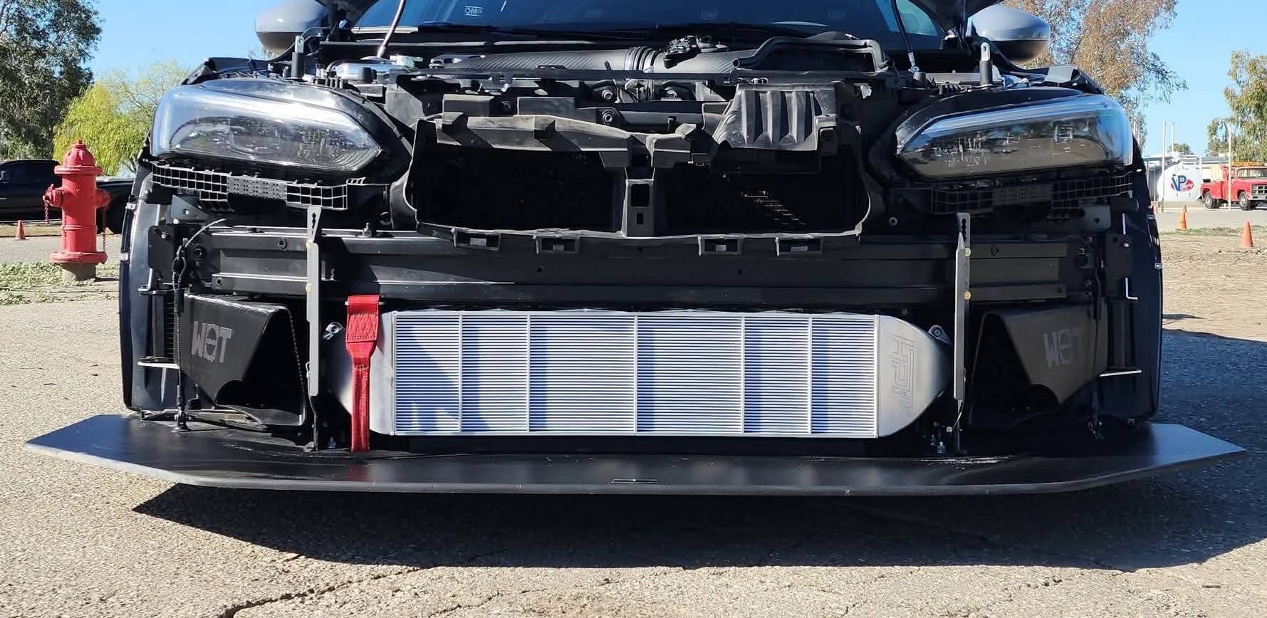

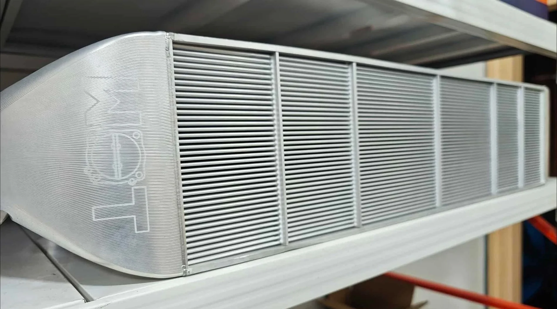

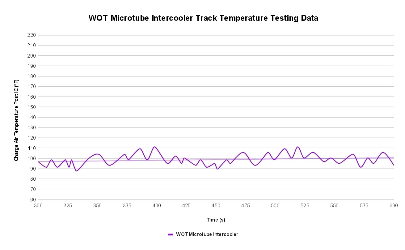

I made this post on a few Facebook group pages last night and so I thought I should share here as well.
Here's some more testing data on the WOT Microtube Intercooler.
This is a line graph showing the performance of the WOT Microtube intercooler when tested a couple weeks back on the track at GTA Finals at Buttonwillow Raceway. The ambient temp during this session was 74°F. The car is making approx 500whp pushing 30psi with the MHI turbo. The data shown is actually the second 5 minutes of my session, from 5-10 minutes. I figured why not show everything when it's really had a chance to be pushed and fully heat soaked. If it can win with this disadvantage that's all the more impressive. Couple that with the power the car is producing and this is a real stress test for the microtube IC.
You'll see that the trend line hovers right around 98-100°F, with a few peaks getting up to 110°F. The graph isn't uniform because the demands of the track are fairly random when it comes to looking at them on a graph. What is nice though is this is real and hard data in the setting we all hope to have performance at: on the track, with real load, with real drag and air flow, and in a truly dynamic setting.
What isn't shown on the graph is the extremely impressive coolant temps to go along with these great post IC IATs. One of the major benefits of the microtube structure is the air flow it provides the lower half of the radiator helping it to function at a much higher level of efficiency (max coolant temp of 204°F in this session), to go along with the impressive charge air cooling. And this unit only weights 15.5 lbs! It really is a win-win-win.
The price of $1650 is more yes, but for that you're getting the best (and not just by a small margin). Better power, better cooling, faster times.
If you're interested in a unit shoot me a message. The December batch sold out, but the February batch still has units available.
WOT Performance - Solutions for the track, proven on the track.

Man this is awesome data. Love that you actually shared the heat-soaked part of the session instead of some perfect one-lap pull that most companies do. You didnt just run it on a controlled environment dyno. Holding IATs around 100°F on a 500whp setup is crazy good, especially that deep into a run.
The microtube airflow advantage is really showing here. Plus the thing only weighs 15.5 lbs? Hard to argue with that.
Honestly for anyone who actually tracks their car or like to push it hard, this is the kind of real-world testing that matters. No hype, just results. Makes the price make a lot more sense. Nothing is getting cheaper in the parts world. I think this is a fair price for a top quality part.
Killer work as always for WOT — February batch is gonna disappear quick maybe I will steal 1 haha[/QUOTE]
