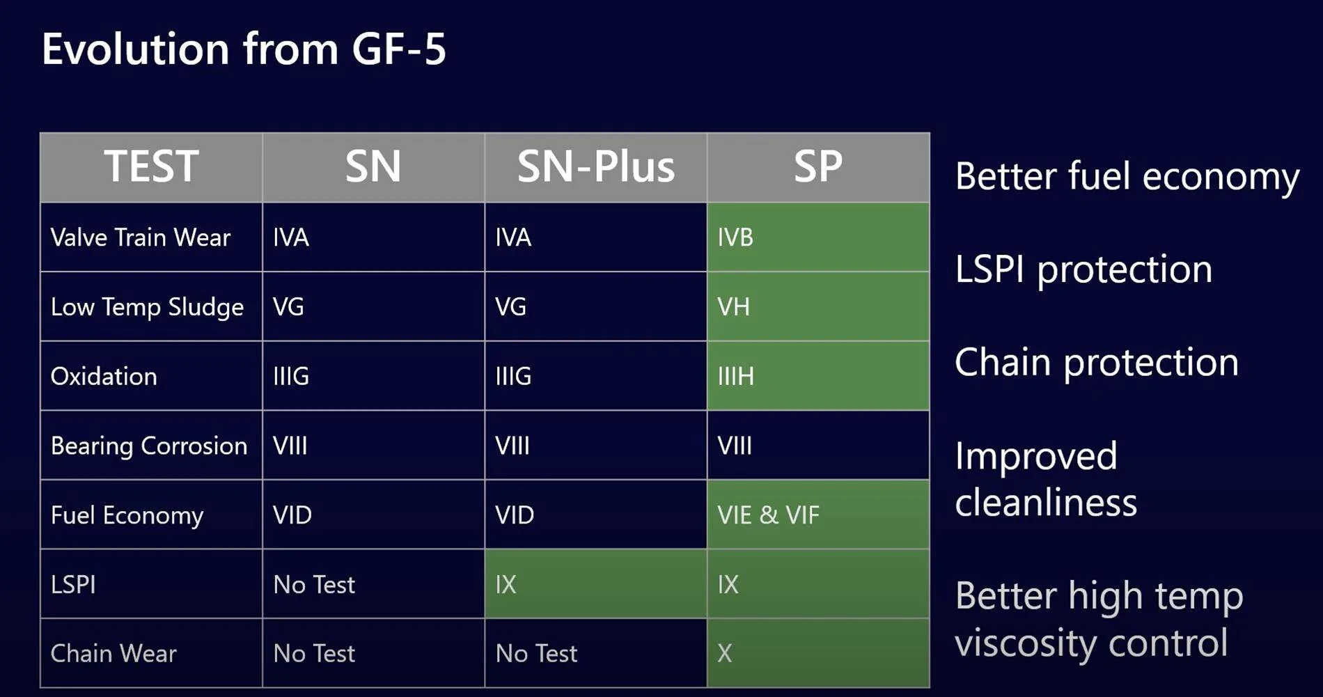

So Here is the reality of engine oils.
The FL5 Honda Civic Type Requires -- certified ILSAC-6 and API SN 0w-20 oil

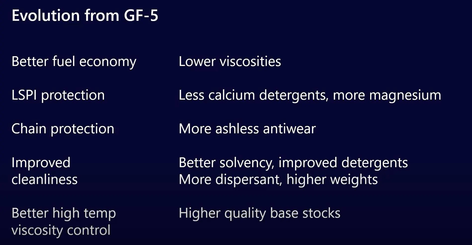

If you're picking engine oils simply on 0w-20 5w-30, your missing the reality -- That a modern high density power 2.0 turbo engine - designed for todays emission standards - has many variables in all of the mechanicals that need to be protected.
11th Gen Honda Civic For occasional track use , which oil viscosity to use? Using oil data sheet for guidance Screenshot 2024-10-11 at 10.59.23 PM
11th Gen Honda Civic For occasional track use , which oil viscosity to use? Using oil data sheet for guidance Screenshot 2024-10-11 at 10.58.45 PM
If the Formula team is running this engine with Honda 0w-20, then the holy grail of engine oil needs to perform equal or better to the Honda Full Synthetic, and that's what I will be researching in detail here.
So far... I'm leaning towards 0w-20 Castrol Edge Extended Performance that's certified ILSAC-6 and API SN.
It had better wear on startup than the Honda Full Synthetic, but then again, all the other variables in the chart above need to also be optimal for total long life engine performance.
You can put in the best oil for eliminating wear, but if it creates sludge, carbon build up, or it is too thick on startup, or too thick to easily lubricate small gaps that a 0w-20 engine is designed for... Then you don't have total protection and longevity of the the entire mechanical system.

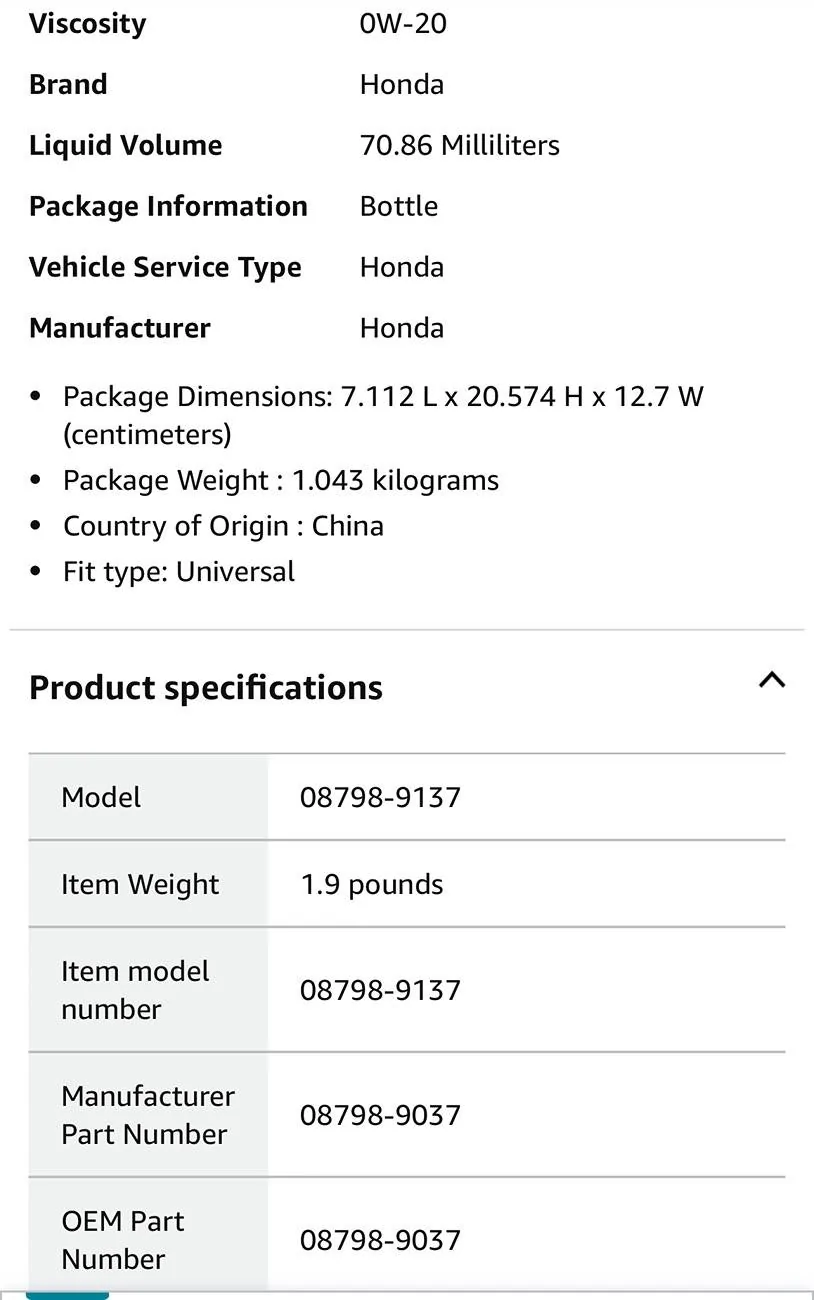

After reading all the recommendations, I am now more confused as to what oil to use. ?
Seriously though, amazon is selling the Honda 0w-20 but it says made in China. And I have a hard time trusting anything made in China. My local dealer does not sell the oem oil because they have it in bulk. Makes me wonder if they're using some other cheap oil.

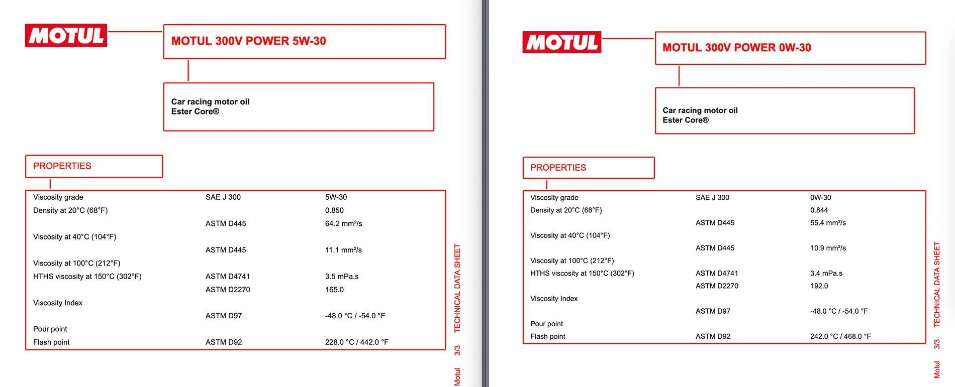

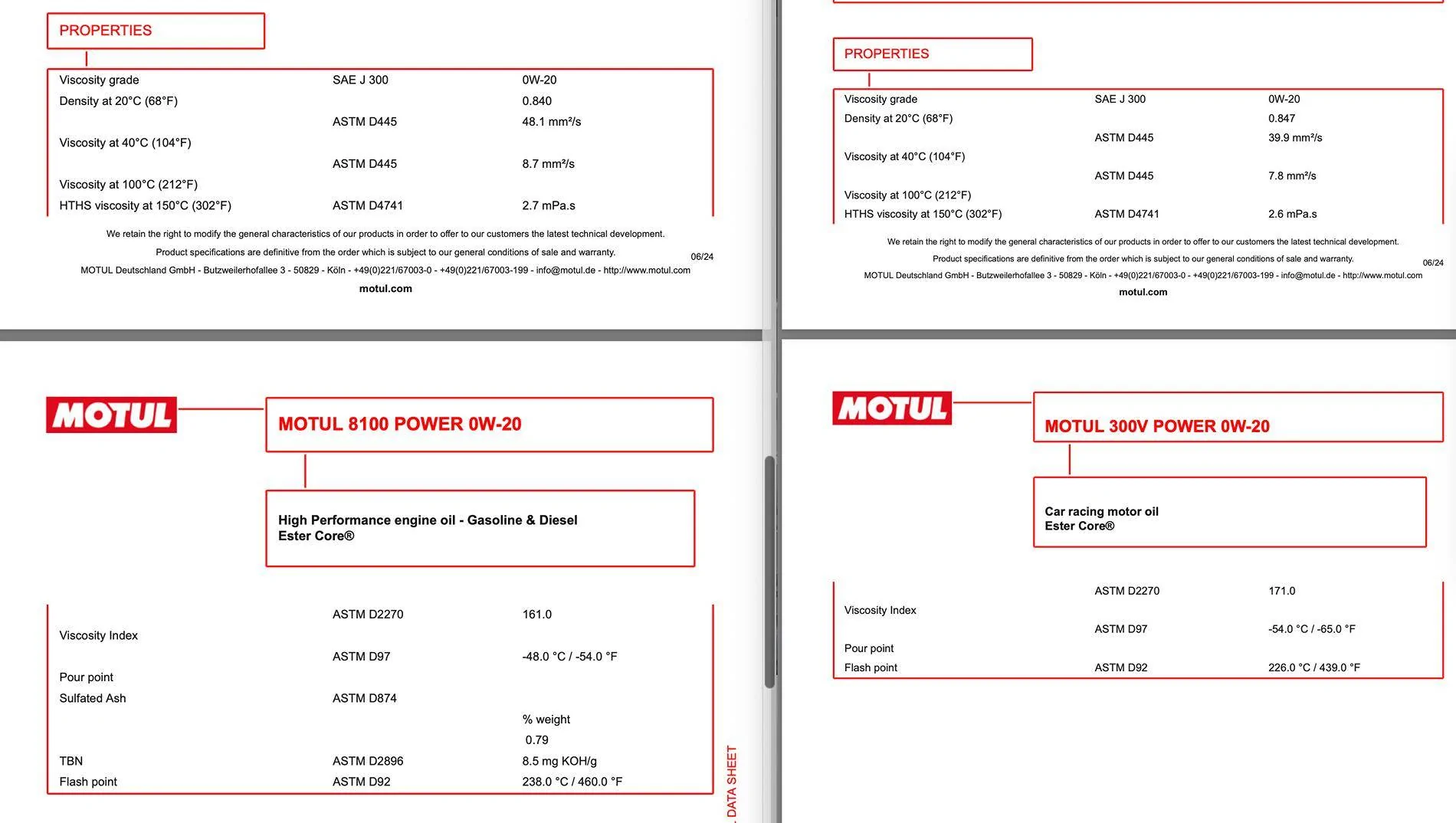

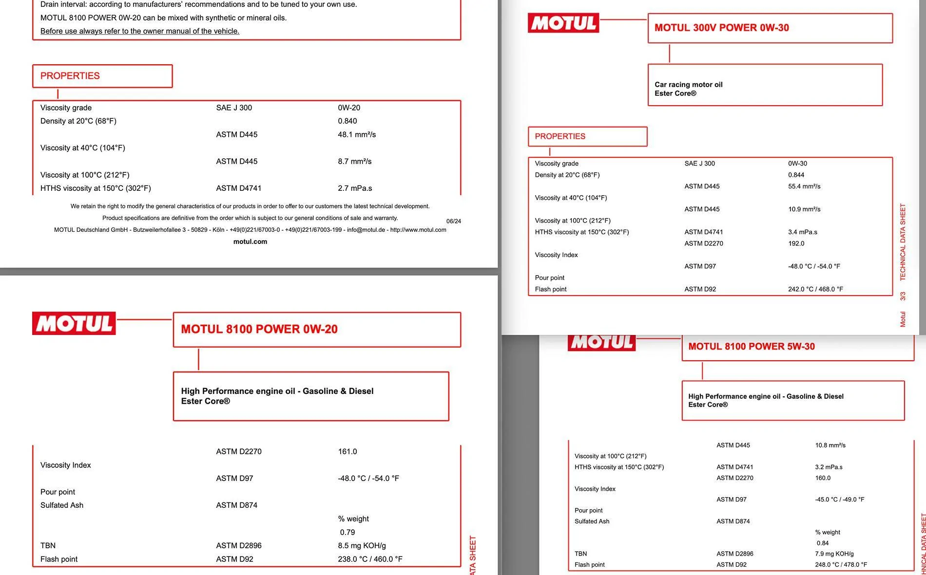

Here is more evidence to show, not all 0w-20's are similar. Here you can clearly see Motul 8100 vs v300 0w-20, the 8100 has a much higher flash point, viscosity is lower.

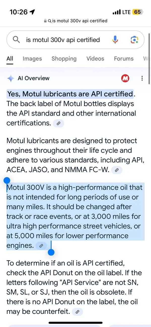

What's also interesting is, Motul v300 is a race oil that is recommended to change after every race. It is not API certified.
The Motul 8100 0w-20 is API certified - has actually a higher flash point. 460F
The Motul 300V 0w-20 is NOT API certified - has actually a lower flash point 439F
Should we be running API certified oil vs 300V, which is designed for Race built engine's that typically have lower tolerances and more gaps.
That is my understanding.
"An oil with a higher flash point could generally (though not always) be expected to be more resilient at high temps: less shear, fewer deposits, etc."
AI Overview
Learn more…
Yes, a higher flash point is generally considered better in engine oil, as it indicates that the oil will resist vaporizing and igniting at lower temperatures, making it more suitable for high-heat engine environments and reducing the risk of combustion within the engine; essentially, a higher flash point means improved safety and performance under high temperatures.
