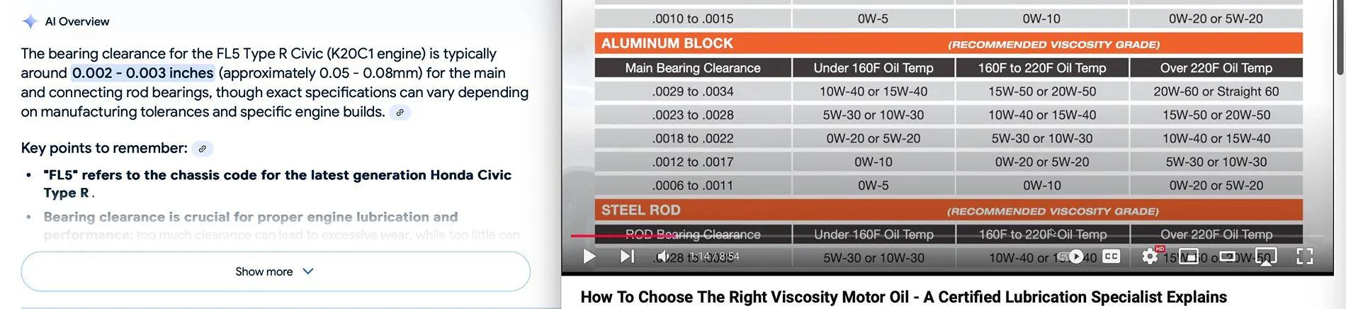

Here is the reality with Bearing Clearances - .002-.003 at different temperatures. If you're going too thick, you're not circulating oil well enough on startup to 160F. I assume this is why the 25 hour Spoon race car is running - RAVENOL REP Racing Extra Performance 5W-30

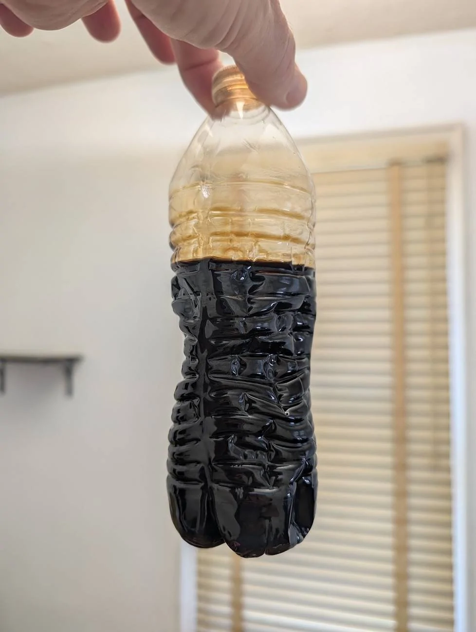

@kin0kin What color is your Motul engine oil after ~2500 miles? Can you take a picture from your dip stick?
This is what my stock honda oil looks like after 4930 miles. First oil change. No tracking of the vehicle just normal driving minus a couple of times where I was not driving normal for a minute or four possibly lol. I'm going to send it to blackstone.
11th Gen Honda Civic For occasional track use , which oil viscosity to use? Using oil data sheet for guidance First Oil Change 4930 miles
Excellent - I’m getting my oil changed at honda tomorrow - will also send it to blackstone - requesting honda ultimate full synthetic 0w-20
Curious what oil did you change fill with?

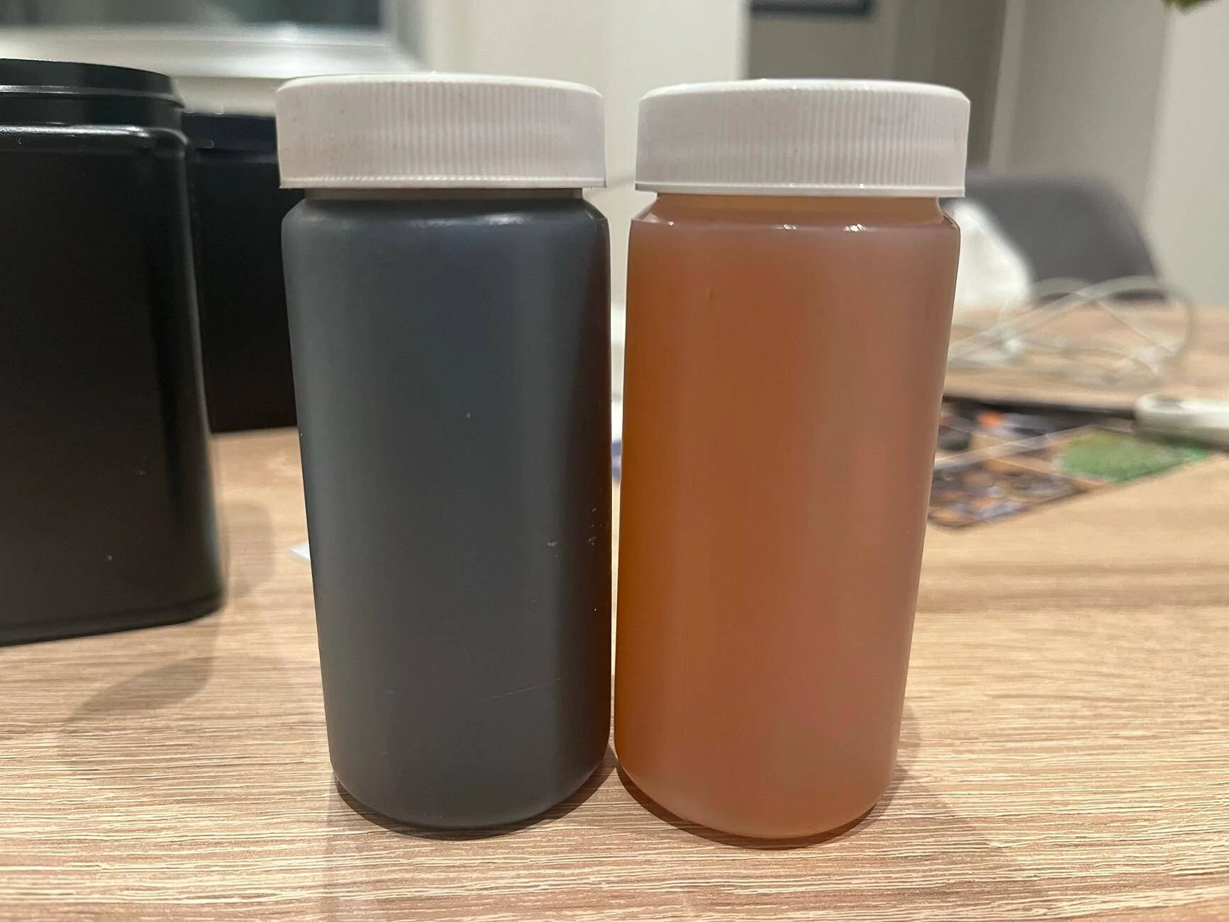

Sent my oil into Blackstone and Virgin sample of Honda 0w-20
The dealer said to expect the first factory fill with engine break in to be dirty, but let's see.
Then will run 2-3 more track days on Honda 0w-20 and then we should have a good base line.
That black one is definitely what mine looked like at 4930 miles. I'll send mine in again at 5k~ with the new fill of Honda full synthetic and see what it looks like when I pull it out. I feel like as scary as it might look, that 5k miles is the safe spot honestly for normal drivers like me no tracking the car involved. I just, would not advise pushing the oil to 10k miles if you care about the car.

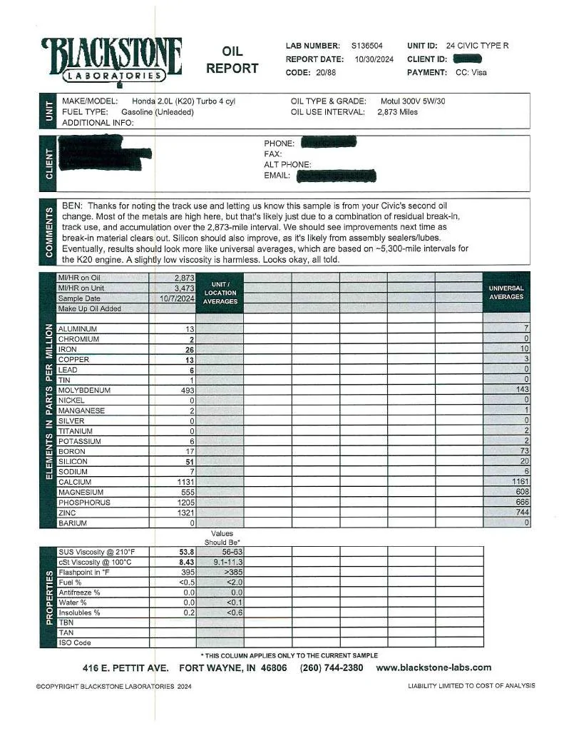

Just got my UOA. Here it is.
So your viscosity was dropping below what it should be. I received my kit from them and will be sending it in today. See what mine looks like. I'll post the results once I receive them.

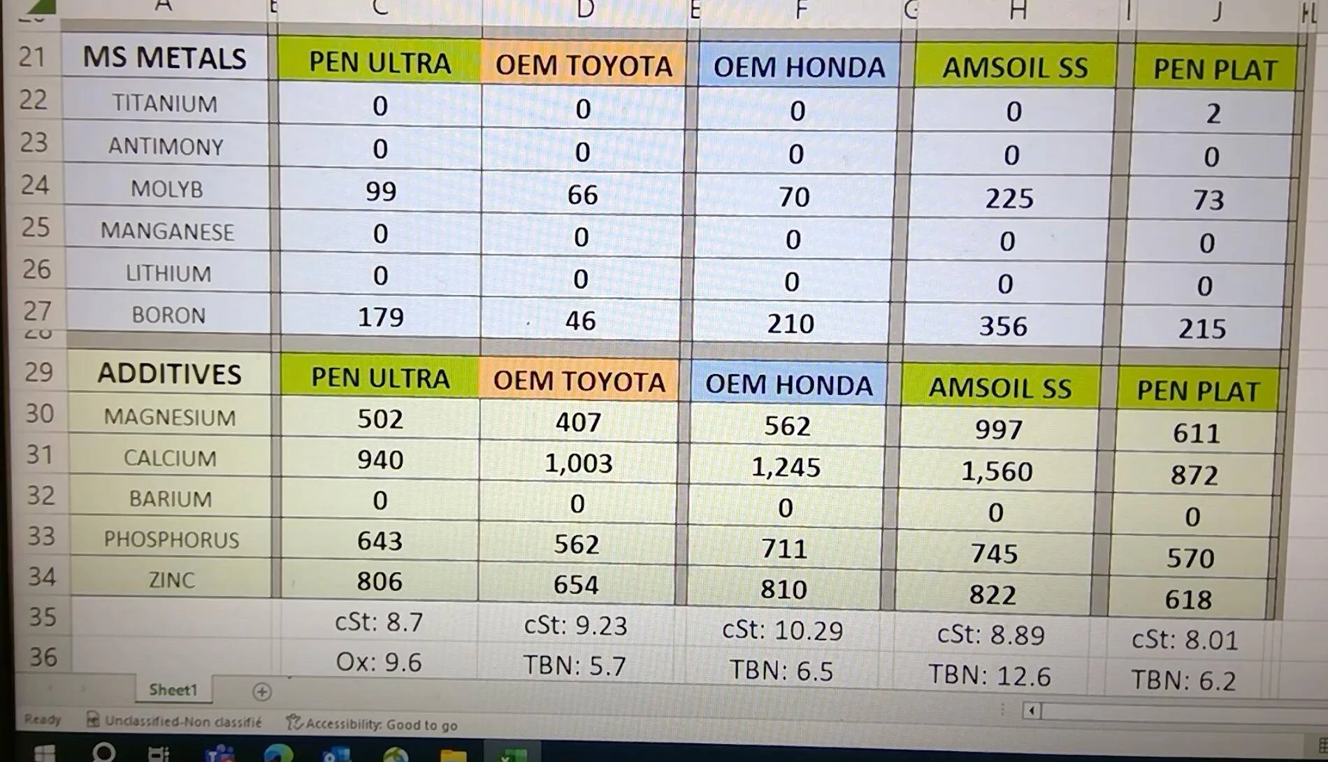

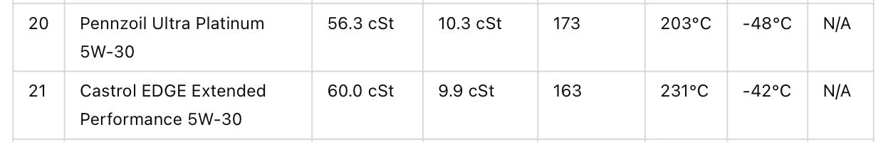

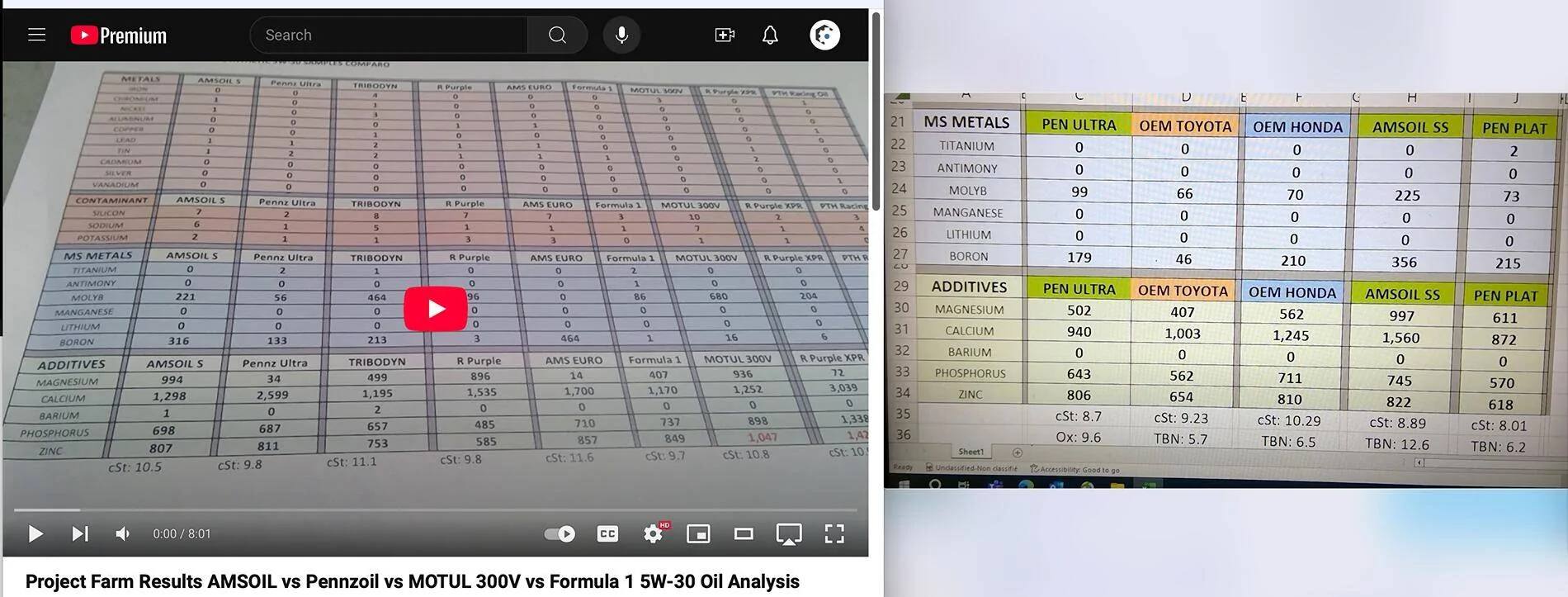

The Honda Oil seems to be very good, it's thicker at 10.29 CSt than a Pennzoil Platinum 0w-20 and similar to the 5w-30 and thicker than a Amsoil Signature Series 0w-20 cSt -- which is a PAO/Ester based high end oil - very good quality according to these lab reports.
The data below is from - https://www.speediagnostix.com/ - which is supposedly the best in the business - I almost can't believe it is this good virgin oil and very curious what my Blackstone reports will show.
Likely sheer from my radiator test. She got a bit hot.

You also did some heavy engine mods last time I saw as well - what exact mods did you have done?
4 piston stage 1 engine, 27won Kuro, PRP intake, XDI pump w/1400cc injectors, and a tune.
