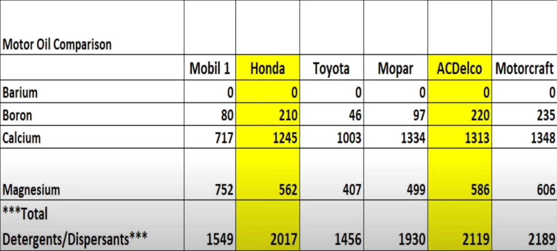

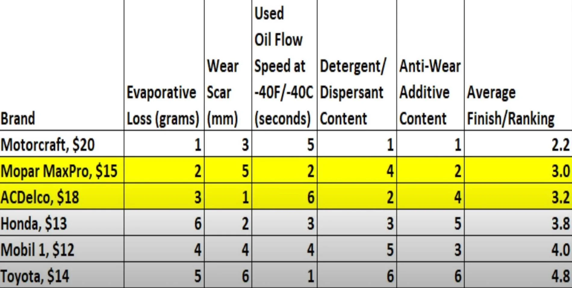

Looks like the Honda Fully Synthetic does have higher detergent content vs. mobile 1

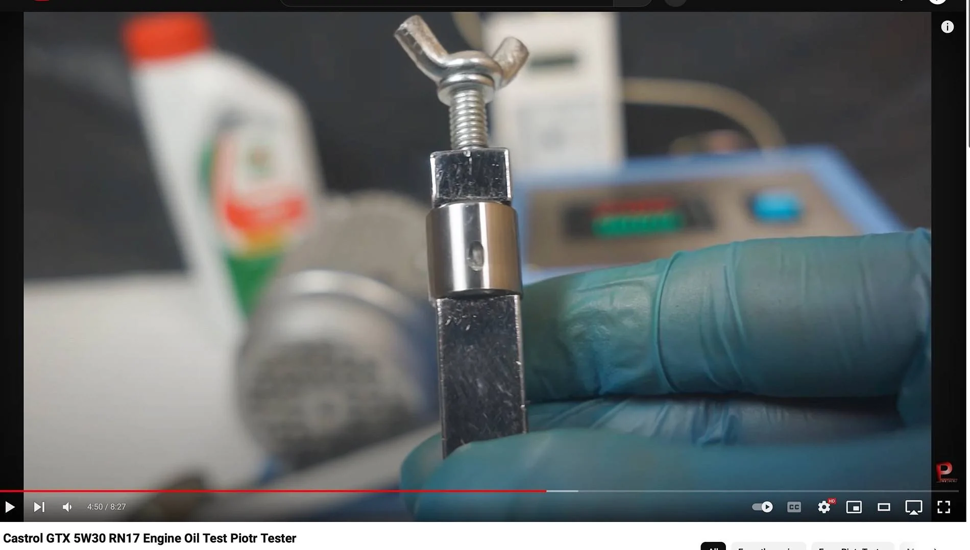

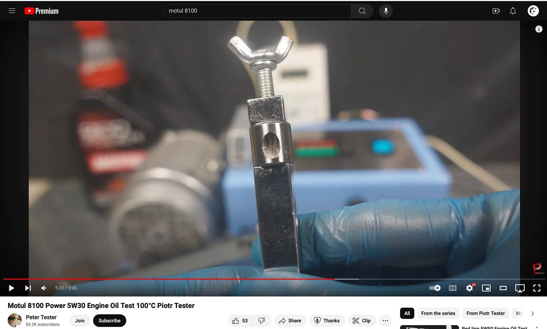

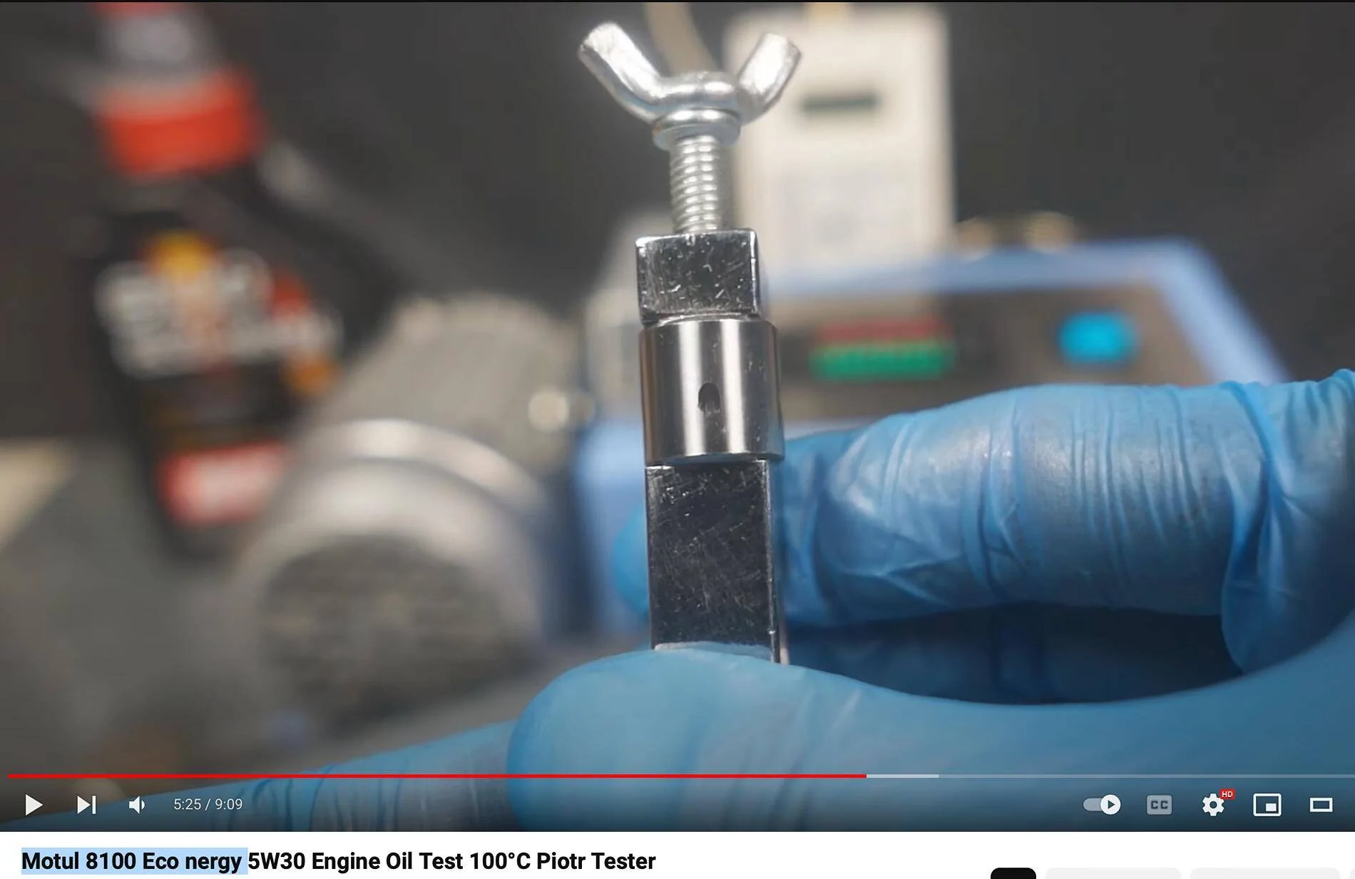

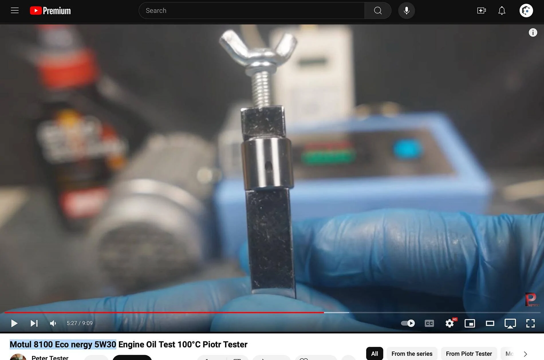

Not All 0-20's and 5-30's are not created equal. Look especially at the 100c wear test.
Now for some reason, this specific Motul Eco nergy was far better than the other eco lite Motul 5w30

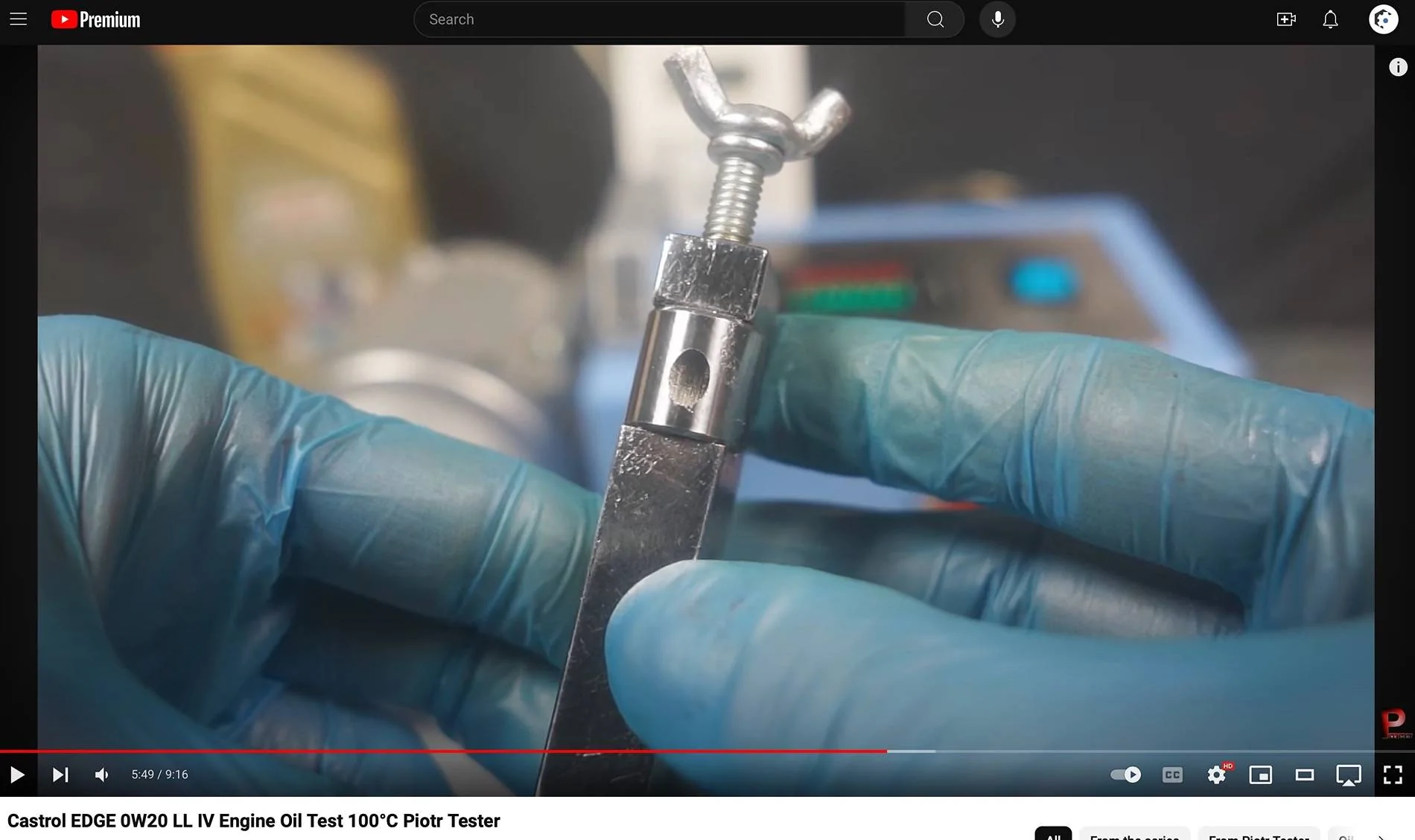

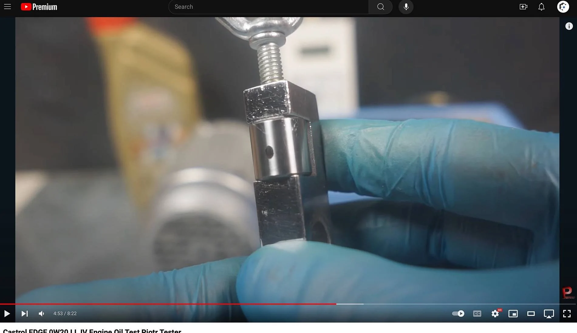

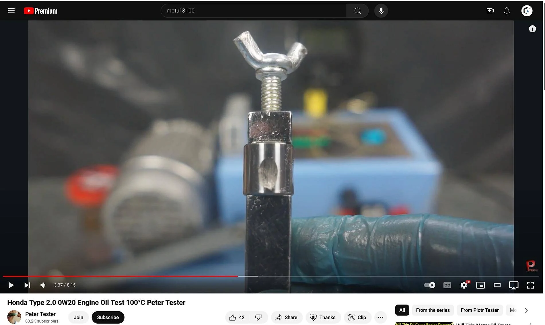

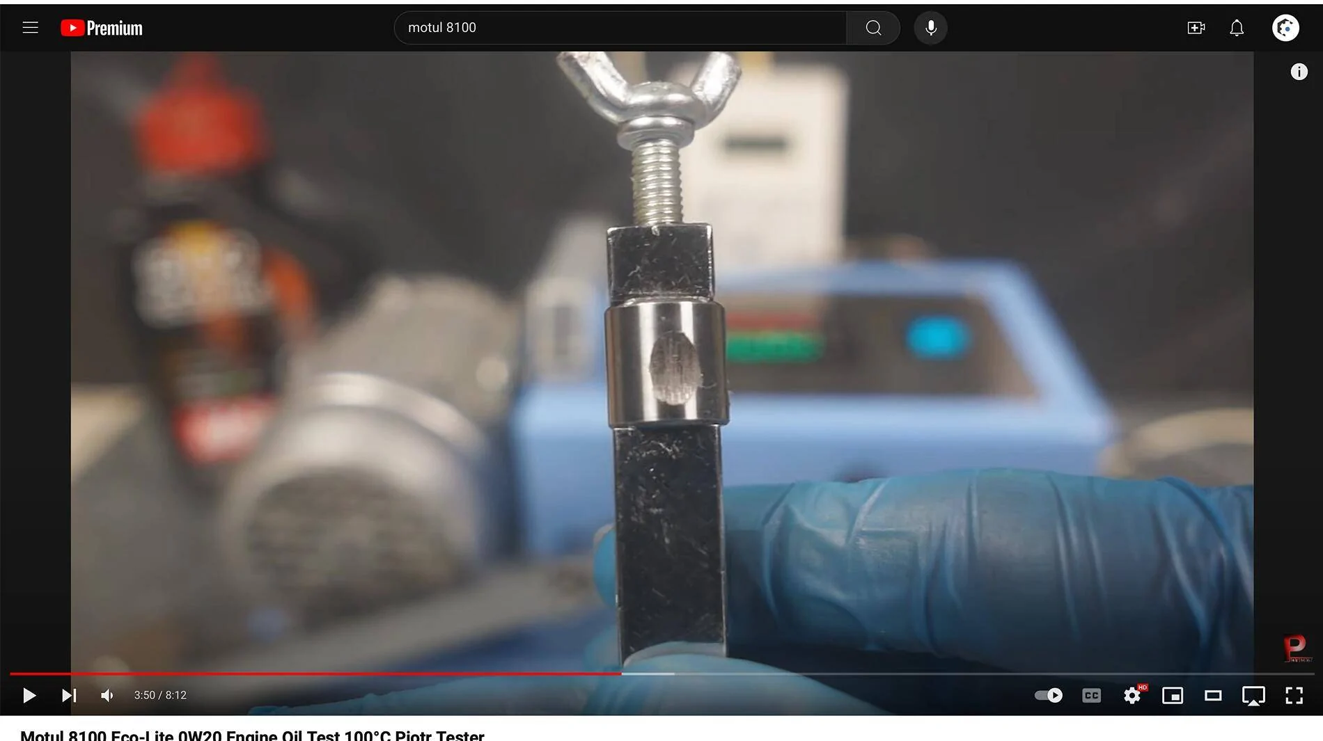

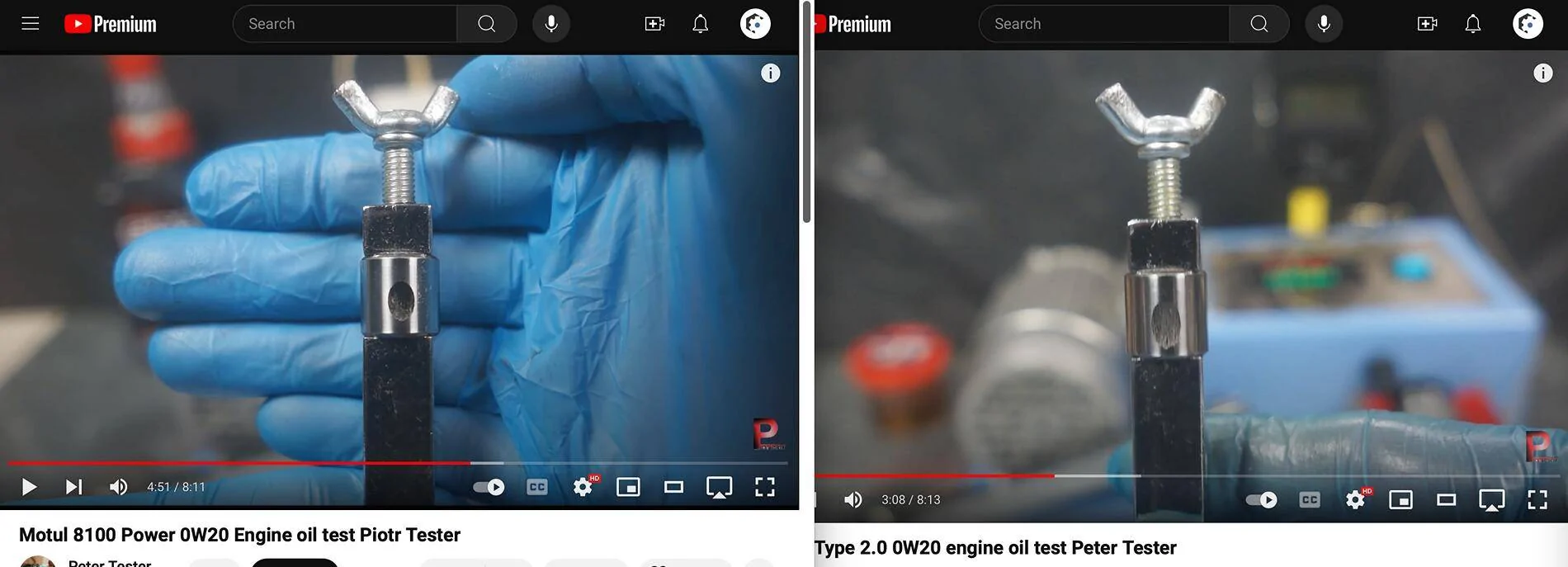

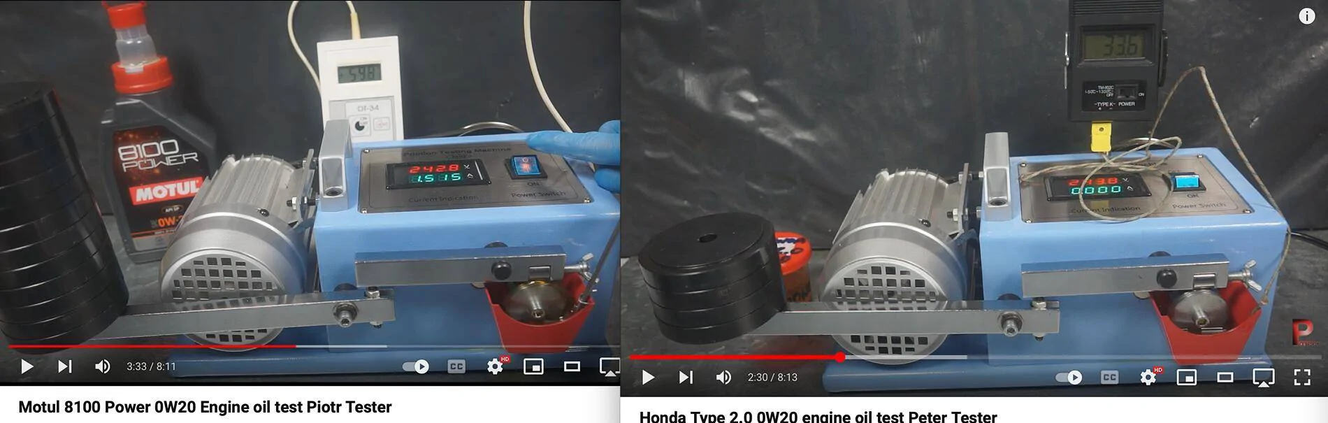

I'm still researching, what is Best, as it seems some of the thicker oils result in hotter water temps, and it seems like the Honda OEM oil is about the same wear as MOTUL 8100 0-20 at 100c, but it did fail earlier at room temp.

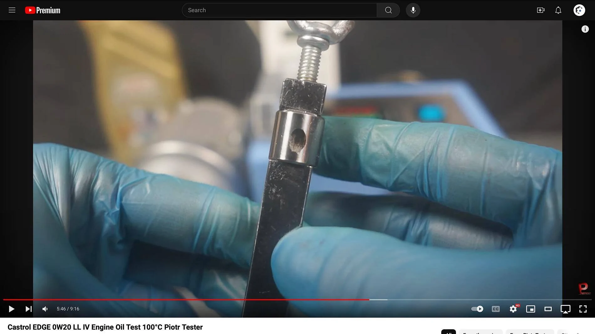

As far as some of the 0w-20's the Castrol Edge 0w-20 did better than both at lower temp on this friction test. There are many other variables to consider also.
11th Gen Honda Civic For occasional track use , which oil viscosity to use? Using oil data sheet for guidance Screenshot 2024-10-10 at 8.24.47 AM
As far as 5w-30's this specific Motul did insanely well, not like other Motul Formulas which looked similar to the 0w-20.Motul 8100 Eco nergy 5W30

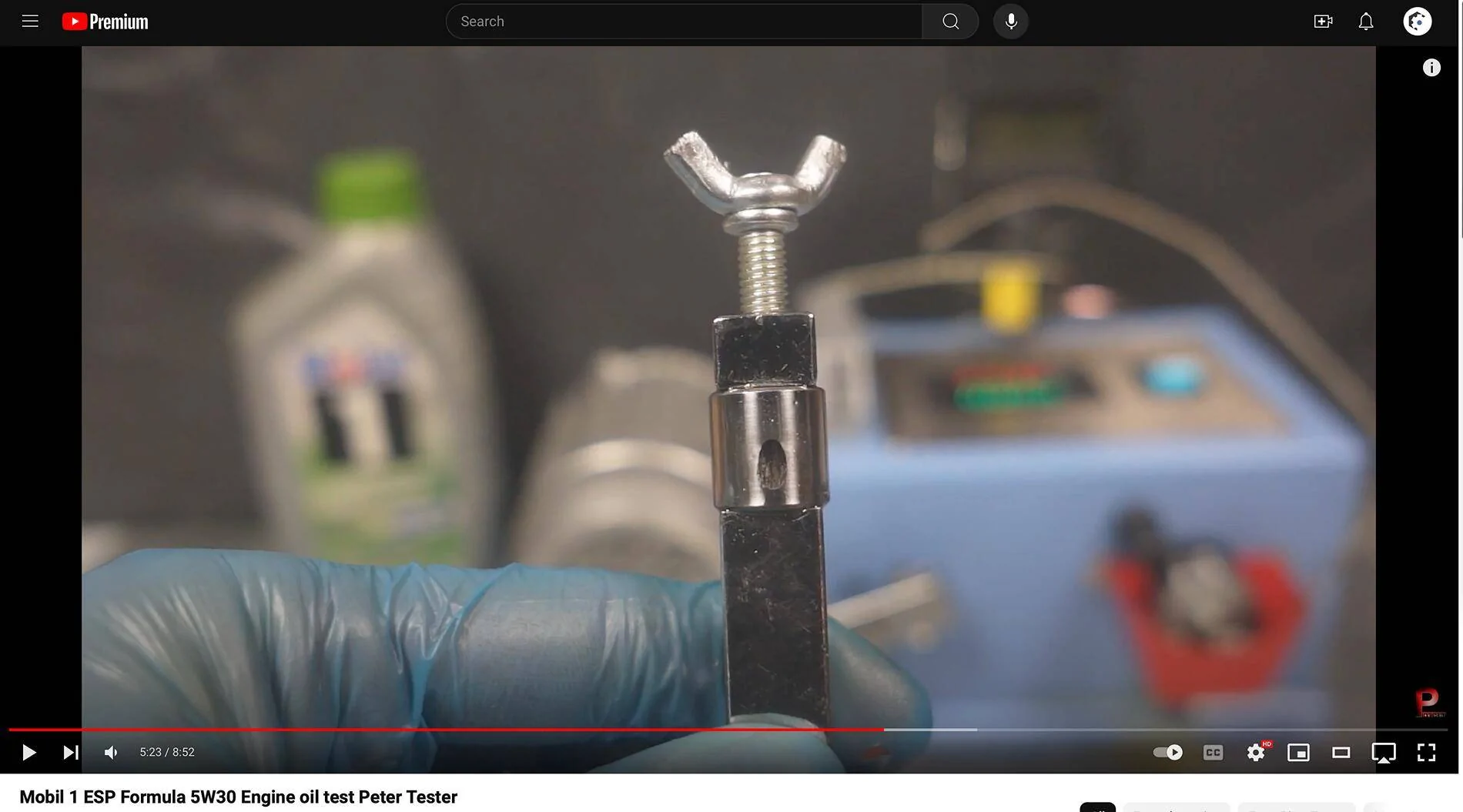

Then there are Mobile 1 5w 30's failing badly at room temperature, not even at 100c - on this specific test. Most people are just guessing what oil to put in their car, without a half way scientific process. I guess it's similar to religion, just believe, and close your eyes, don't question.
11th Gen Honda Civic For occasional track use , which oil viscosity to use? Using oil data sheet for guidance Screenshot 2024-10-10 at 8.30.36 AM

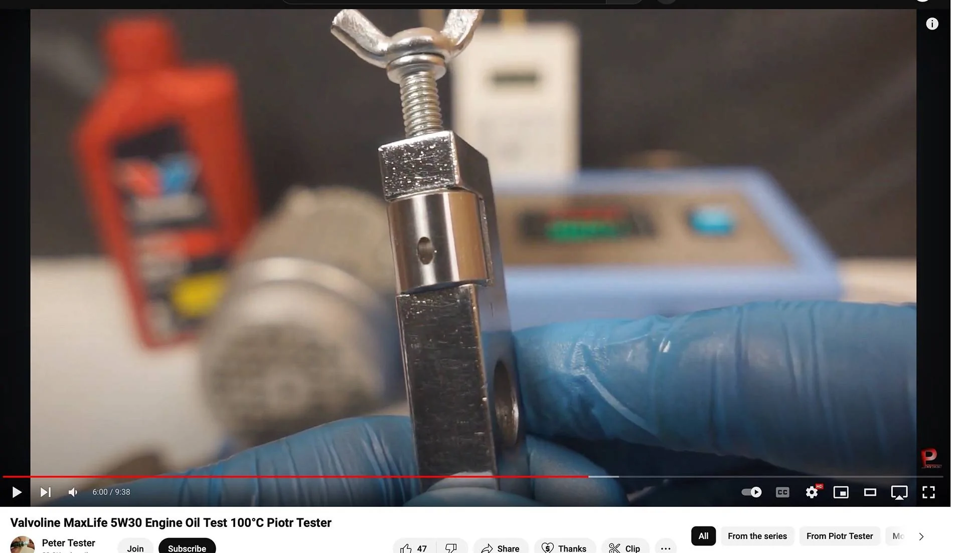

Valvoline Max life 5w-30 did also very good vs this Mobile 1 ESP formula
Then there are Mobile 1 5w 20's failing badly at room temperature, not even at 100c - on this specific test. Most people are just guessing what oil to put in their car, without a half way scientific process. I guess it's similar to religion, just believe, and close your eyes, don't question.
