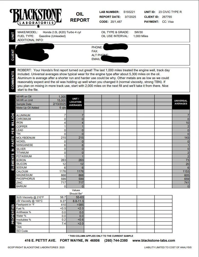

Got my first report from Blackstone.
Looks like everything is good.
This is on 2 track days w/ 1,000 miles in the interval. Oil change was done at 15k miles.
Amsoil 5W-30
Really have no idea what all of the numbers means but the summary says that I should extend it out to 2,000 mile intervals and go from there.
Blackstone is pretty good but man they take forever to send the kits and get the reports back.

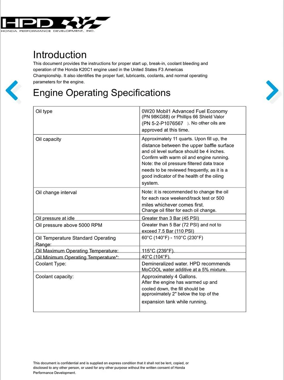

Interesting document I found on the k20c1 used in the F3. They only use the Mobil-1 0W20.
Makes sense since the oil operating range is from 140F 230F with the max operating temp being 239F. The thinner weight means its getting better lubrication.
The problem is that we dont have race car levels of cooling and oil temps will easily exceed 230F so thats why a more viscous oil like 5W30 is recommended. If our oil temps could stay that low then you'd see more people recommending 0W20 probably

No I dont have any data. I've never heard of people recommending 0W20 for track use, every video and every person who has more experience than me unanimously suggests using a thicker oil when tracking your car. The purpose of oil is lubrication not cooling, so that should be what the ultimate consideration is imo. Im not going to be that guy who is contrarian and acts like I know.
I doubt you can conclusively show that 0W-20 decreases oil temperatures. Even if I was use it for testing there would be too many things I couldn't control for so the data wouldn't be accurate. The oil temperatures sensor in the car is calibrated for 0W20 and uses an algorithm. Even if you installed an oil temperature sensor through the oil pan, I dont think its a 1:1 reading because different sensors on different parts of the car give different readings. On cars with oil temperature guages when you install an oil cooler sometimes the reading will give a false positive because of its location.
I imagine that 0W20 is fine for the F3 cars because its basically an upscaled gokart and the engine has to deal with moving only 1,210 lbs, not +3,000 lbs. The engine doesn't have that higher load and stress so I can see why they wouldn't use or need a thicker oil, the engine isn't dealing with the same loads as us. Id be curious to what the FL5/DE5 race cars use, its probably not 0W20.
There is an older post about similar to this topic on the FK8 forums that I lurked through in the past and there wasn't a clear consensus on what was the "best. " They said that 0W20 was okay as long as it was high quality like Motul and that 5W30 was fine.
I live in Florida so its hot and humid here. So thats why I use 5W30. If I lived in an environment where it was colder, Id use high quality 0W20.
