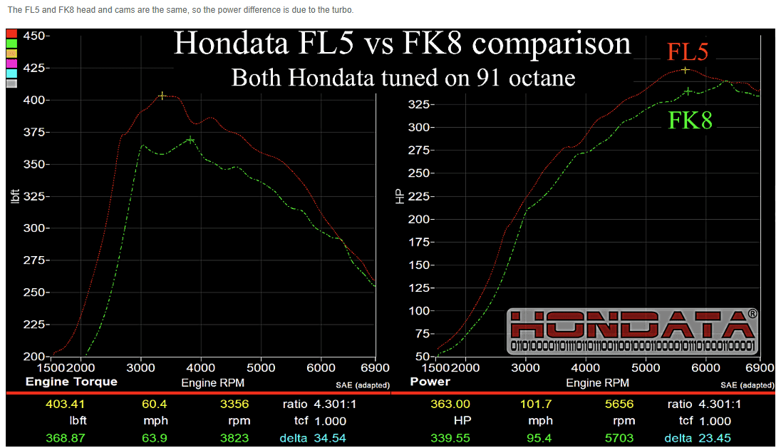

Wanted to highlight this very interesting info that people may have glanced over.
The new FL5 Turbo although having a 5mm smaller compressor inlet, still produces more power and torque than the FK8 turbo. Largely due to the improvement in computerized fluid dynamic software when developing the FL5 turbo.
500RPM gain in spool and more power. Win win win. Great analysis Hondata and thanks!

The torque is crazy! Who’s our first adopter? We need reviews - I can’t imagine this car with that kind of power.
