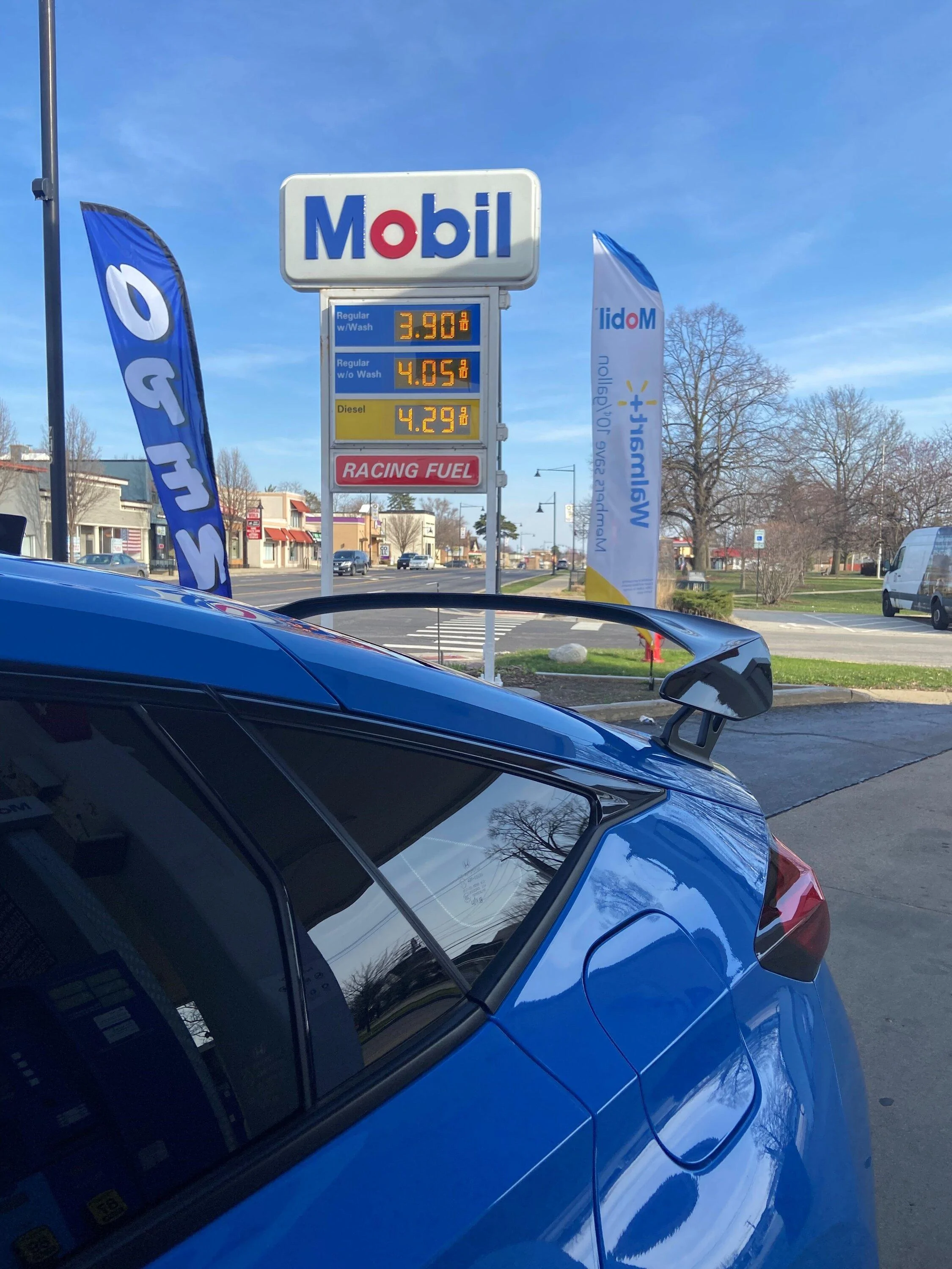

Where does anyone get 104 octane gas? Not practical by any means.
They are just having fun with it. Wait until you see what they do next. ?

A local Sunoco has 100 for $12.99 a gallon lol
