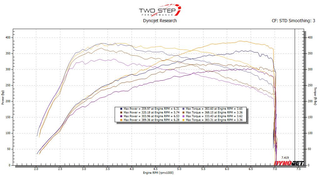

So what is the bump on the 91 octane flash?
Our results on 93 may provide some insight.
Factory tune baseline: 303/333
Hondata 93 octane base map: 320/368
Custom 93 octane: 359/383
Custom high octane fuel blend (estimated 97-98 octane): 389/383
With our custom tuning we were very comfortable with where we left it. There is likely a little bit more on the table for those that are willing to push things further. We also expect that as Hondata continues to refine their software (adding new tables, etc) we can further safely get more power out of the tunes. All in all, great results so far.
11th Gen Honda Civic Hondata FL5 FlashPro released d6271565-5a7c-4e0a-a70a-a092fbfd3d34
Mods include:
  • PRL High Volume Catted Downpipe
  • Milltek frontpipe back exhaust (resonated)
  • PRL Stage 1 Intake Kit (hose and drop in filter)
We have not yet upgraded the intercooler, which we expect would be quite beneficial at this point.

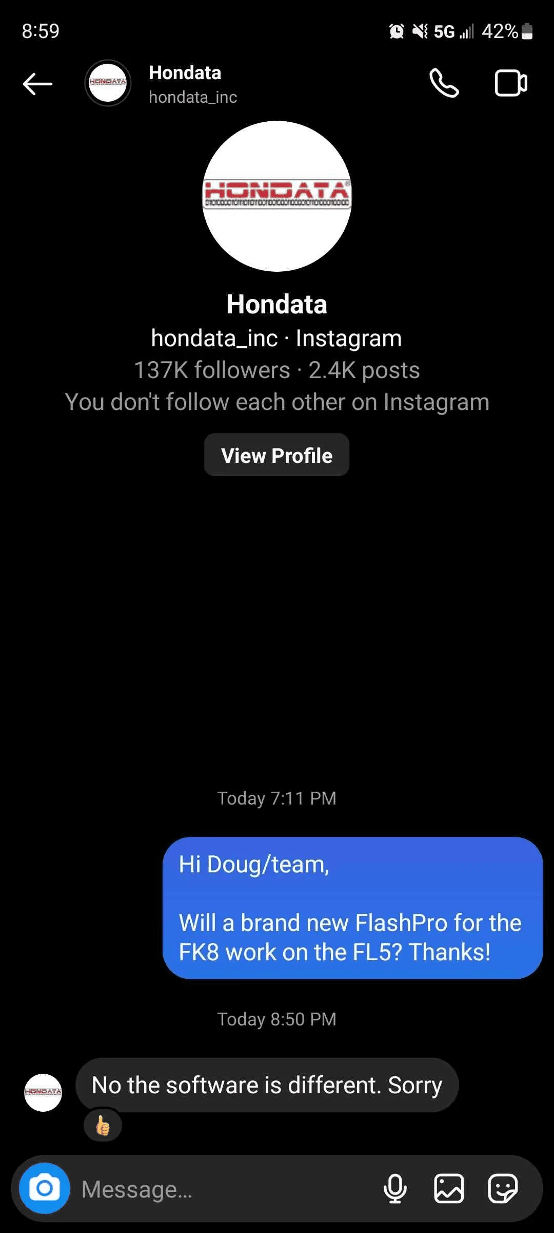

An unlocked FlashPro from a FK8 will lock to and program an FL5. There is no timeline for a remote jailbreak. It may not be possible.
Hey Doug, is this still accurate as of today? Got this answer but wanted to confirm with you. Thanks!
