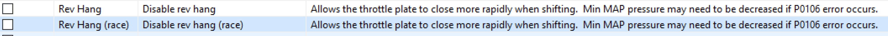

Why does rev hang exist to begin with?
Emissions. The ECU continues to fire the injectors after throttle lift off to reduce cylinder temperatures and nitrous oxides.
We've added another rev hang setting.
11th Gen Honda Civic Hondata FL5 FlashPro released 1682627738096
Rev hang race more aggressively closes the throttle and disables an overboost error.

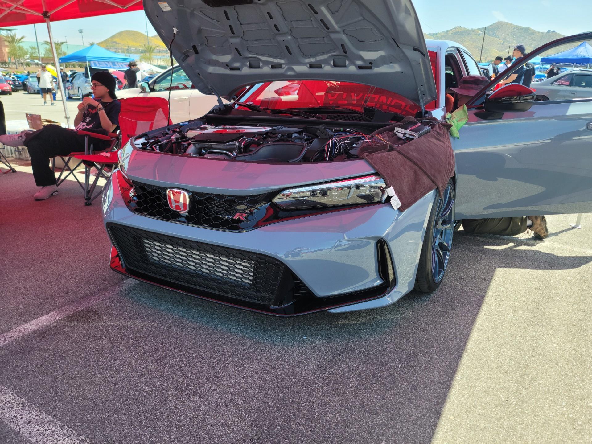

Hondata’s going on a Jailbreak tour for all you guys that would prefer to not have your PCM shipped.
any info on what other cities will be a part of the jailbreak tour?
