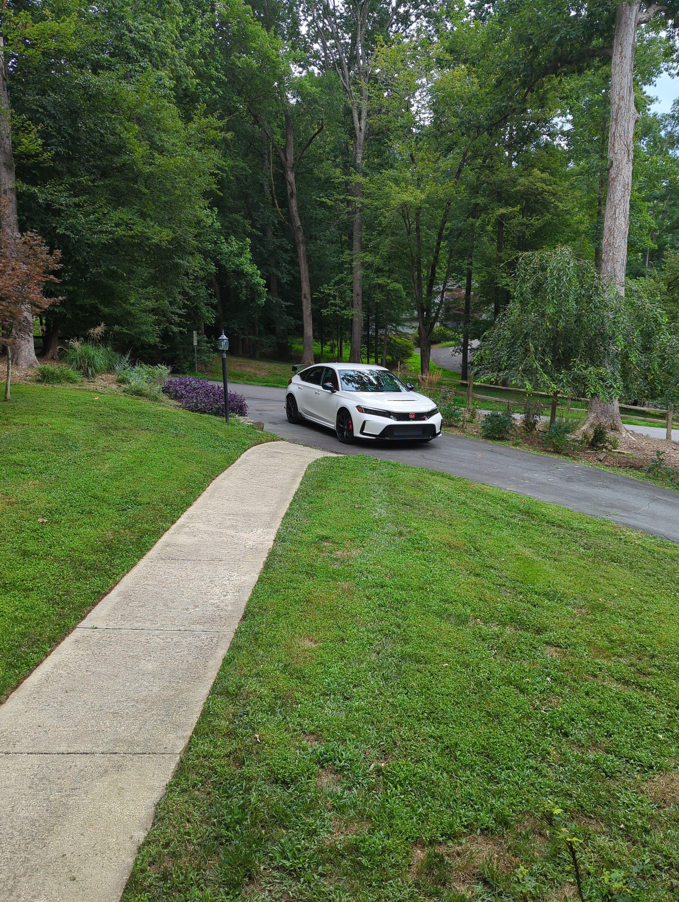

11th Gen Honda Civic PointByPatrol #21985 Build Journal! RIP #9243 IMG_20230722_131008_01

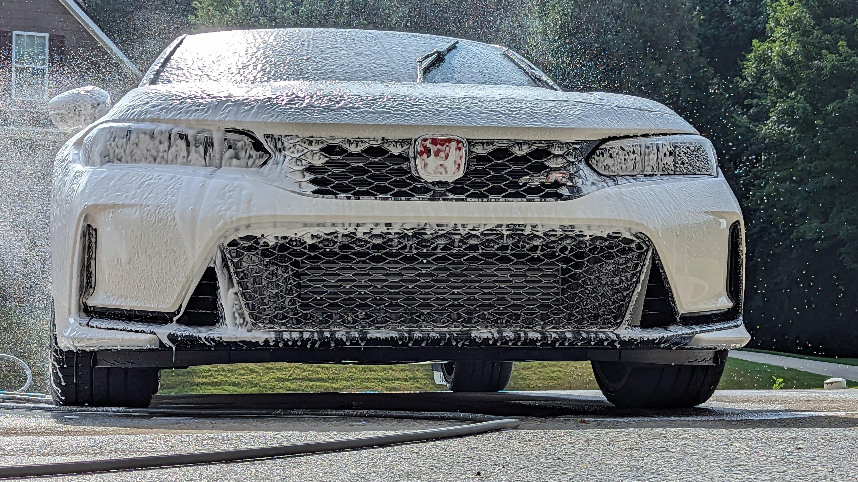

Pre-wash for paint correction and ceramic coat!
11th Gen Honda Civic PointByPatrol #21985 Build Journal! RIP #9243 PXL_20230805_133735295

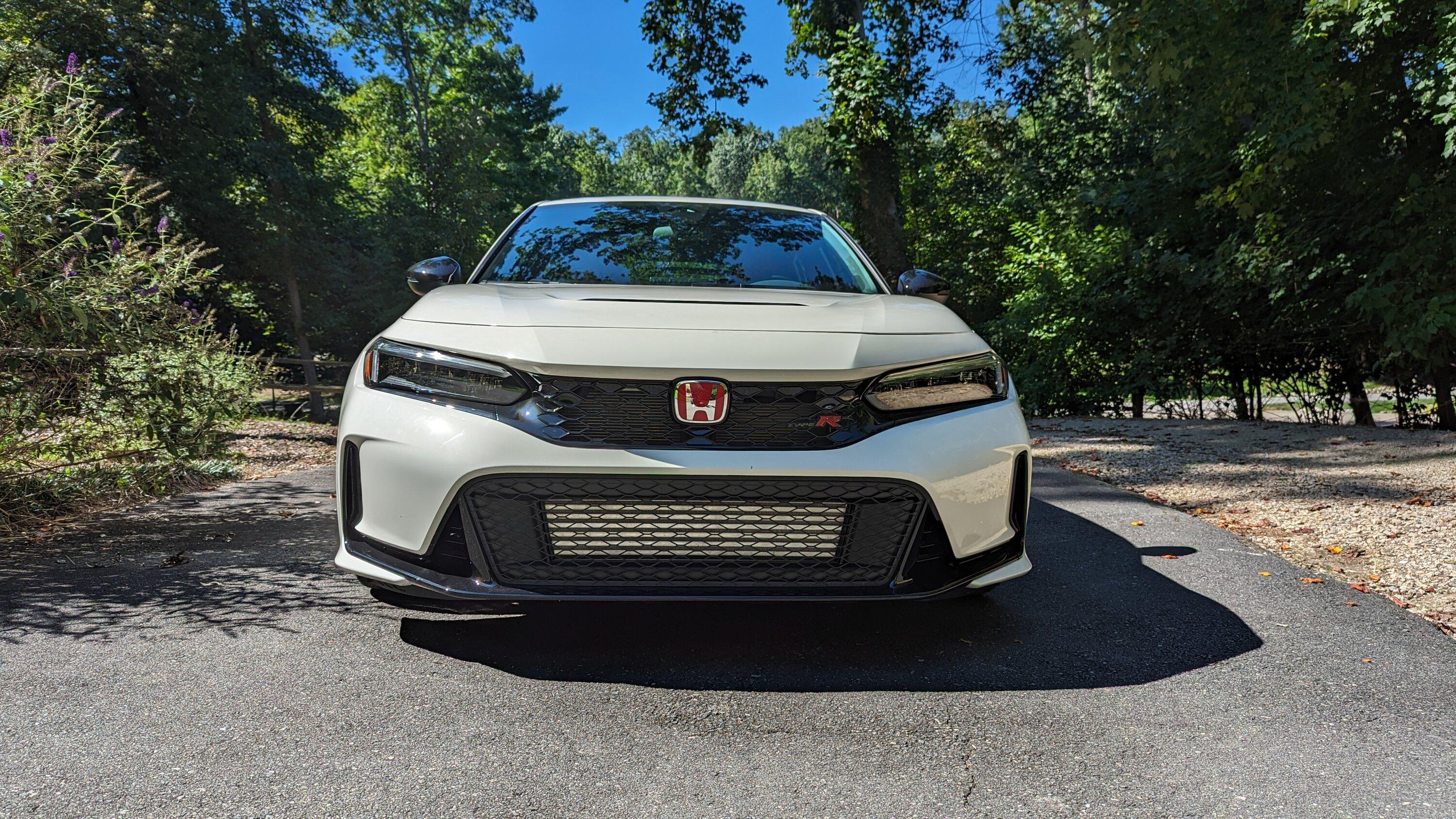

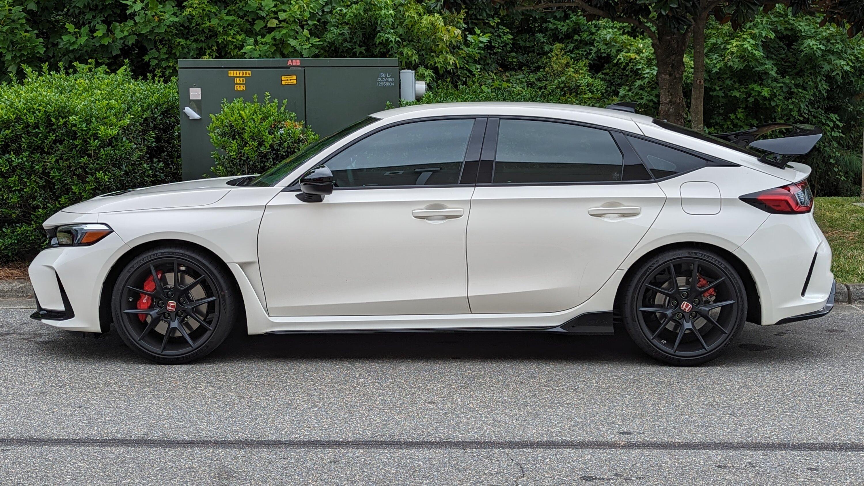

Came out great! Extremely hard to get good before and after shots on Champ white!
1,224
1,794
FL5 Civic Type R
Ha! Post them anyway. The world is a better place with more CW photos! I'm guessing no PPF? Which products did you use from start to finish?

No PPF, yet. Waiting for front bumper pre-cuts to be available. Held off on ceramic coat because of this. For now it was Sonax Perfect Finish Polish, then sealed with CarPro Cquartz, and two coats of wax. Once the pre-cuts are available for the front bumper I'll strip everything, apply the ppf, and ceramic coat.

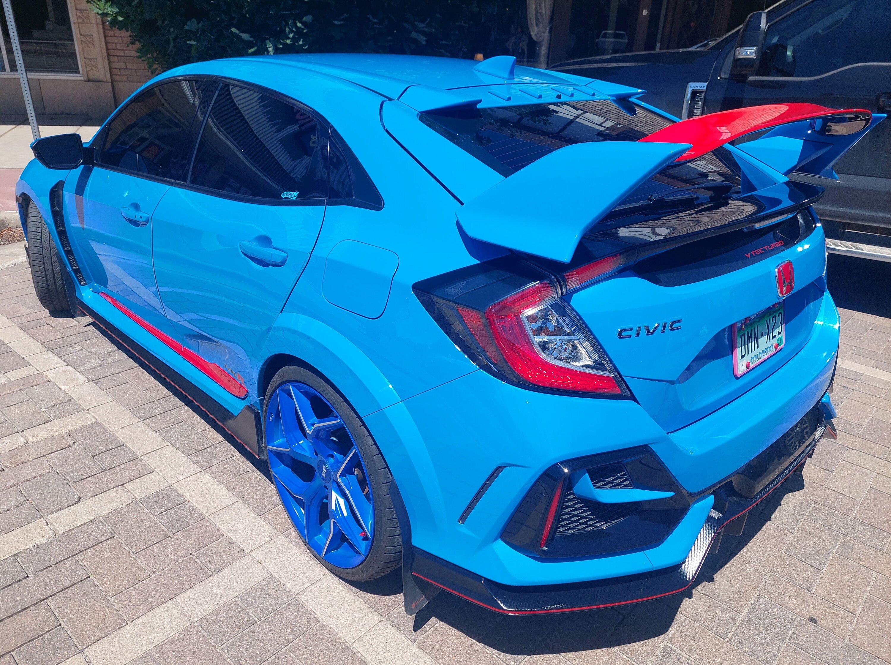

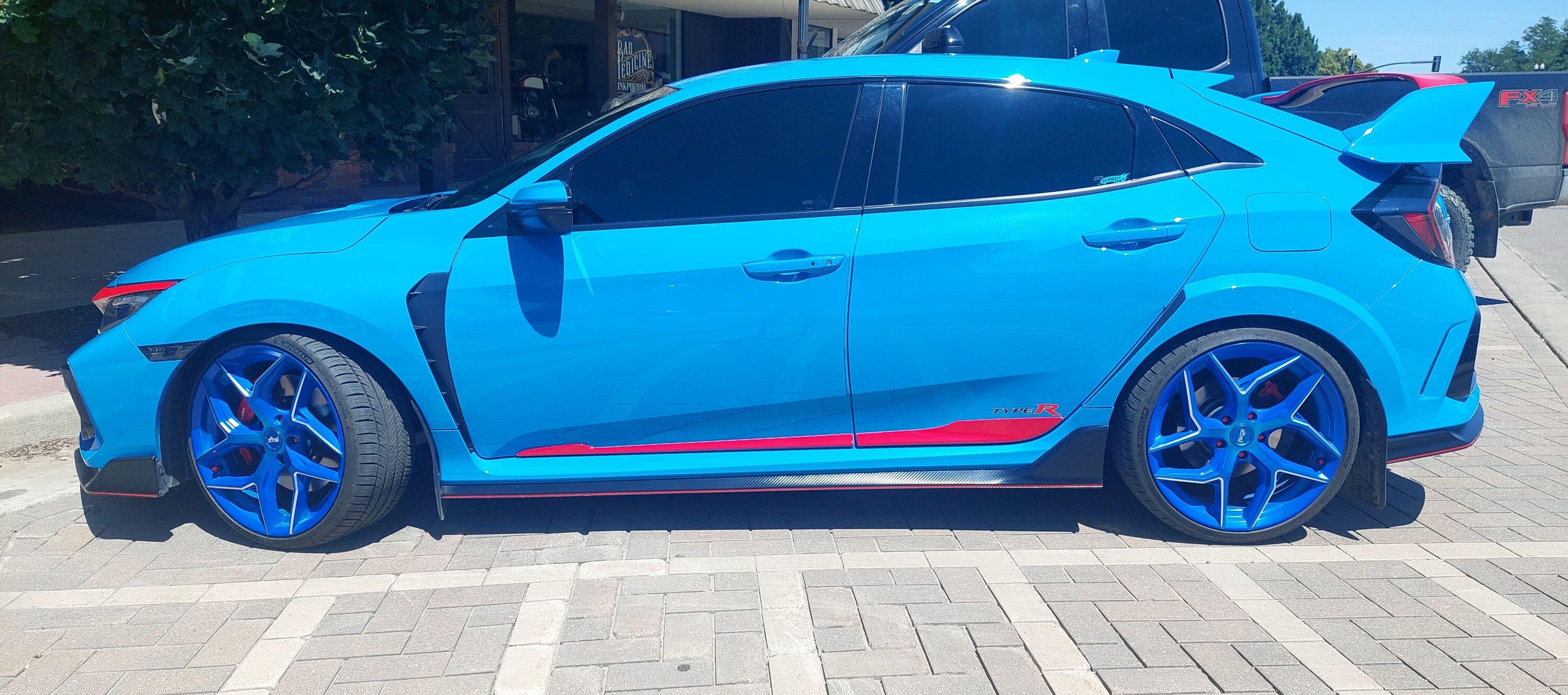

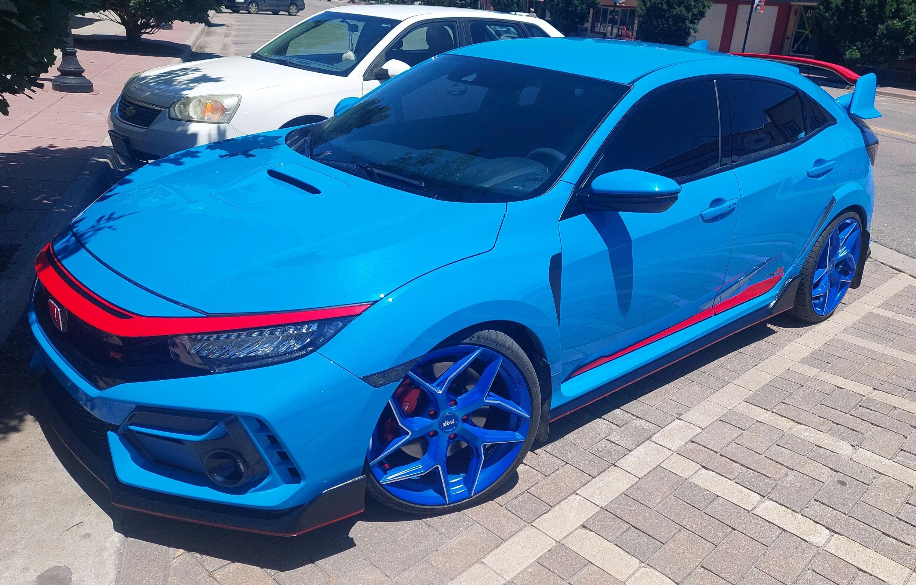

2021 Type R (Honda re-design addressed radiator over heating issue in 2020)
245-30-20 Michelin Pilot AS4 tires - Niche Torsion 9 x 20 (8.5 stock) Face of Tire flush with fenders
Face of Tires pulled outward x 1" in comparison to stock set-up
O.P. track guy - are you disappointed in the decreased diameter of wheels on FL5 ?
O.P. track guy - you mention YOU LIKED FL5 aerodynamics - you like FL5 smooth sedan look ?
I'd recommend reading this article https://www.roadandtrack.com/reviews/a41957966/2023-honda-civic-type-r-review-2/
The FL5, while more subdued in looks is actually more aerodynamic.
The facelifted FK8's did improve cooling capabilities, but unfortunately still suffer from overheating when pushed hard at a racetrack. I spent 1,000's on my FK8 trying to deal with the overheating issues, and despite a wide open grill, HKS oil cooler, C&R radiator filled with distilled water and water wetter I still was able to push the temp gauge up to 2/3rds-3/4's.
As for wheels, smaller is often better, to a point of course. I swap my wheels over for 18's when I'm at the track. The wheels I use are significantly lighter than factory, and having a higher sidewall on a wider/beefier tire provides much more protection on the curbing. I'd likely bend 20's at the track on my first lap.

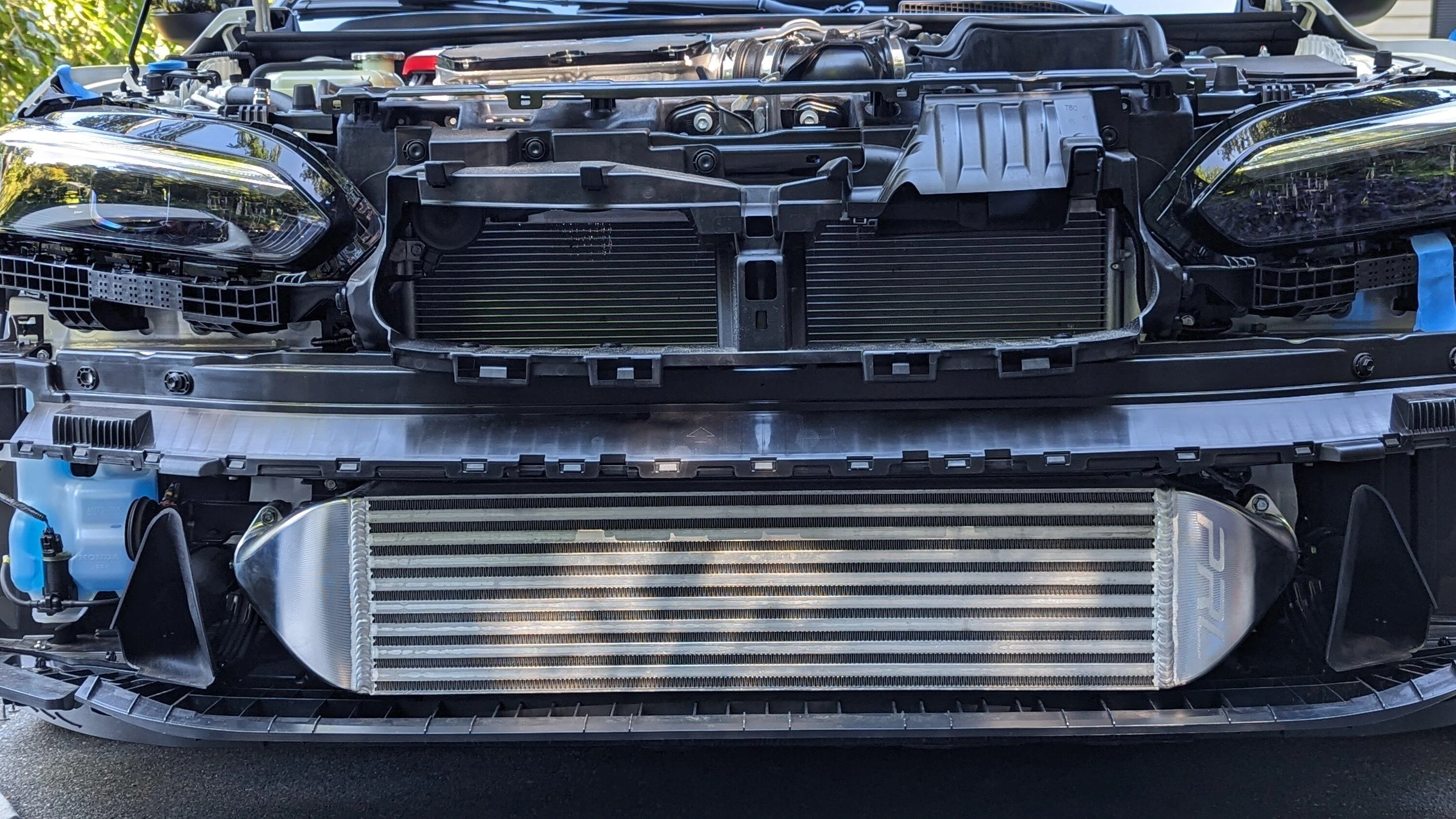

I've got an upcoming track event in 4 weeks, and my HEL oil cooler finally arrived! I installed it today, but to my dismay there are key differences between the FL5's we receive here in the states, and the ones that are built for countries overseas!. Despite this I was able to create a work-a-round and get it installed! I was in contact with Mike and Conner at HEL during the install, and shared my findings during the process so that they could develop a kit for us folks in the USA. This is the only external oil cooler currently available for the FL5. I purchased it from Dream Automotive. Nobody was aware until today that this kit wouldn't bolt right up to a USDM Type R. I consider myself lucky to be the guinea pig! Here's the install video below!
