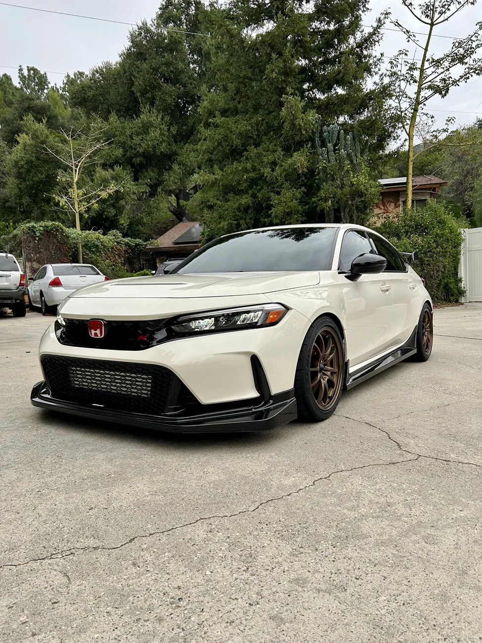

I'm on Spoon Springs with Mugen MF10 18x9.5 +40 with a 5mm spacer in the front and rear. I will say the 18's do ride more comfy due and it sits perfect.
11th Gen Honda Civic Spoon Progressive Springs - Wheel Size? IMG_6119

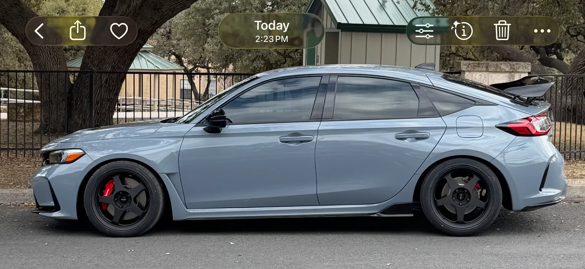

I run a 275/35-19 Vredestein Hypertrac for the winter on stock wheels, WITHOUT spacers you are fine, with the 15mm/13mm I run it would be REAL close! That's with 35 series. Which is highly recommended for drive comfort, wheel safety and filling that gap nicely! I MIGHT not even lower the car now :)
