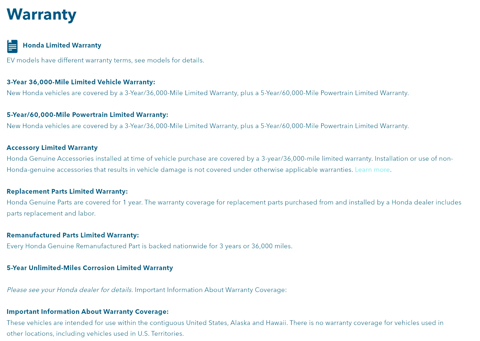

7 years?

7 years?
The only way this holds water if your fuel level is low. There's been numerous anecdotes where the engines go limp and throw codes when driven hard and low on gas. To my knowledge this is generally sustained track conditions though; how "spirited" are you driving?
still don't know where the seven years comes from, unless it's an aftermarket warranty.
i believe its called hondacare? its an extended honda warranty (im assuming this is what they purchased)

Correct, I purchased the extended warranty through Honda. I have the paperwork somewhere but I remember it being 7 years/100,000 miles or it may have been 120,000.

And 7 years has got to be an extended warranty... but I don't think it matters pretty sure we're still in the window for everyone who owns an FL5 is still under warranty.
people like to hate on the extended warranties saying they're a ripoff and will deny everything . but my 150k aftermarket warranty already paid for itself.
In relation to the price of the car, getting the extended warranty wasn't that much more so I decided to get it. It's nice to hear that I probably made the right choice!
