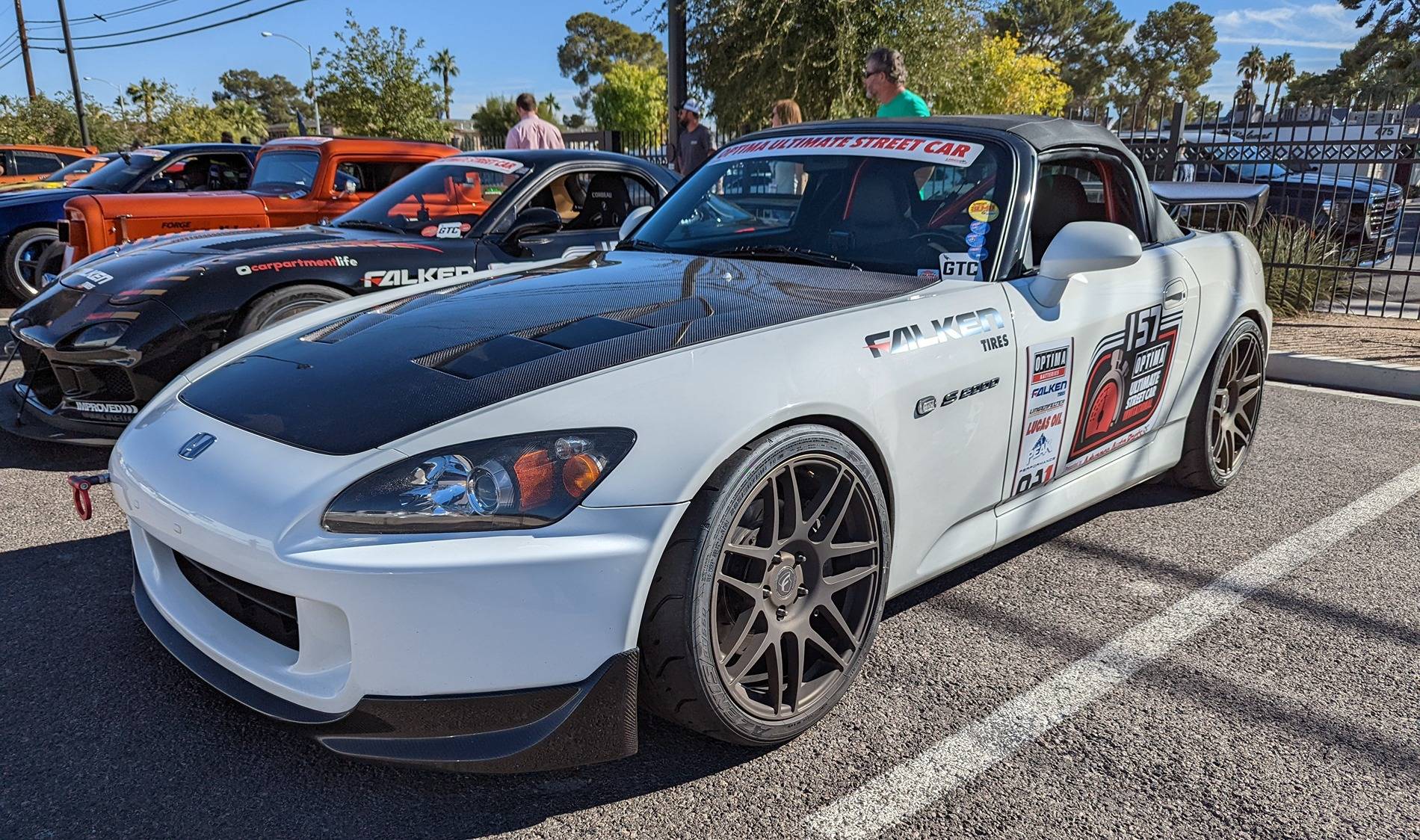

Nope, just rolled/slight pull (and offset bushings in the front uppers). It's all about the offset. :)
285/30R18 on 18x10.5 ET65, with 5mm spacers in the front to clear the Stoptechs:
Rex-spec®️ isn't a new thing, just a new thing to the FL5. ?

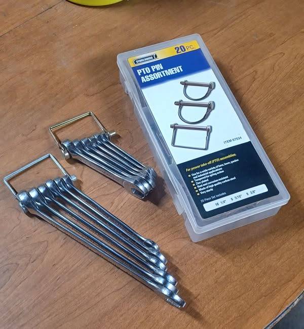

Stuff like this make me feel so dumb like why didn't I think of this ?
BigBird
May 29, 2023
1,078
838
you're not alone!
I had one of my wrenches warrantied, and the replacement doesn't fit in the case. So it bothers me to no end that it's missing,
Then this shows up in my feed, and I'm like this is easier to carry and can hang it more securely when not using it.

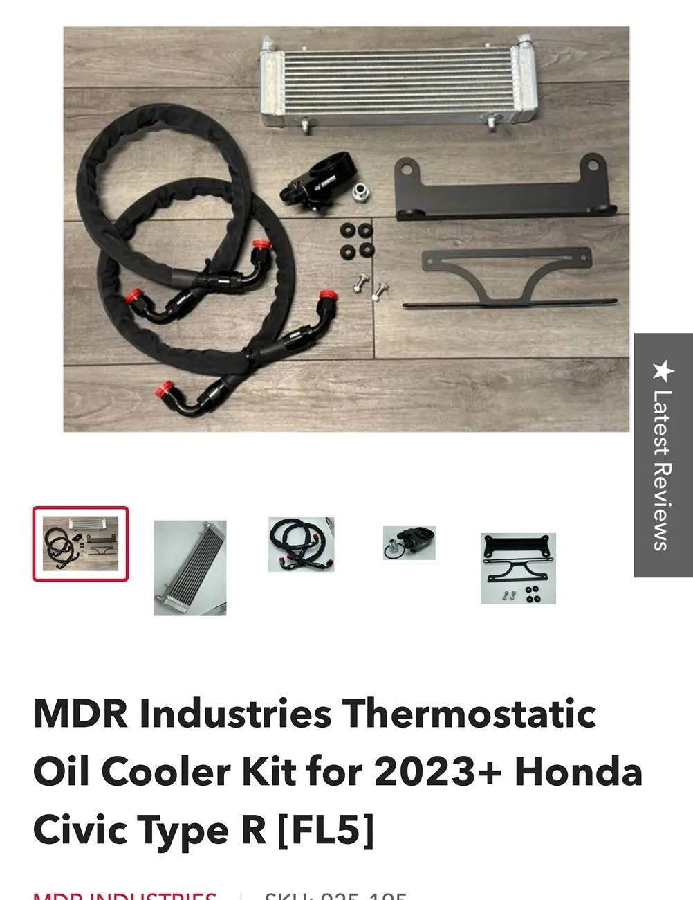

I'd be hard pressed to run that oil cooler on the floor -- that's asking for a disaster
So you guys are saying airtec and hels oil coolers aren’t the greatest options. But I haven’t seen anything on the MDR oil cooler.
What are your thoughts on the MDR?
https://www.twostepperformance.com/products/mdr-industries-thermostatic-oil-cooler-kit-for-2023-honda-civic-type-r-fl5?currency=USD&variant=44712916713604&utm_source=google&utm_medium=cpc&utm_campaign=Google Shopping&stkn=a744205727a8&tmsrc=googlead&tmcid=21857775254&tmsid=&tmid=&tmkw=&gad_source=1&gbraid=0AAAAAC-p3hhKrAdi3IEi0GGqBql2_7e9F
11th Gen Honda Civic *The FL5 Track Junkie Thread* IMG_3643

The brackets utilize all existing factory points while situating the oil cooler in direct ambient flow.
Seems like it will have the same problem as the HEL Oil cooler. Without the proper ducting and placement its not going to be very effective at cooling the oil.
It bolts on probably somewhere in the crash bar just like the HEL and it will block airflow to the radiator which is bad because its just trading one for another. I dont think there is anything wrong with the cooler itself, its just that the mounting location kinda sucks and its not getting the ducting it needs to properly work.
Im pretty sure that the oil cooler that HEL sources for its kit, Setrab is the same one W.O.T. uses. Only difference is that it has dedicated ducting so it can get the dedicated airflow it needs and isnt robbing the airflow of other heat exchangers.
CSF is coming out with its own oil cooler design. It has 3 coolers, 2 on the sides and 1 for the transmission, the thought process apparently is that because the engine oil and engine coolant lines both run through to cool the transmission. If you add a heat exchanger for the transmission that should bring the engine oil and coolant temps down.
