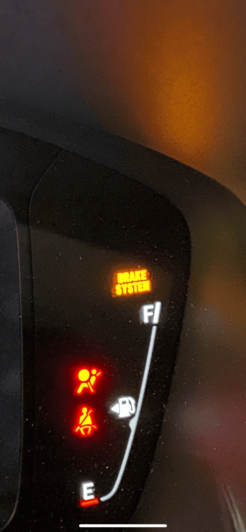

@savagegeese did anybody ever mention anything about the amber Brake System light during any of the track sessions? I can't find anything in the owner's manual about it. I see it on the dash in the official Nurburgring video so I'm not too concerned about it but just curious about what triggers it.

That makes sense, but the light I'm talking about is on the dash. It's the amber light that says "Brake System". Comes on after a few laps/hard stops on track. You'll see it during the bulb check when you first start the car and all of the dash lights come on.

That must be the brake fluid temp warning light.
Thats part of the Hondas Safety Sense system I think. Its like collision warning or something like that or cars have it. You actually are supposed to disable that system before going on a track and some tracks actually wont let you drive with it because those systems can turn on like a false positive and actually cause a crash.

That’s what I’m assuming. Was hoping they had given you an official answer. I checked my scan tool and it doesn’t display brake fluid temp so not something I can check at the next track day. Just gonna keep sending it.

This is the light I’m talking about. It’s different than the big BRAKE message when you’re about to rear end grandma for going 10 under in the fast lane. I had all of the safety stuff turned off on track. I’m hoping it’s just about fluid temp but would like to know for sure.
The brake system warning light was on the entire press event where honda was at Sonoma. We asked chief enginer said it was just a warning that you may have fade soon. Other brands have said brake system warning lights are algorithmic it looks at brake cycles, gforce, velocity, temp and approximates fade to warn driver. Obviously that all changes when you change pads, tires and is no longer meaningful.

Awesome, great info! Thanks for the clarification.
