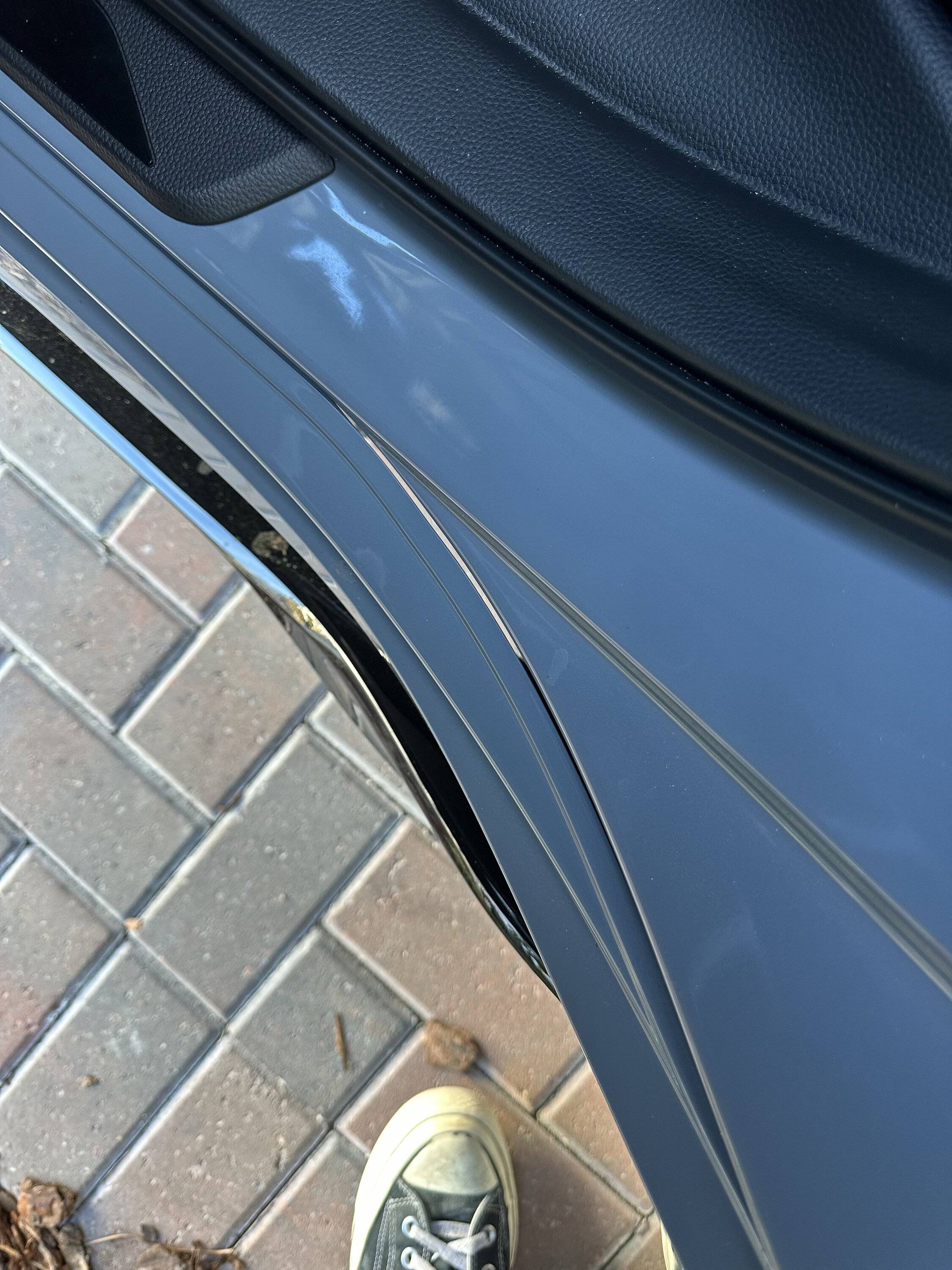

I picked up my 2023 type r 2 weeks ago and after washing the car for the 1st time I noticed that you can see the ground for both back door trims . Is this normal on a new type r? Is the car built poorly or is this a fluke?
11th Gen Honda Civic Build quality 76C36B41-2A5D-4CDD-8981-49CFA709A52F

Itā€™s a Honda, not a Bugatti
this car has fantastic build quality

Something I love about the car- ā€œItā€™s a Type R!ā€. Something Iā€™m not thrilled about- ā€œit is just a Civicā€. This falls under the latter category.

Yeah same on mine. If it was a water outlet you'd think the inner door would drain better, but I suspect it is just how it lines up.

In the pic it looks like the panels line up well and the gap is pretty consistent. Agree that the slot is likely for water drainage. It makes no sense otherwise. Clearly they could have not had a slot at allā€¦which would allow water to collect in that gap and possibly freeze or cause other problems. That would be no bueno.

The FK8 has these gaps too, noticed them while washing the car for the first time.

To simply the answer for why do the body panels have gaps comes down to one main reason. If two painted parts touch each other it will chip an rub the paint on bother surfaces. Especially on the soft plastic parts. The gaps are created intentionally. I have seen a headlight or taillight that touches the body rub a chip through simply from install with no time to wear and tear. To sum it up yes this is completely normal and acceptable. Would only be an issue if the gap was very large and/or inconsistent ( could be a clip not set).
