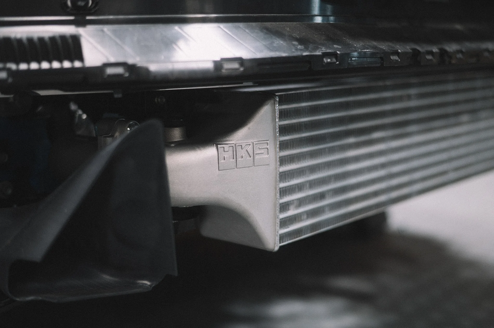

The HKS is nice but I will say a lot of fins are getting destroyed by debris lol
This is why I tell people to run B&P intercoolers for the street, they tend to be more robust.
I got the HKS right before the price increase and love it. No added lag and great results at the track. But if a used PWR popped up I might buy it to switch out because of the debris
Is the damage limited to just the fins, or are you seeing dings on the tubes as well?
Just little rocks getting stuck between the fins and some bent fins. Tubes are fine

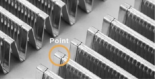

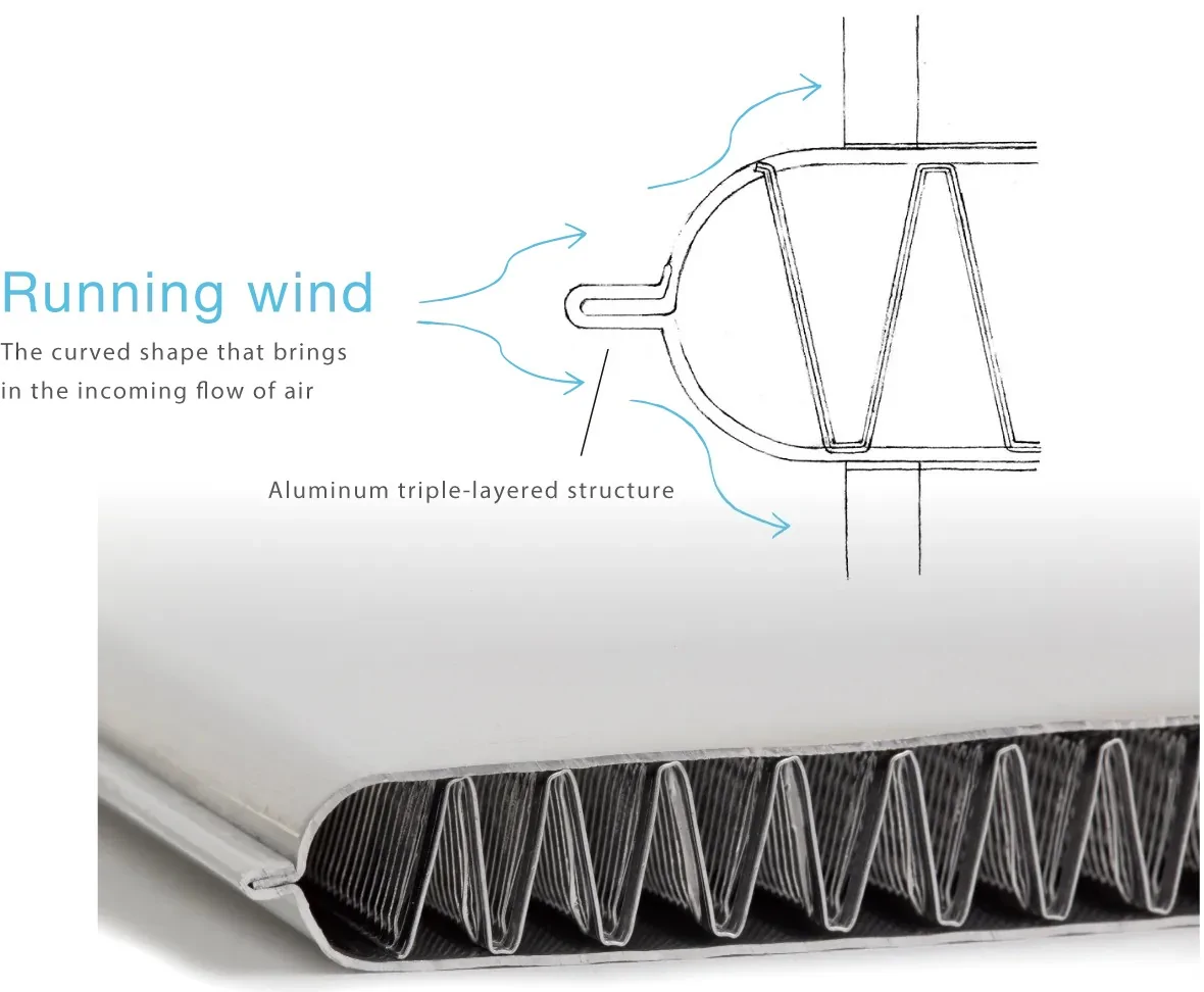

IMHO, this is where core design matters more. The J's Racing T&F intercooler is in a different league where the core uses a double layered front fin design and a unique triple layered front tube design.
11th Gen Honda Civic FL5 Intercooler Reference Thread core2
11th Gen Honda Civic FL5 Intercooler Reference Thread tube1_en
I have had the J's Racing intercooler installed on my daily and street driven FL5 for a year now. Since then, there has been no damage whatsoever to any of the fins or tubes. Granted, it may cost a kidney as compared to other available options but the core itself is very efficient and rugged.
If I were in the market to buy an intercooler where cost did not matter, I would consider the J's Racing or HPT Micro-tube. The HPT Micro-tube appears to be the clear winner for various reasons but I would still like to know more about long-term durability.
