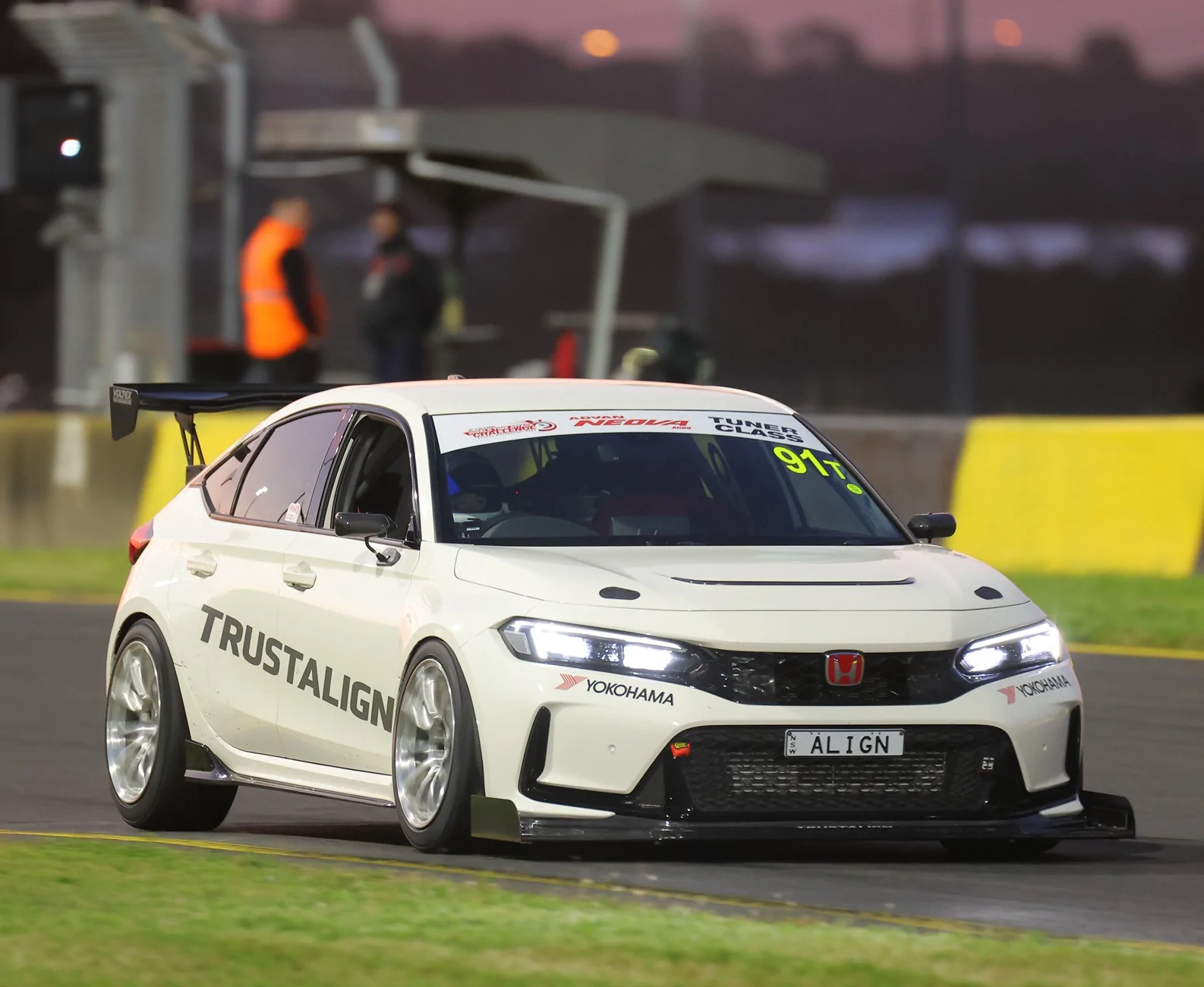

The results and lift coefficient that the video has derived here tells me that the model or methodology is inaccurate since the Honda themselves document that the vehicle produces 90kg of total downforce at 200kph. I suspect there's a lot of missing flow from a lack of underfloor detailing in the model since it was never shown in the video.
Regardless, our time attack car is producing around 300kg at 200kph with the Voltex Type 2 rear wing w/ 10mm gurney flap and a custom splitter with the brake ducts completely blocked off.
