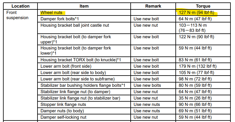

FL5 Torque Specs:
11th Gen Honda Civic Lug Nut Torque for FL5 - Owners Manual Wrong! 1679281931594
File attached.
/end thread :)

Where does it state what car this is for?..it should be on the page? Correct?
It's out of the factory service manual for the FL5. There is not a car listed on these specific pages.

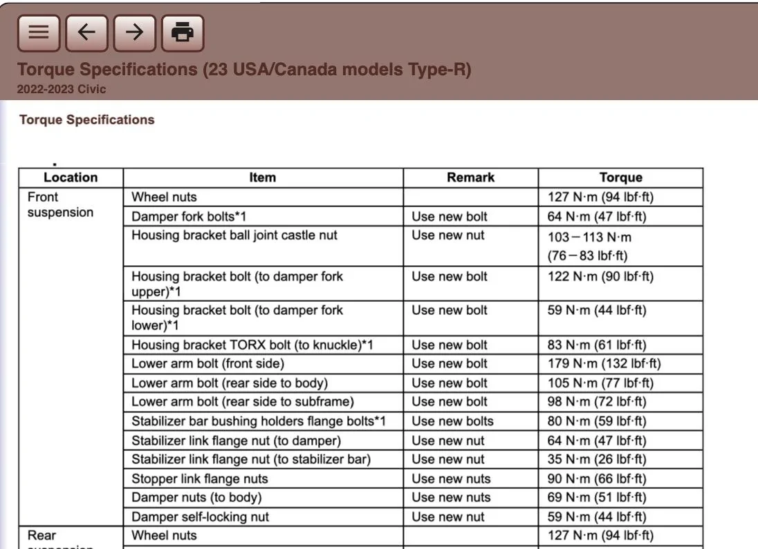

Yup, my local dealer’s regional rep confirmed the USA owners manual is incorrect and has the standard Civic torque listed; should have had a note for Type R specific torque of 94. I edited the first post so hopefully people see it.
As the OP you can edit the thread title as well. I would recommend doing that as 80 is not correct and you don’t want people following that info.

94 is correct. From the service manual.
11th Gen Honda Civic Lug Nut Torque for FL5 - Owners Manual Wrong! Screenshot 2023-05-26 at 9.38.51 AM

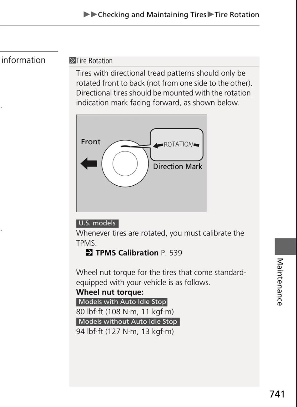

2025 Owners Manual (US) finally corrected this, page 741.
11th Gen Honda Civic Lug Nut Torque for FL5 - Owners Manual Wrong! IMG_0844
