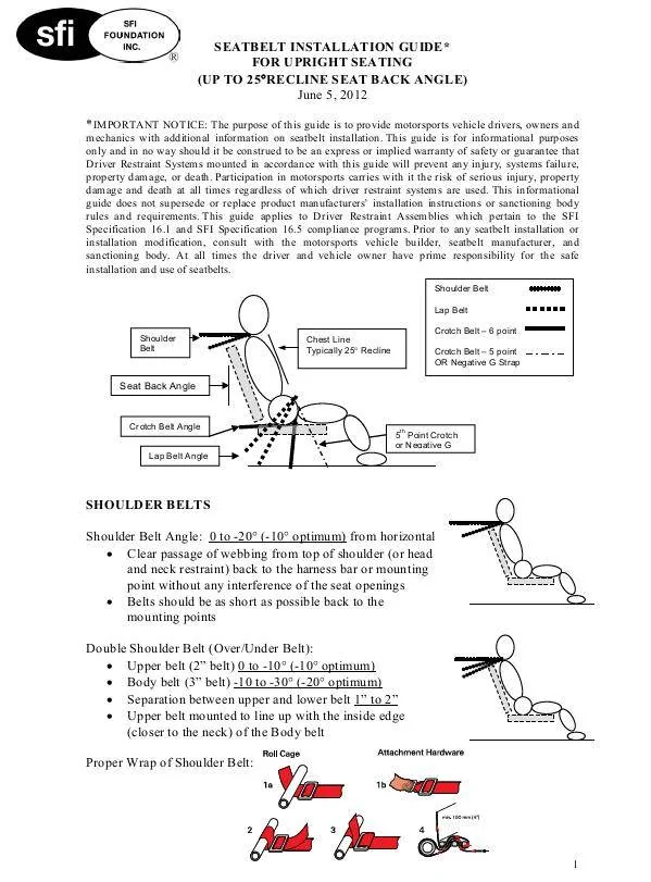

i'm not a fan of a harness bar in case of a crash, then you can lose your seat belts if the bar bends, is that right?
Yea, I want to make sure it's safe that's why I'm gonna take my time to install the harness.
In Japan all the tuning shops just use the baby seat latches in the rear seat. Per the SFI as long the harness is within a 20 degrees downward angle it is safe, however I'm skeptical about that option.

Thats the thing about this car, you have a back seat and putting a cage kind of defeats the purpose. That said I would not be comfortable wearing harnesses without a half cage.
Its too bad Shroth is not making their anti submarining harnesses for new cars. Those seem great for the cars that were tested. I doubt we could convince them to do one of the type R since there is not a lot of demand and to get it tested would cost them a ton of money. There are people that use these on different platforms that they were tested on, some might be comfortable doing this but I would not do it because the testing all depends on the seat.

I'm going to see what options are available, I know the FK8 harness bar can fit with some modifications. I Still want my back seat to be usable. Hopefully more aftermarkets can come out with a simple solution.
Plenty of fabrication shops can do a custom roll bar for you.
