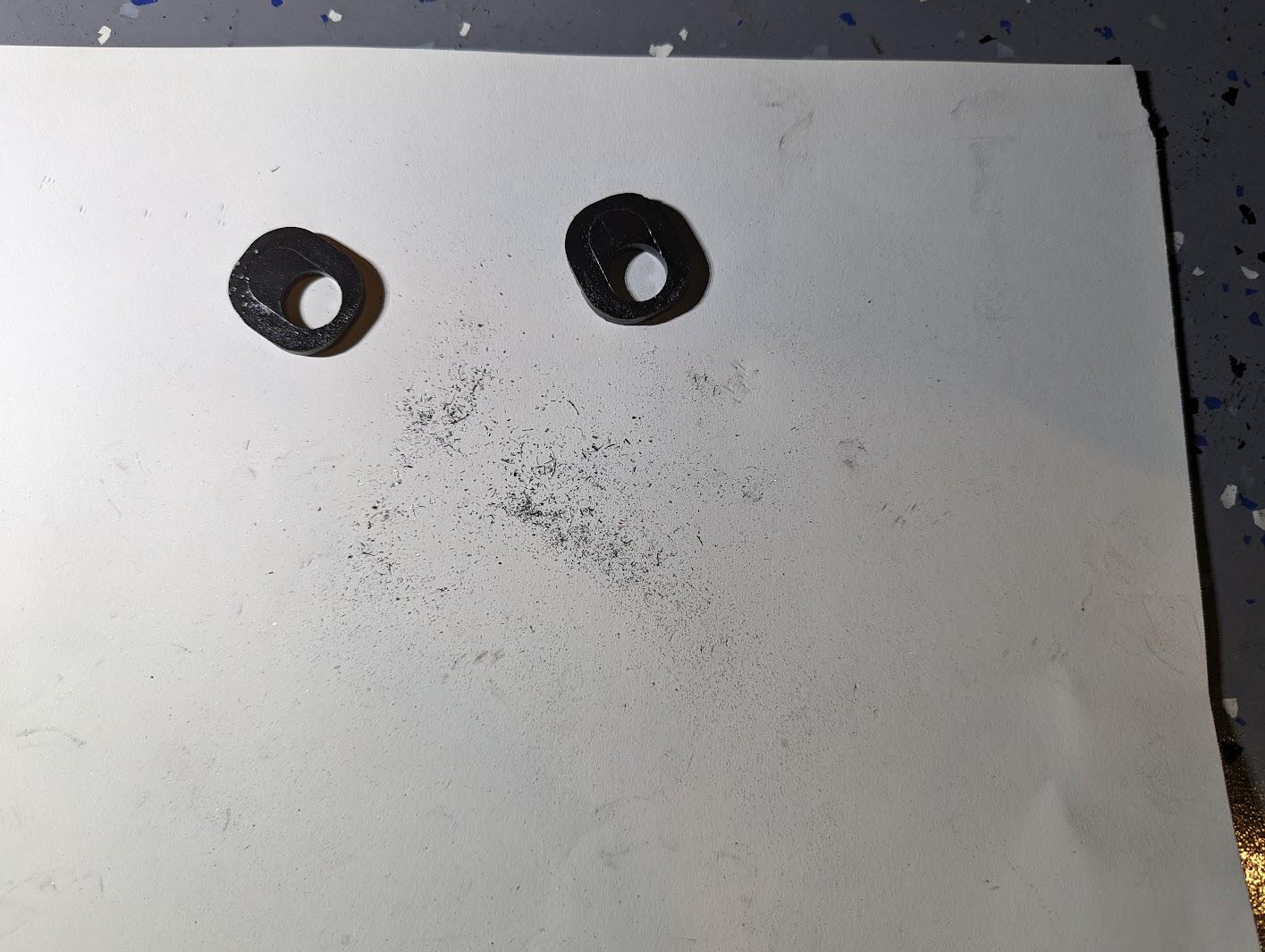

Was switching out the ball joint camber plate to adjust camber and noticed metal shavings falling out when I loosen the 2 bolts. The bolts was torqued to 80ftlb. The ball joint was on car for 5 track days running -3.8 (which was too much for re71rs on stock suspension).
Is this cause for concern?
What brand of lower ball joints do you have?

Interesting, your issue is one of the worries I have with adjustable lower ball joints. I visited Evasive in person and asked Mike about their development on the adjustable lower ball joints. He had mentioned they went through a couple of revisions to what they sell now to ensure there was enough material to withstand sheer loading on the ball joint. He noted that they have not encountered any further issues, with the exception of the occasional dust boots being torn.
I'd be happy if they would just make a fixed version, like what is offered for the S2000.

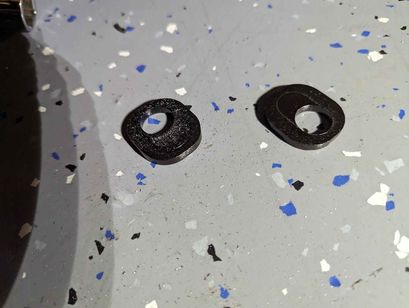

Here is a pic of the other side, where I try to collect all the shavings. Torqued it to 96ft lb this time around. Yea, I much rather have a fixed version as well.
