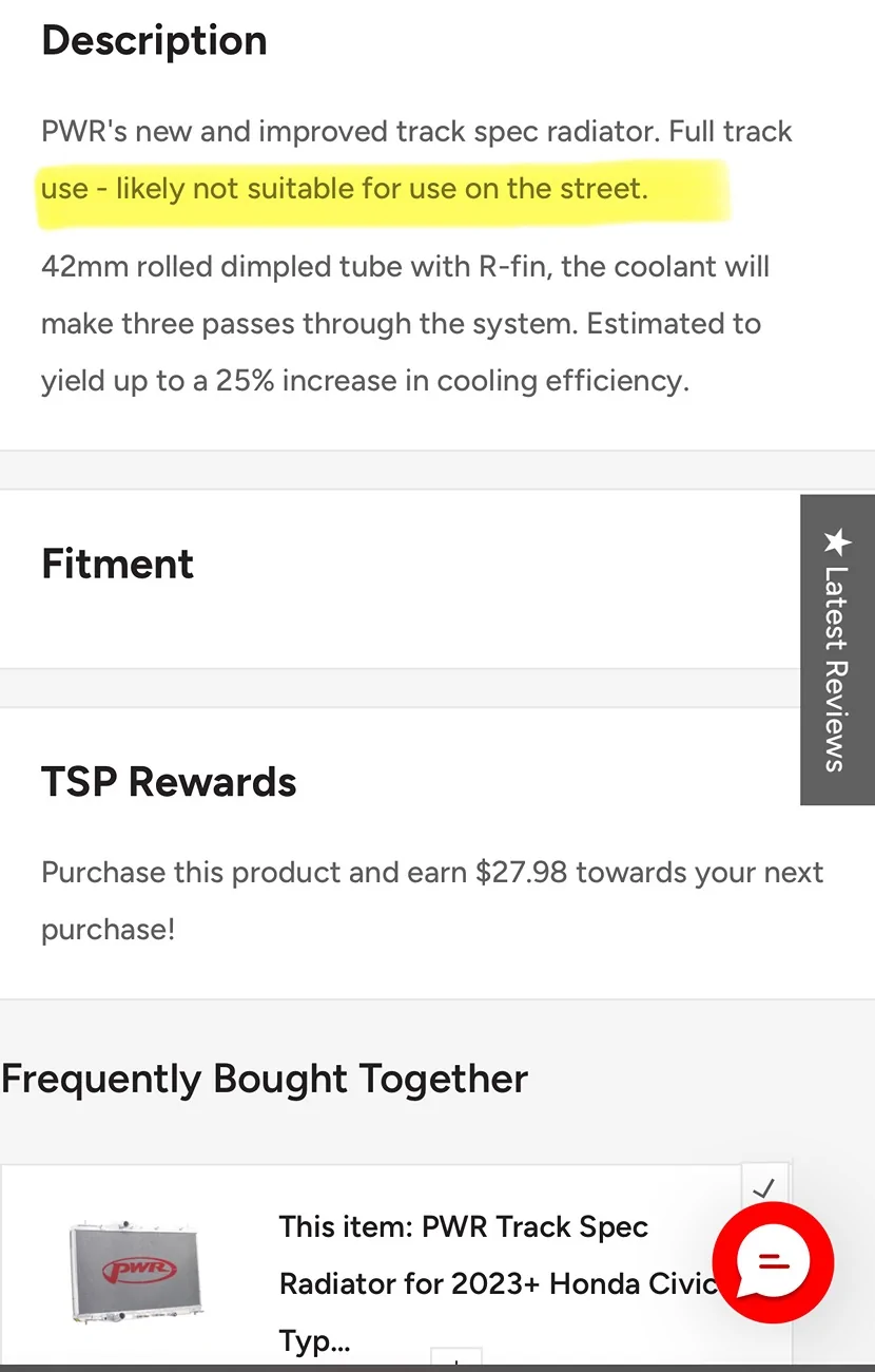

11th Gen Honda Civic Choosing a radiator for occasional track days, help IMG_2324
11th Gen Honda Civic Choosing a radiator for occasional track days, help IMG_2323

When I was shopping for a radiator I noticed the PWR and the CSF were the same dimensions and was told by someone that they’re the same cores, although I can’t confirm that.
Also there is nothing on PWRs product pages that state what exactly is different between their 3 radiators other then the one being triple pass. And when I called they couldn’t really explain a design difference either between the two on why one was better then the other.
I would have went PWR if the price was closer but I think I paid $675 shipped around Black Friday and PWR starts at $1100 plus tax.
