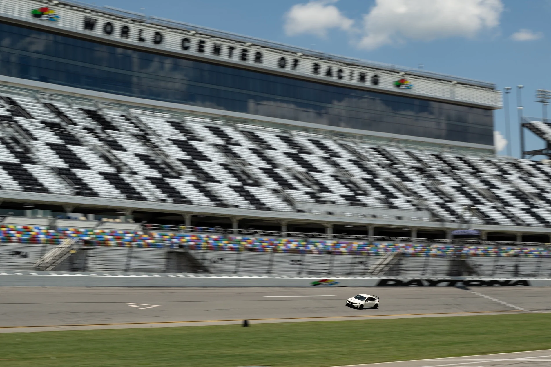

March: 88 degrees at Sebring and no overheating or cool down laps.
June: 91 degrees at Daytona and no overheating or cool down laps.
Since the CSF radiator I’ve only hit 231 degrees coolant temps a couple of times at the end of long straight aways near the end of sessions but literally by the time I brake at the end of the straight away and come out of that turn, coolant temps are back down to 214-216 degrees. Literally cools down in seconds.
I was hitting 140mph at Daytona on the long front stretch and holding there because of the wind on the banking. My hood was jumping so hard that I thought it was gonna hit my windshield. So if I was to of keep going WOT for higher speeds I COULD have possibly got deep into the 230s coolant temps. But it was 91 degrees out which I would never do again… it was miserably hot out and no shade.
