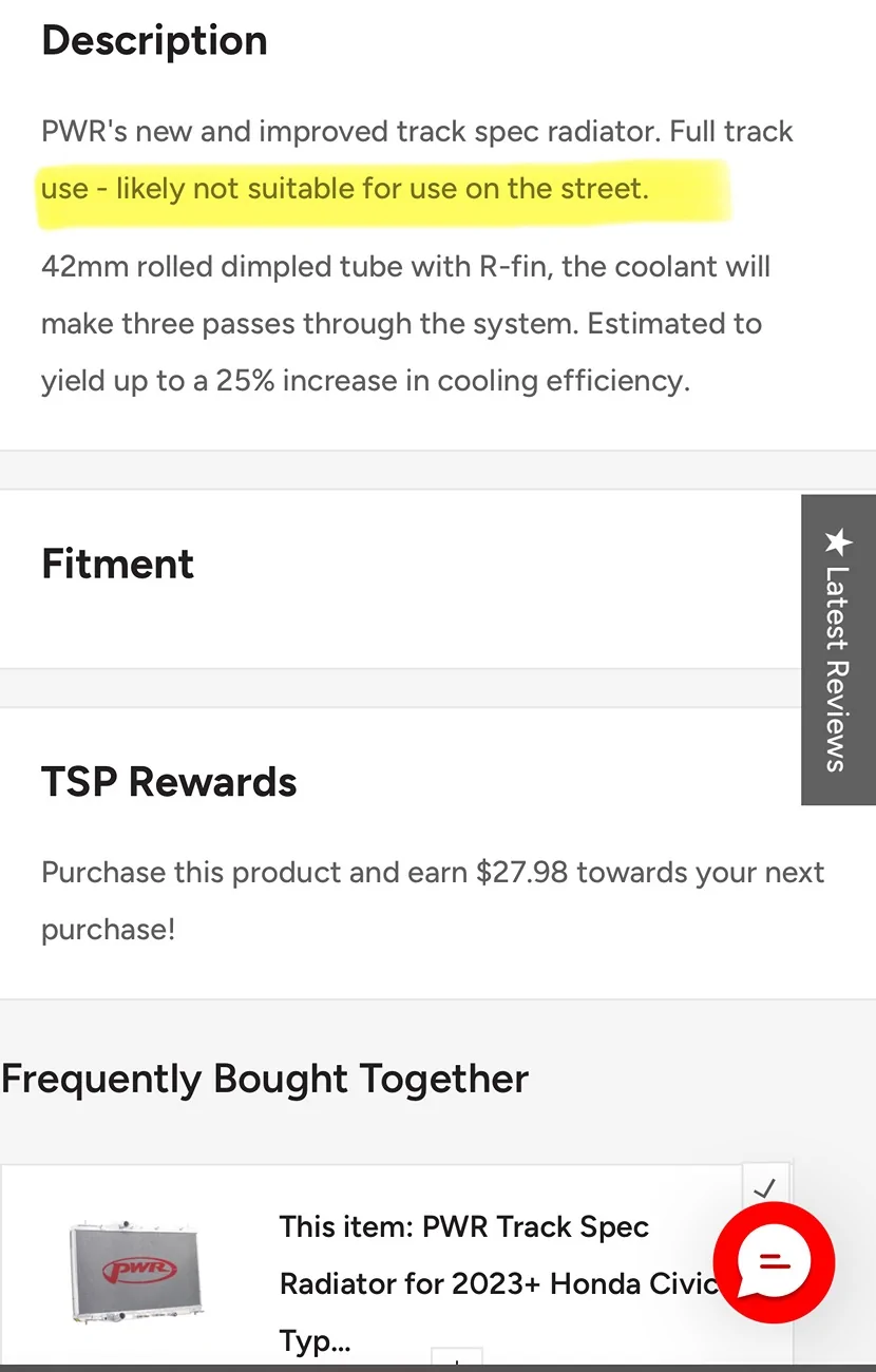

I was going to possibly do the PWR triple pass before I noticed they’re on back order and they specifically say not for daily driver. Lol

Can you explain why PWR says this then? Curious why it wouldn’t be good for a daily?

Maybe they put that statement the way catless downpipes always say “for race use only.” Kinda like a CYA.
My gues is that its a legal thing, because there is a variant where you can disconnect the line that takes it longer for the engine to reach operating temperature.
Also because where some customers live, it be actually be too good at cooling the car because of how cold the winter is. I know that was a problem with my Mustang when I lived in Massachusetts
