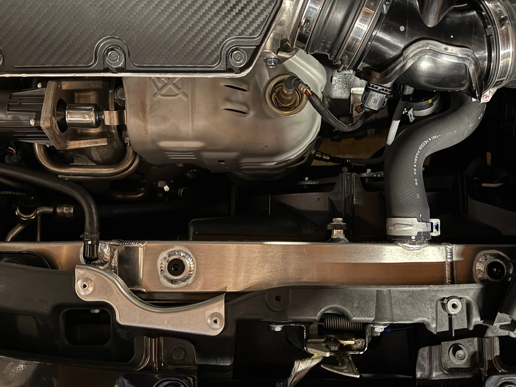

I just installed the pwr triple pass last week. So far seeing normal temps on street.
11th Gen Honda Civic Choosing a radiator for occasional track days, help IMG_0870
