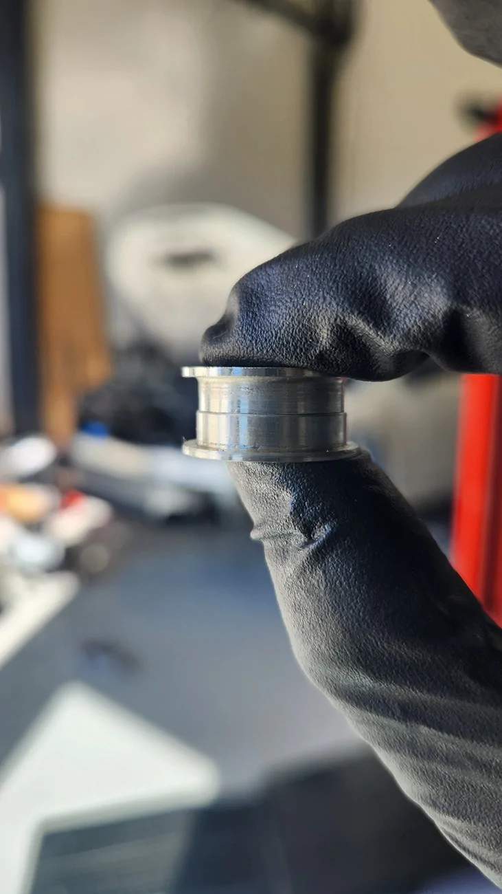

I designed my own collars as I don't like the design of the Spoon/other commercially available ones. The Spoon actually lower the subframe by 1-1.5mm which lowers the roll centers, and I'm convinced that's what people are feeling when they feel like their car is more comfortable/compliant after fitting rigid collars... either that or its placebo.
My collars simply centralise the main member of the subframe, and has no effect on the roll centre geometry. Once the subframe is centralised and torqued down, there is no movement in the subframe in relation to the monocoque. The OE design has a high friction disc/plate that bites the chassis once torqued down to eliminate any chance of movement/slippage, which the Spoon collars actually cover/disable once installed....

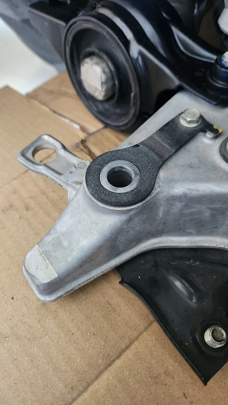

Interesting point, thank you for sharing this and your pics. I hadn't thought of this lowering of the RC; ideally a sleeve that keeps the bolts centered in the subframe bushings would be ideal? That way there is no interference with the high friction piece and no lowering of RC? I'm assuming thats what your collars are doing, and I say Bravo for executing your thoughts!
This high friction piece, is that the black piece in this pic? Held in place with a 10 or 12mm bolt, by the looks of it? Are they present on both front and rear subframes?
That's right, technically a snug fitting sleeve would do the job just as good, but you might lose it in the tunnel and would be difficult to extract without fully dropping the subframe. Not to mention the tunnel itself may not be perfectly round and cylindrical all the way through. Whereas a stepped washer can sit on top and if you needed to remove it you would just drop the subframe by the height of the washer which mine is 5mm tall.
Yup, you can see the almost skateboard deck looking finish on the black ring. This is on the front subframe only. Rear subframe does not have this feature.
