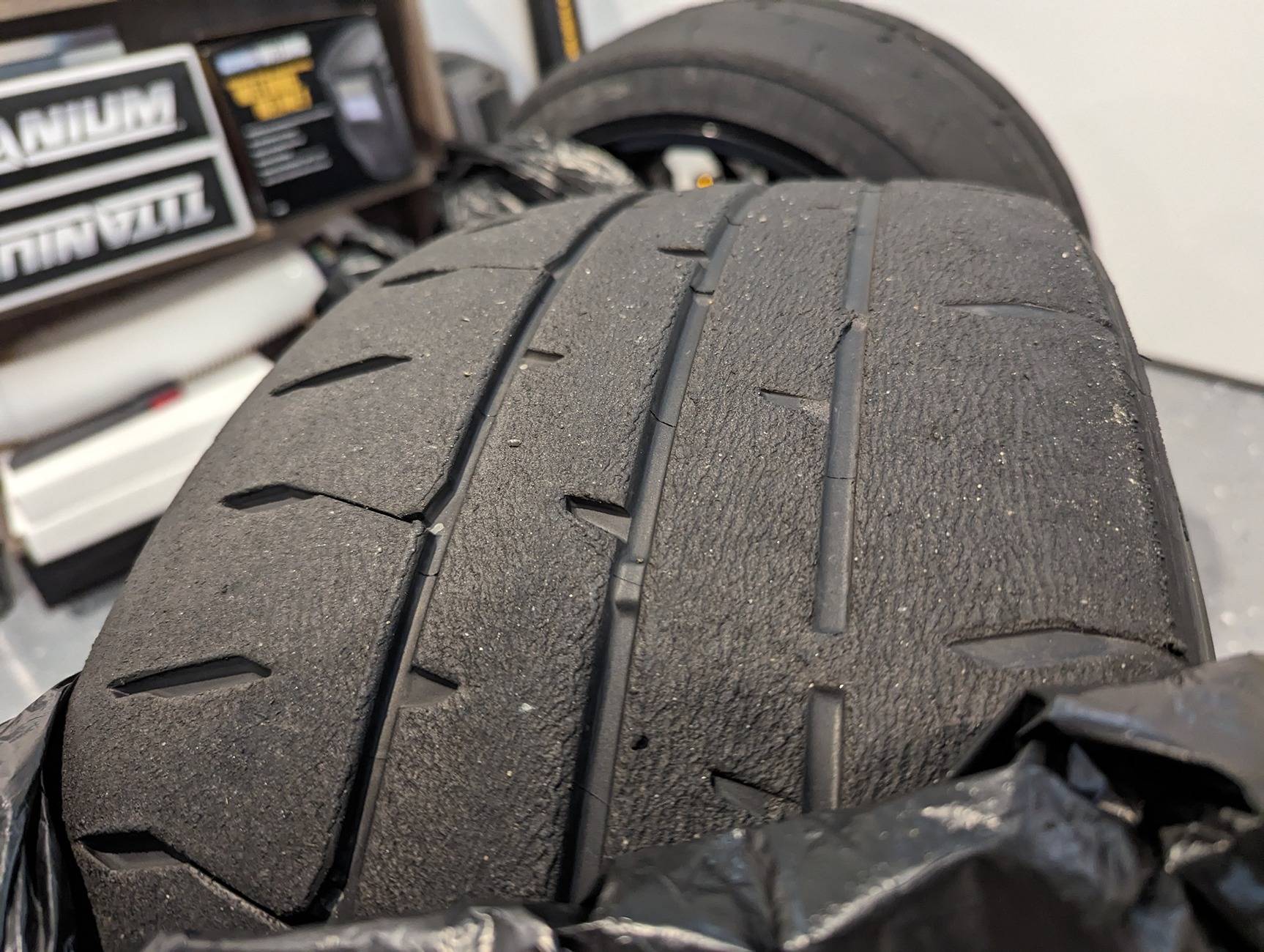

I'm running -2.5 degrees up front which clearly isn't enough. This was my front left tire after two track days. I will probably go to -3.0 degrees up front before my next track day.

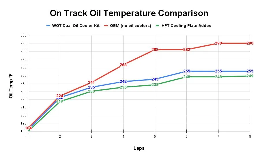

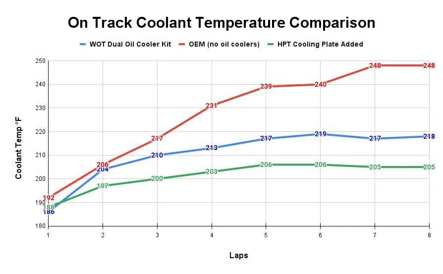

Massive results during track testing yesterday!
Dual oil cooler set up is working and working well. Still need to make a couple of small adjustments on fitment and finalize brackets, but given yesterday's results with the prototype, it showed it's ready to perform. Hopefully I can get these adjustments made in the next few weeks and officially put the kit up for sale. Best part is you can't even see that there's oil coolers on the car, OEM+. I'll share pictures when it's ready for sale.
Testing was done in 2 parts. Saturday ran with no oil coolers, no cooling plate, OEM radiator. Sunday I added the oil coolers and later the cooling plate. Ambient temps were low at 62°, but this testing was about relative performance, 1 for 1. Oil temps were measured using a physical sensor added into the oil pan (post engine and pre oil coolers so it's at its hottest). Coolant was measured using the OEM sensor in the head.
On Saturday to create a baseline, the car was run in OEM cooling form (OEM radiator, OEM under tray, no oil coolers) I got the car to the limit with a peak oil temp of 290° and coolant up to 249°. This was in a session where I had my last 5 laps averaging 1:55.66 on the new Buttonwillow "The Circuit".
Sunday with the oil coolers added, peak temps dropped to 255° for oil and 219° for coolant. In this session I had the last 5 average 1:55.21. A giant 35° improvement in post engine oil temps, and 30° in coolant temps!
When the cooling plate was added, peak temps dropped again with oil at 249° and coolant down to 206°. Last 5 laps averaging 1:54.41. Another drop of 6° for oil, and 13° for coolant!
I experienced zero aero issues with the cooling plate added, I achieved my highest top speeds and highest lateral Gs with it on the car, 128.4 mph and 1.46 G respectively.
