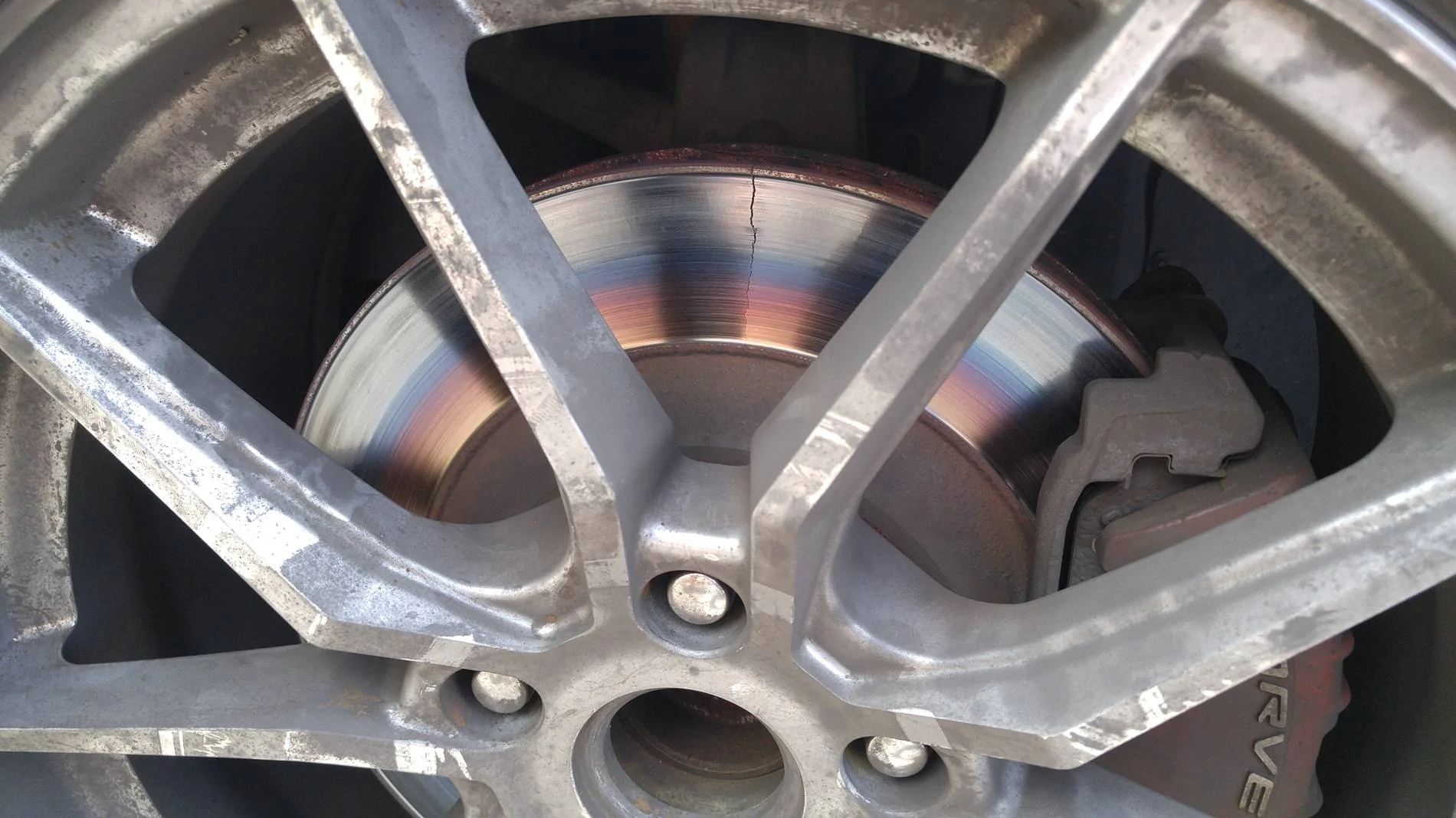

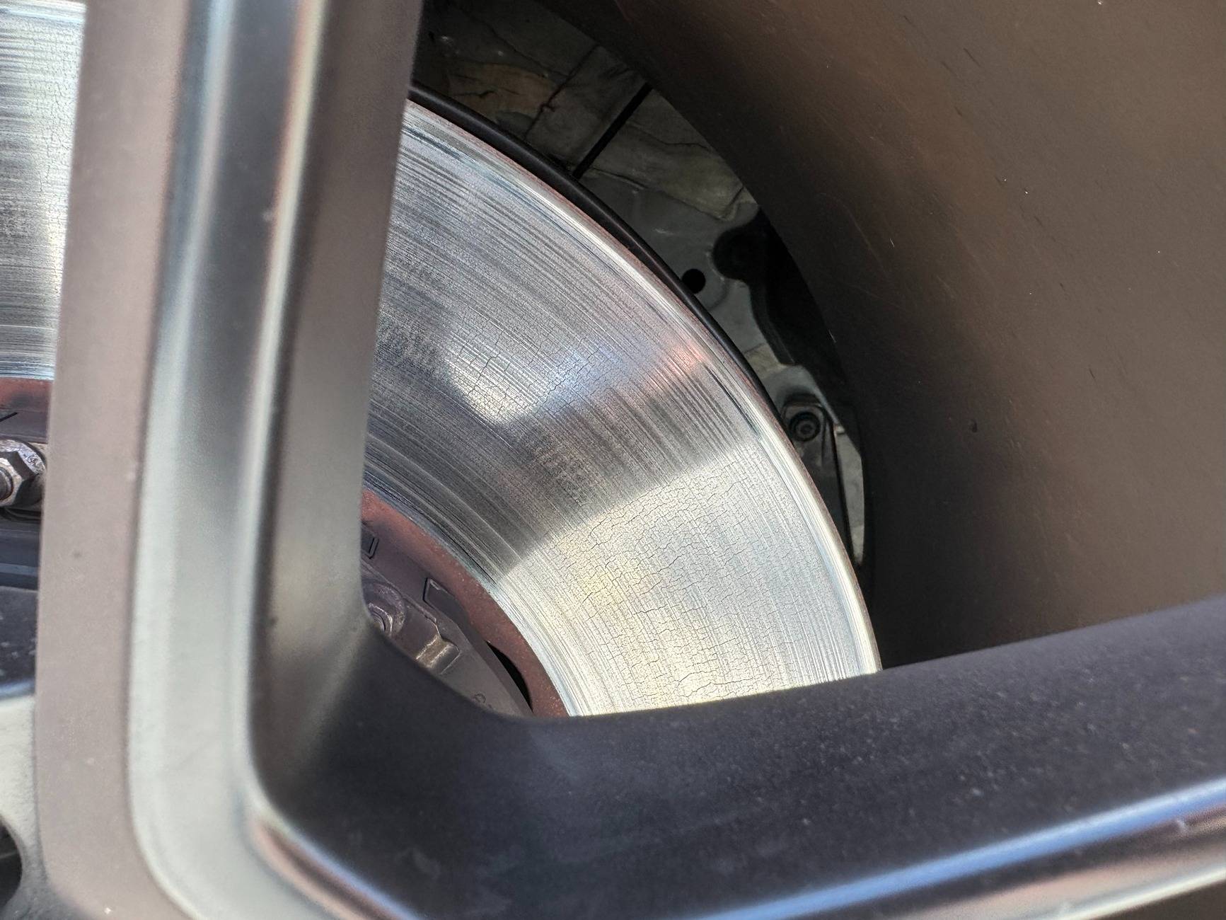

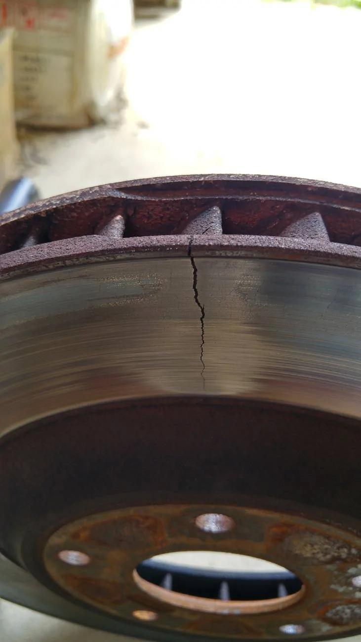

From my own experience that should be fine (I would recommend being prepared with spares though) - those micro cracks usually aren't a problem, just watch for the formation of real cracks - when it gets to this point, you've probably gone too far (reference pictures from my old C5Z06):
Thank you! I'm trying to hold off as much as I can so I can just buy the Paragon BBK. Unless I can find some cheap spares.

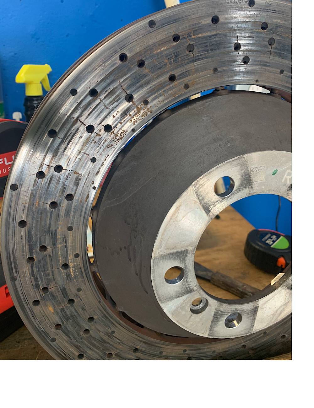

In my 35 years of driving on track, I’ve never had to replace a rotor due to minimum thickness. They always get cracks that I eventually get nervous about before they get that much wear. This one was drilled, but most were solid. They still crack with enough heat cycling.
Same, I've never once measured rotor thickness in 15yrs of doing various competitive car stuff lol.
