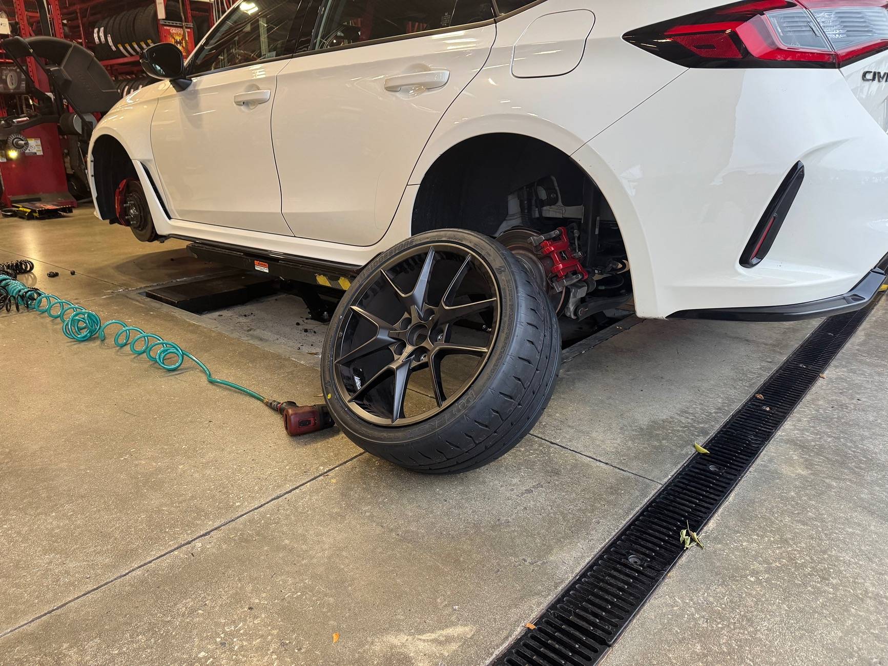

I'm trying to figure out if I actually need to remove the brake dust shield to install or can work around it. I've had a pair sitting in the box for a few months.
You don't need to remove it. Remove the 3 screws that hold it in place and rotate the dust shield to expose the lower ball joint.
Also ran across this gem when asking my Honda buddy to help find me a torque spec....
That's interesting. The FK8 manual says the lower ball joint is not a serviceable part, you have to replace the whole knuckle. For the FL5, they sell replacement lower ball joints and also published torque specs. I wonder if that notice was for the FK8...
