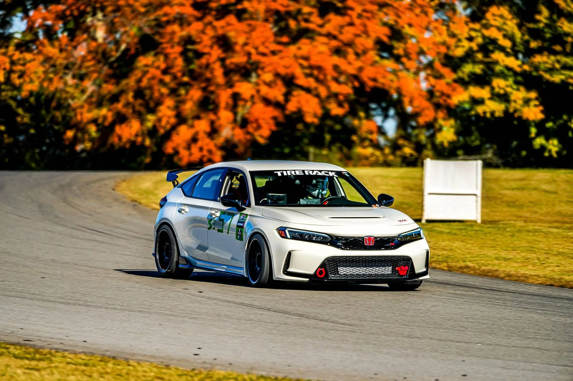

Yep - I run the 18x11 ET44 5x120 72.6mm bore ARC-8s - they aren't listed as an FL5 fitment (although Apex lists some of their forged ones in the same spec), but they work great (and they are a lot cheaper). Black Friday is approaching!

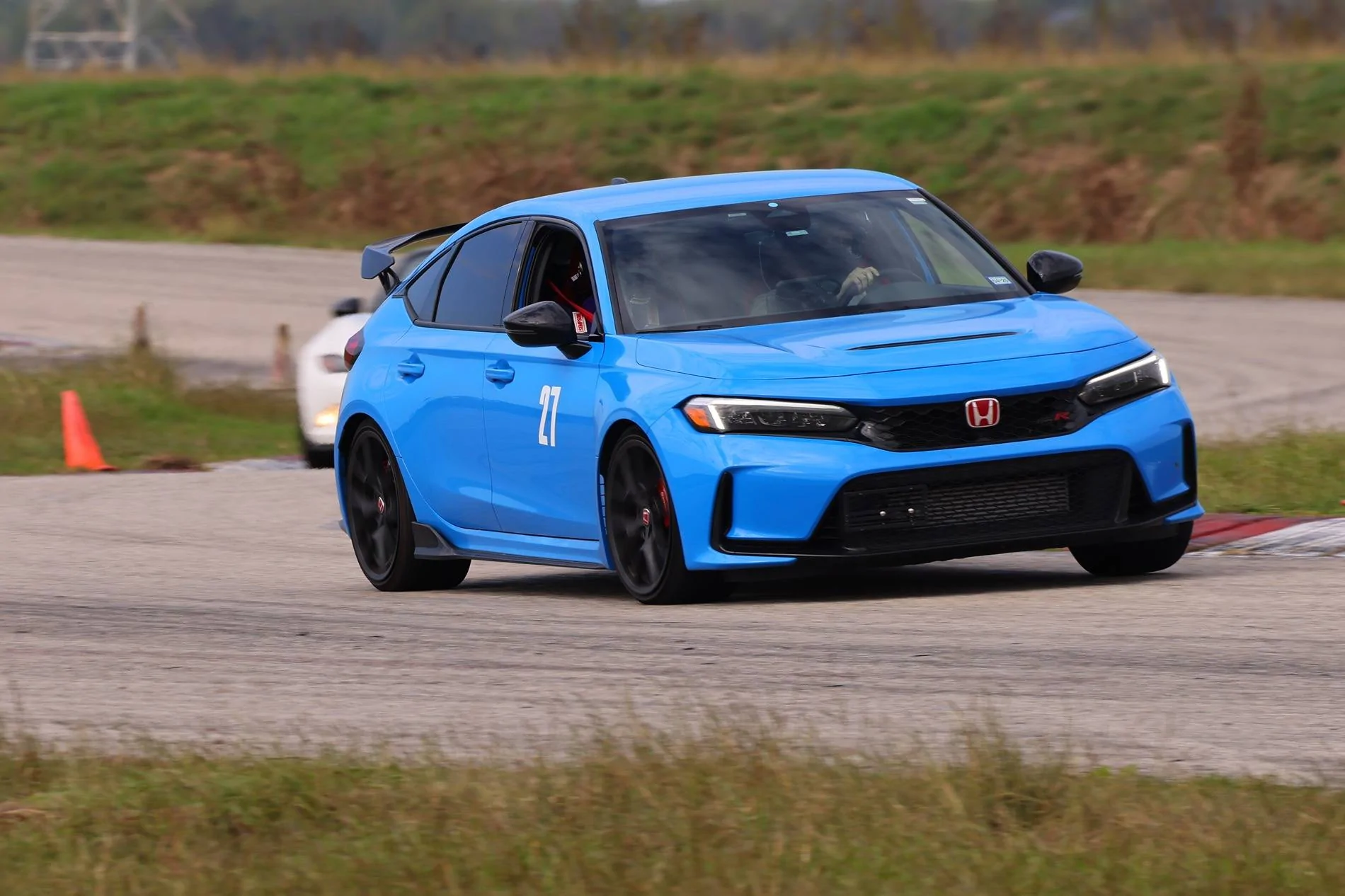

Recently installed whiteline adjustable ball joints (-2.6 front camber) and had some fun at MSR Houston & Harris Hill.

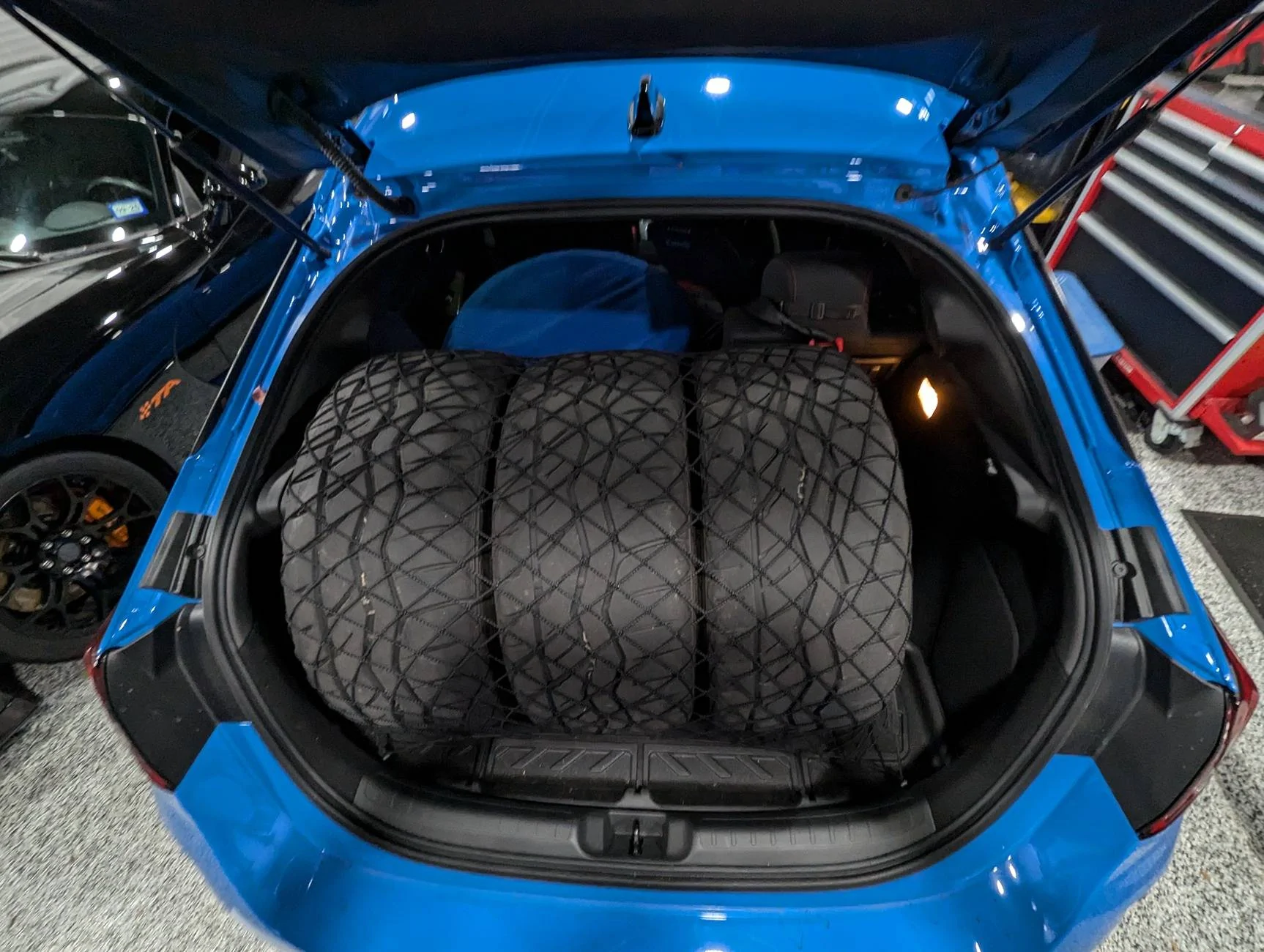

Also just realized you can fit a FULL set of wheels and a car seat in this car. Incredible.

I usually carry wheels differently but this looks to be a much neater way, will try it next time.
Oh yeah this car makes it such a pleasure to carry stuff to the track. I have carried 4 wheels, full size jack, ramps, the gigantic box full of my track shit, helmet bag, full backpack and there was still a ton of space left, front seat was empty. I basically just use the rear doors to make putting shit in the back easier

Nice! I am looking to do something similar for next season's autocross build. How much camber do you have so far?

I haven't had my car formally aligned but on my camber gauge I'm around -2.5° up front with the Ballade camber plates. The plates have more room to adjust but the lower spring perch on the factory shock has clearance issues with the chassis, however I still have more than just pulling the pins by probably around 0.5°.
